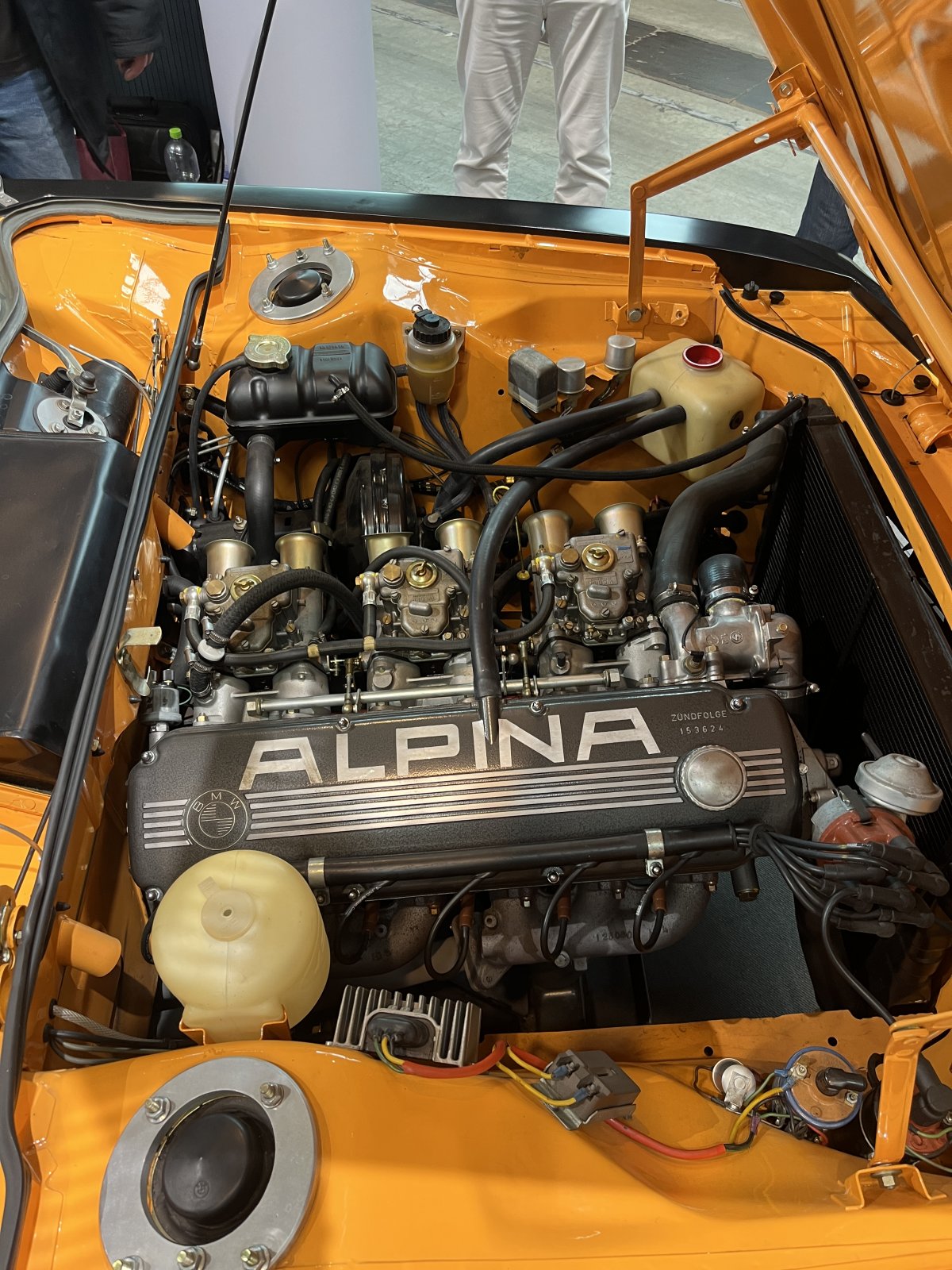

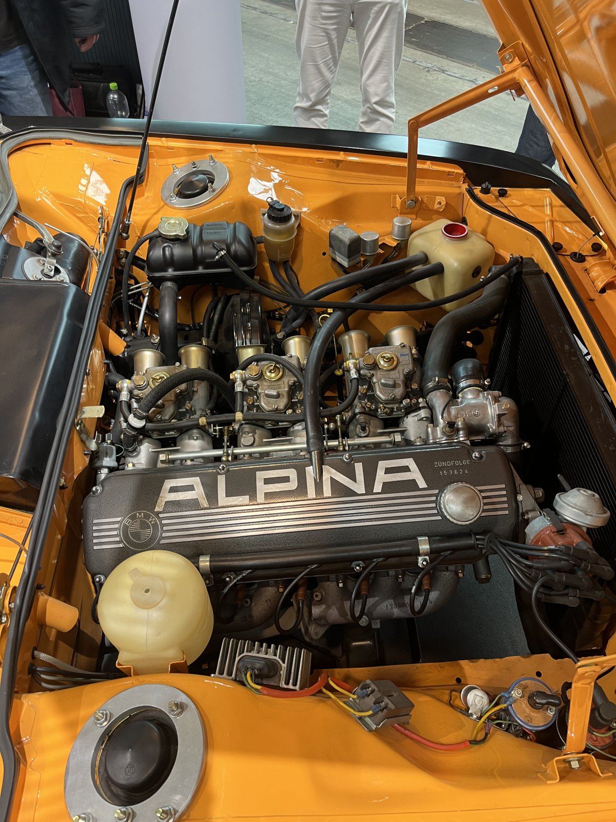

Can anyone identify this ignition module
eastsideM3
190
36
the east
Any leads if it still exists and is available? Thanks

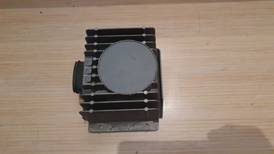

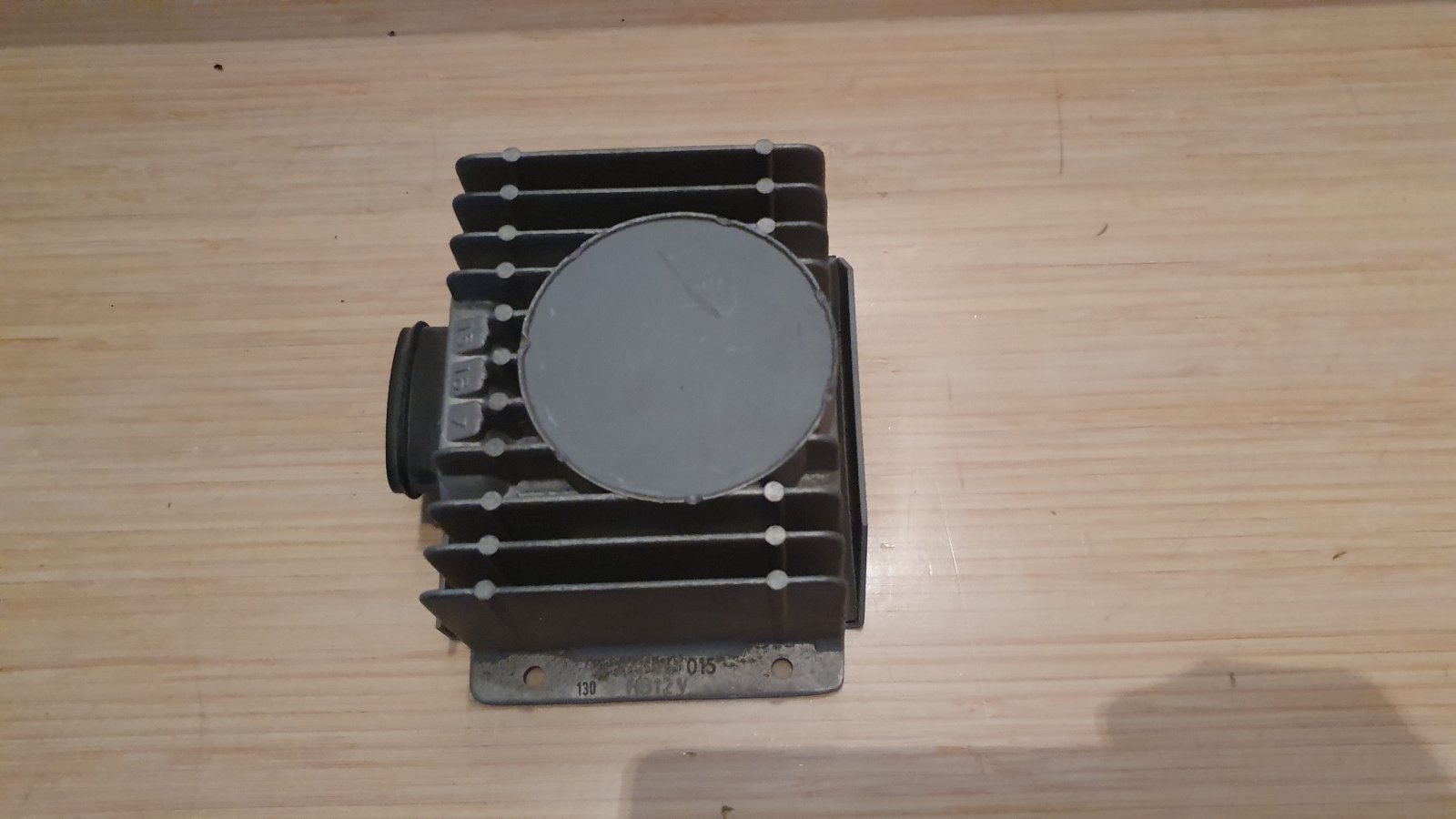

Yes,
Bosch 0 227 051 015
transistor ignition.
Got that also in the shelf, ready to install, just still search the rubber cover for wires.
But, why do you have 2 coils???
Breiti

Yes,
Bosch 0 227 051 015

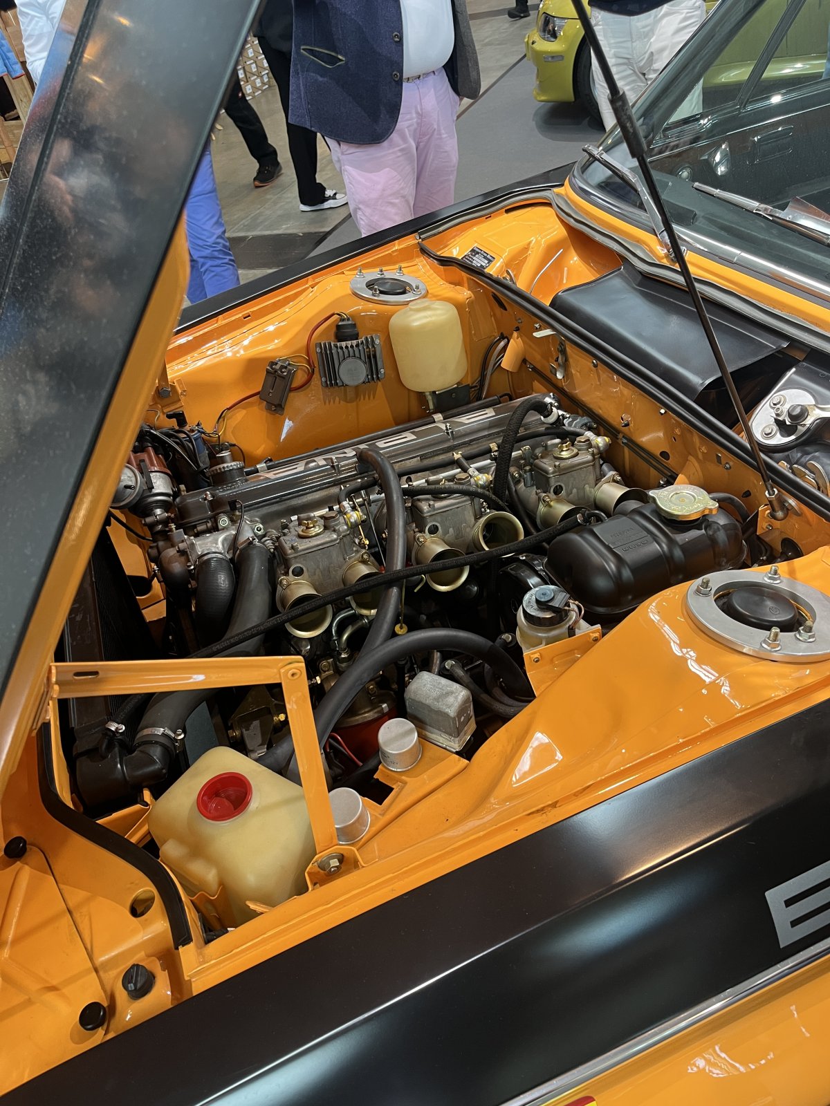

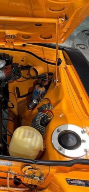

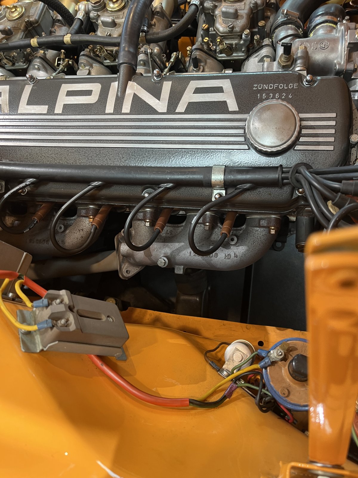

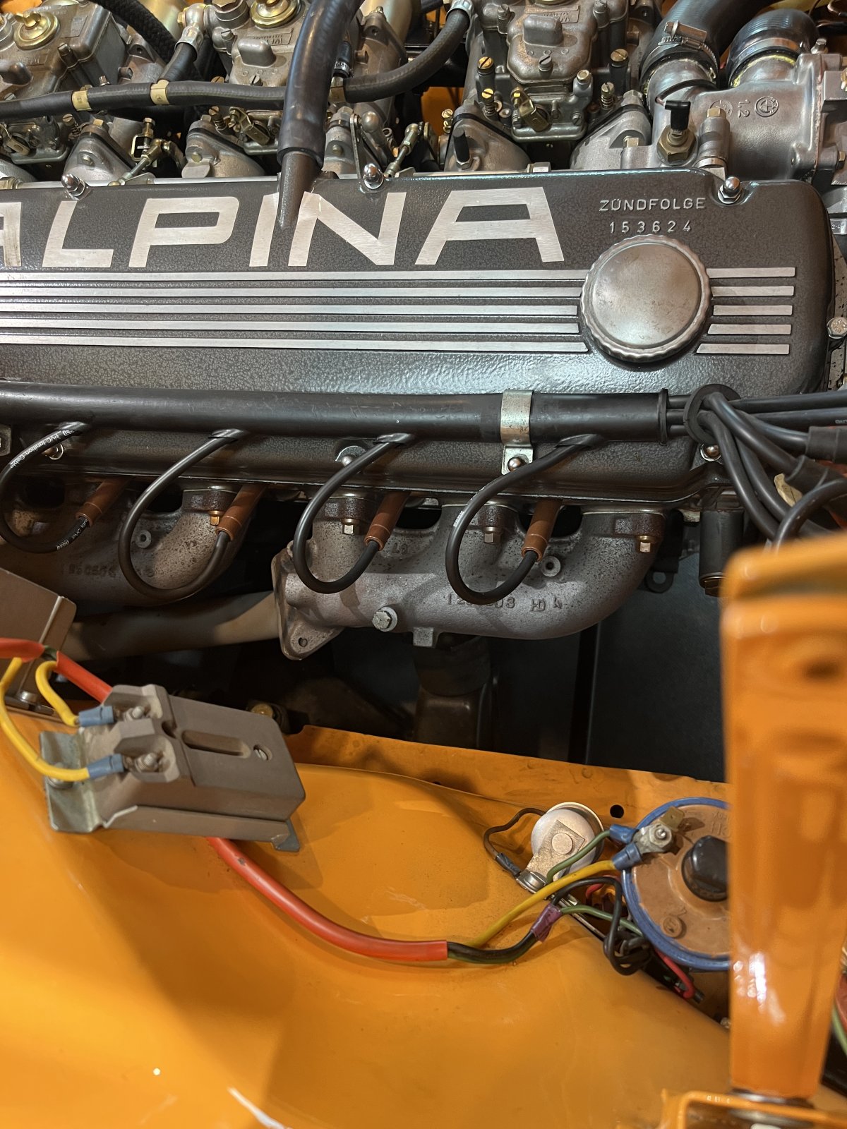

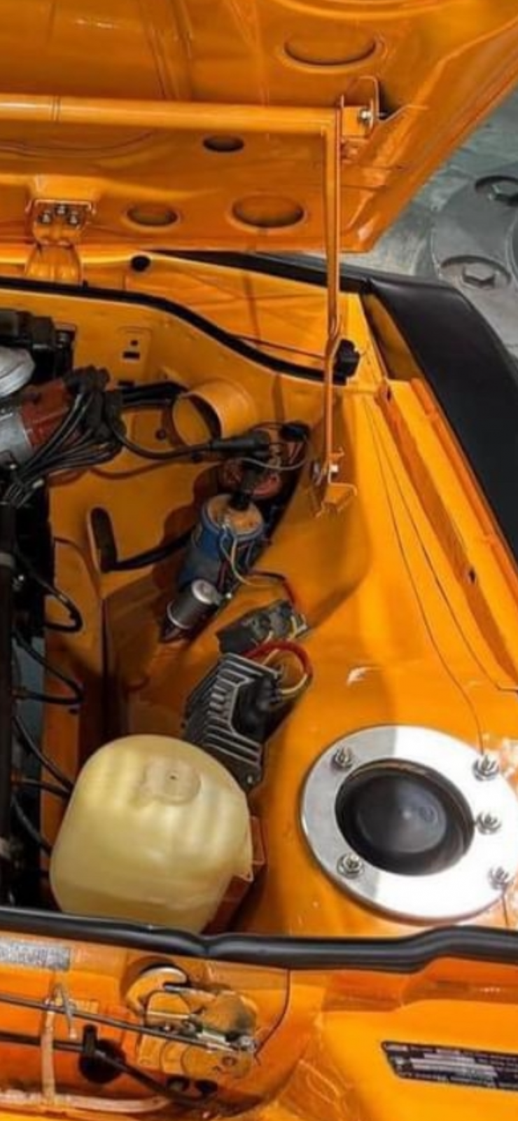

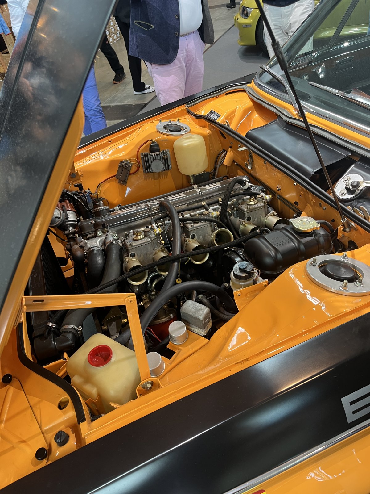

Good question trying to figure this out. It’s an early Alpina race car. Look at the secondary box which also has leads going to main box and coil it seems?
My guess is it’s a backup if one fails
