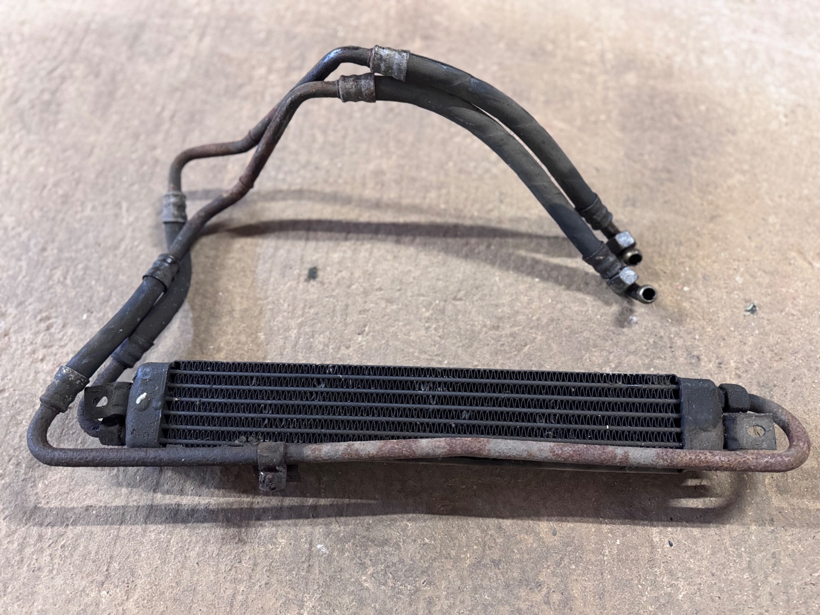

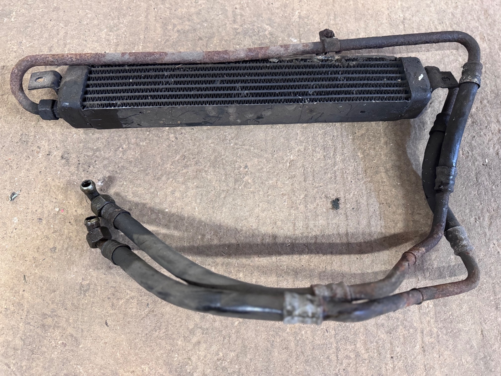

Can anyone identify this oil radiator / cooler?

It’s an original Behr unit and it has pressurised oil lines, is it part of the power steering setup?
Is it worth anything to anyone?

Purchased one recently from W&N and the landed cost from Germany was around $400. A used one like yours, I think, isn’t worth much. In the specs for this all 1980s 7 series E23s used these. It also upped the total oil needed for the engine to 7 quarts. An essential component to the 745 turbo setup.
Regards, Jon
The oil filter canister has a thermostat built in for this application and only opens when oil reaches a certain temp. Similar to external cooling for the 3.07 diffs. Running at very high and prolonged speeds or a turbo application makes this a very good idea.
Regards, Jon

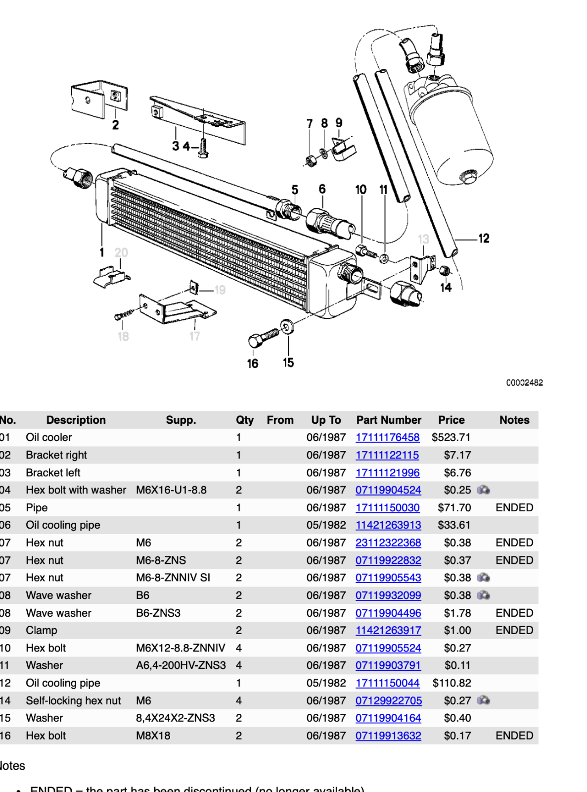

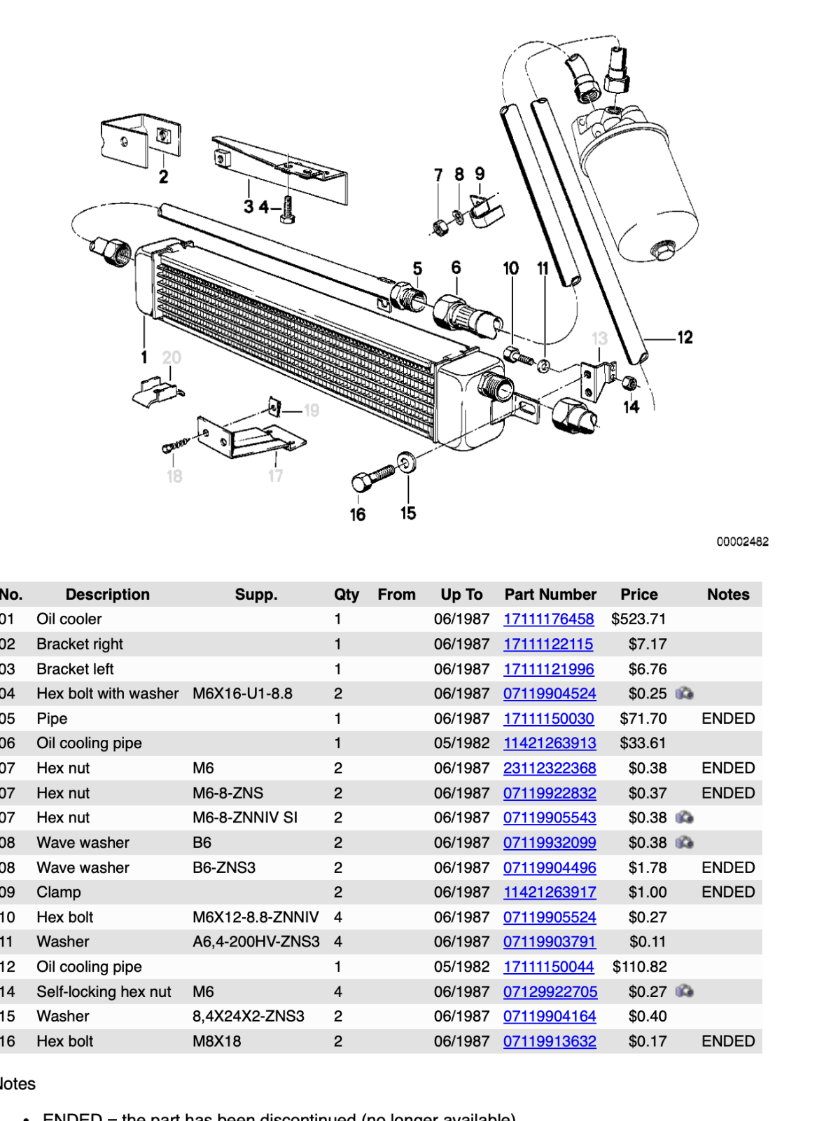

Looks similar to the oil cooler on my 1980 Euro 635...
