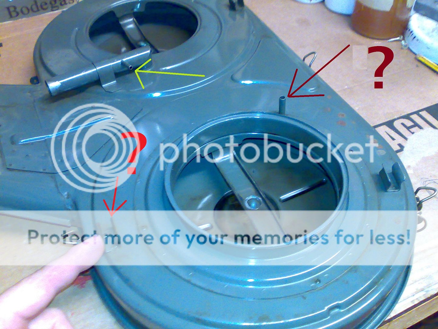

red arrows show on the right side of the picture an unexpected hose for rear carburetor, what for ? i do not have that hose in my original setup, should i cap it close ?

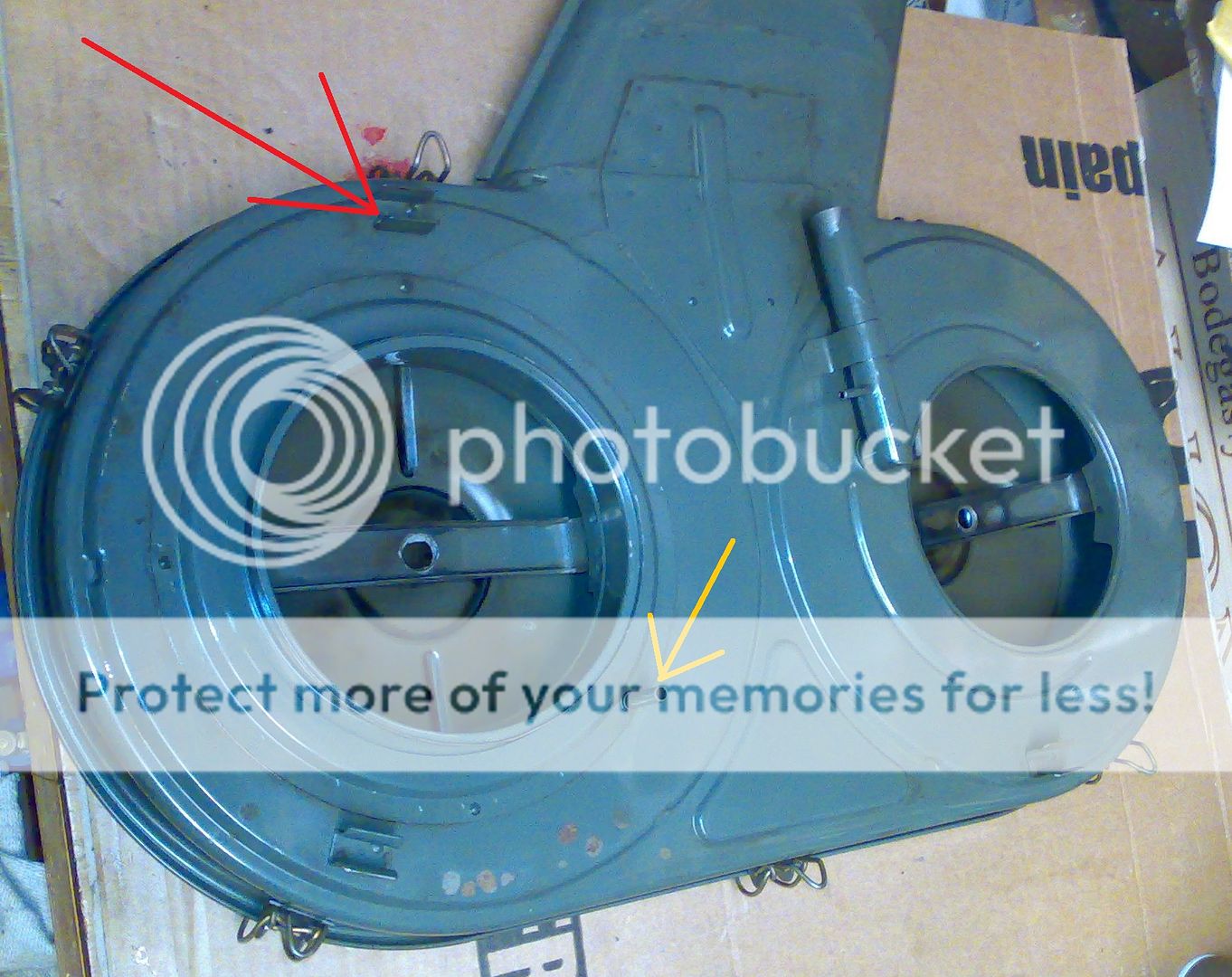

on the left side of the photo i can see an additional tube retainer, i would assume it is for the fuel rubber tube, right ?
i know the green arrowed hose, i have that one too

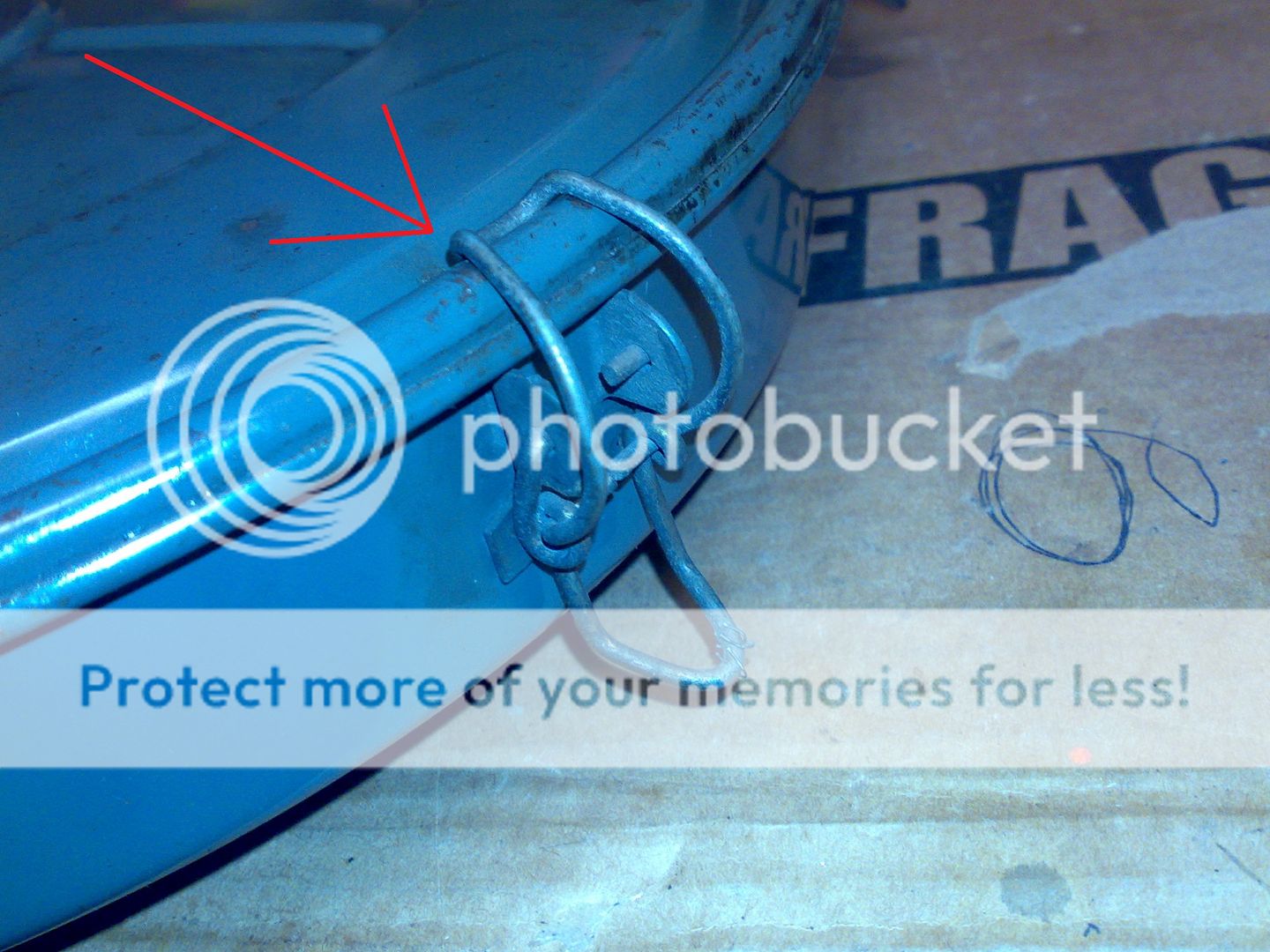

this clamp is unusual to my eye, i have the other type that consist of a curved plate, is this an earlier / older type ?

Looks just like my air filter housing for my 74 CS (US model) including the clamps.
I don't have the vertical tube though on the right, in your 2nd picture. Not sure what that one's for?
The tube retainer seems to coincide on mine with the vacuum line running to the distributor.

as to the tube retainer, let me say that in my humble opinión it is difficult to think about the vacuum line, as the retainer shown in the pic is in front of the rear carb in fact, and the vacuum hose is usually coming from the front carb,...right ?
i tend to think that that tube retainer is in the route of the fuel tube towards the fuel pump, only doubt for this thinking is that the retainer seems to be too narrow for a 13mm rubber fuel tube !!??

DQ, I believe the vertical tube is for a line coming from the charcoal canister below the battery tray.

that tube has negative pressure, so suction from the carbs,....
At least on US models the gas tank is vented to a plastic tank in the trunk above the passenger's side rear wheel. A plastic tube then goes from there, through the interior, out the passenger side firewall, across to the driver side, then on to a charcoal canister under the battery tray. Another tube then goes from the cannister to the air cleaner. It is used to burn off gas accumulated gas tank vapors from the tank instead of venting to the atmosphere. When this line cracks either in the trunk or interior it is a cause of fuel odor.
I am not sure why the vacuum tube attaching to the oil vent tube is necessary, this would suck gunk directly into the rear carb. I disconnected all of this stuff.
wooooooow !
i guess that such a thing is not incorporated to Euro cars, exception made of swiss cars (they had strong emissions requirements too)
well essentially i will cap it and forget

Regarding the charcoal canister, we had those in some US cars, Ford/Chrysler, etc. I swear they were made out of re-purposed "Chock-full-of-nuts" coffee cans, anyway, I think the blue line from the trunk went to the charcoal canister then back to the air filter, but mine is a 1970 and I think it may have gone directly from the blue line to the air cleaner, and in post-70 cars they added the coffee can-just a guess.
You are right. My 70 Coupe has no charcoal canister. The fuel tank evaporation line goes directly from the reservoir in the trunk to the air filter housing fitting.
I got into an argument with a smog inspector about that charcoal canister before my car became exempt from emissions testing. He insisted my car originally came with it. He was wrong and finally gave in to my strong insistence that it did not come from the factory with one.
Our 70 2800 also has no canister, it goes straight to the carb. The clamps with a solid band are on all early BMWs. The wire clamp is available from BMW, the early one is not. My 69 2002 and NK sedan as well as the 2800 have solid bands. The 73 coupe has wire style.
