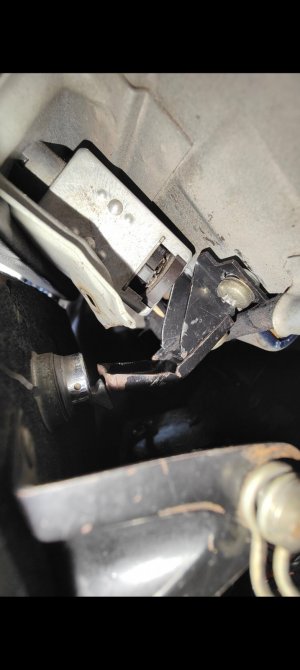

This is what is going on inside. The door latch attaches to this so pushing the outside in and if possble to the side you can "unhook" it.

I do not have the car here but I recall a large kick panel I removed whenever I needed to work on wiring, relays, etc. It should be adjacent to the flap door to the right. I am speculating that as there is no physical barrier you could access the latch from the southeast direction...

The "door" that you need to open is all the way to the left (as you sit in the driver's seat) and has a chrome push button on it. The latch isn't exactly a precision mechanism - they often take some jiggling to open. The advice to "push upward, push left, push right, ..." is good.
The problem with this door is that you are pushing it in when pushing the silver release button, to get the door to drop out. I find this a PIA. I take a plastic pry like one to remove door cards and use it to pry the door outwards as you are pushing the silver release button and door inwards.
