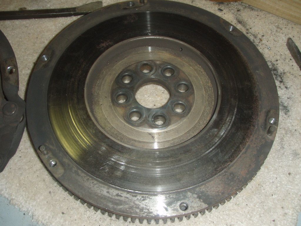

I've got a '72 CSi that was imported from Italy. The odometer shows about 67,000 km. In general, it looks pretty good, minor rust issues I had fixed, a little thread bare in the interior but not bad for a 40 year old car.
When I changed the 4 speed out for a five speed, the clutch looked beat, the pressure plate was toast, totally torn up. Replaced it with one from a 635i.

The clutch shouldn't be beat at 67,000km, neither should the interior.Please Post some photos of your new baby. Sounds nice.
Fly wheel. Don't know if you can see the grooves, pretty deep.

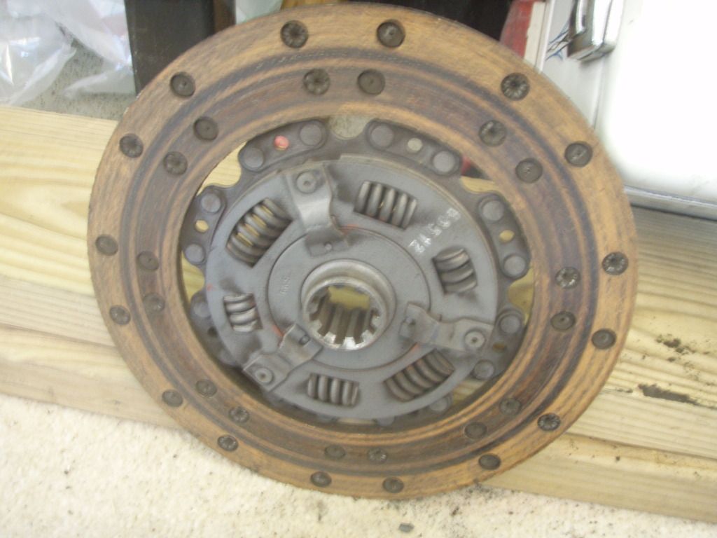

Friction disk. It actually looks pretty good, wonder if it has been changed?
sometimes those friction plates have a manufacturer or date code stamp to help with the age
Stupid question, does the engine number match the chassis. If not, then it has 267,000 km.
