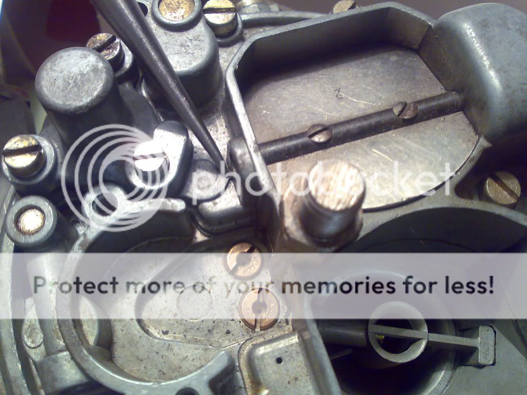

Air correction sizes
DQ,
Can you read the numbers on the brass air jets and confirm pls. I think I see 100 on the primary and 120 on the secondary?
You're photo has me thinking. Check against the specs for the carb in the manual.

air correction jet
In DQ's picture, I would usually see 80 on the primary and 4or6n on the secondary. Auto equipped cars had 100 on the primary for 2800s. But that's about it.
The same size jets were used on the Mercedes Zeniths.
I tried the 100 from another set I had, didn't help me.
Tell me what you're symtoms are or what more you want from the carb.

DQ,
you are right, it is 100 and 120, but those are not my car mounted carbs, but a spare set
i will check the other this weekend
what should i expect to see ?
