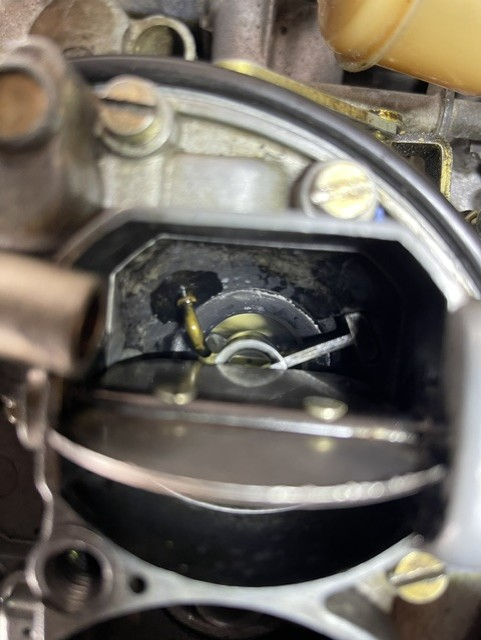

I finally got done with doing a semi-rebuild on my carbs - I replaced all the choke and secondary membranes which had tears, took off the top portion and removed and cleaned the jets on top and replaced one of the accelerator pump skirts and put new top gaskets on. I did not go all the way down to the float bowl as after that it appeared they were functioning but did blow everything out. choke/high idle seems to function OK. While trying to balance them I kept having issues with the back carb and upon looking found the top nozzle appears to be leaking and continues leaking after shutoff. I took a pic, you can see it appears to leak from the base but a video would show the drip from the nozzle as well. Advice on how to address appreciated. If it helps, I can hear air being drawn in as well when I open the throttle, I thought I had fixed this by fixing a sticking secondary. This carb has been giving me fits in general, after fixing a bunch of other issues hoping this is the last one.

I should have said "accelerator pump nozzle" btw. But I hear you, I started to do that but the gasket between the jet and fuel bowl layer is really stuck on, plus I was hoping to avoid draining coolant and all that, but might have to bite the bullet. I wonder if the replacement accelerator pump skirt is causing this particular issue, I know they are not as thick as the originals. I've had the car 10 years and lord knows when the last time someone went through these.

I disassembled everything, blew out all passages, checked the accelerator pump and reassembled. Still hear air and get lean backfire. I found something must have dislodged and plugged the accelerator pump. I took it apart again, blew air through both ways until that freed up and thought that was it, pump is working. But it didn't change much. I checked the fuel idle solenoid, both make the same ticking noise when reconnected. I am going to take it apart one more time and swap gaskets between stages in case there's a leak there but I'm running out of options to get this working. car will idle although a bit rough, I got the vacuum even between the two but on any acceleration I can hear air hissing in the back carb and I'll often get a backfire. Any tips appreciated before I throw in the towel. I did try spraying around come carb cleaner to check for leaks but didn't get any change.

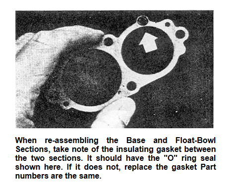

Make sure that your gaskets match up exactly, there have been some that interfere with the float The separate sections do tend to warp slightly and all surfaces should be sanded down on a flat hard surface with at least 320 paper wet In the lower section, on the base gasket, there is an o ring,make sure that it is there and protrudes slightly above the gasket, this is where a lot of the vacuum comes from for the internal passage ways for the carb

Good advice, the float part I did check for free motion but have not re-started after installing the new gasket. I recall seeing a pic of that o-ring somewhere so will make sure it's there. I only took the jets out to clean and replace one at a time so hopefully I did not miss anything.
OK, don't want to speak too soon but I may have solved it. Earlier in the week I took the top two layers back off (that's all I've ever taken off, I did not want to disturb more than I needed to.) I blew everything out again and replaced the gasket over the float bowl secntion - why did I not do that the first time? Because the nice old guy on youtube who does this on mercedes said you can usually reuse them, and mine was really stuck on there. So I took 45 minutes to carefully scrape that off, I could see a lot of moisture where fuel was getting drawn where it shouldn't. I started it tonite and seems to be much better - no big air suck and the carbs sound the same, no backfire on quick blips. I only had a few minutes to check it out and do a quick balance so I'll try to tune it tomorrow and see how it goes. Cross fingers.
