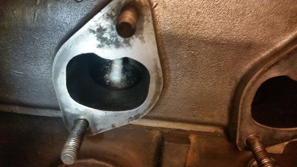

I recently pulled off the Weber DGAVs and intake manifolds to make way for a set of three Weber DCOEs. When I look into the head, I see a fair bit of carbon buildup on the number three intake valve. The other valves are not that pretty either.
This is what has me concerned (Number 3):
One of the first things I did when I got my 72 3.0 CS was to adjust the valves. In the process of doing this, I found that one of the bolts was stripped and was not holding the eccentric in place properly. I replaced the bold and nut and properly adjusted the valve clearance. The stripped bolt was on the number 3 valve.
Is this something that can this be addressed with Techron or LiquiMoly Ventil Sauber, or is more extensive work required?
Here are the valves in order:

You could do a compression test to compare cylinders. A leaky valve would show itself. If the compression is ok then maybe a worn valve stem guide or seal allowing oil to drip through to the back side of the valve. With the head off I have been able to wiggle open valves (i.e. indicating a worn guide). You might be able to reach in and grab the stem with your fingers to see if you can move it side to side.
Oil coming in through the intake via the valve cover breather (not sure how that is connected to the DGAV's).
Or are you just trying to clean up the black stuff?
I had carbon buildup so I bought a can of BG ISC Induction System Cleaner and put it into a spray bottle and applied it directly to the valve and let it soak then hit it with some bronze gun cleaner brushes on a rod then repeated untl clean. You can put each cylinder at TDC to keep crap from going into the cylinder then separately clean the end of the valve when open.
The stuff is nasty so use in a well ventilated area with gloves but it dissolves the carbon when other stuff did not.

I did a compression test a year ago and obtained the following: 182.5, 180, 178.5, 175, 180, 182.5. Those are straight readings (average of two) at 50 degrees, dry sunny day, no elevation correction (I live roughly 400' above sea level). I have not driven the car much since then.
These results seem quite good, and this is a reason I would rather not pull the head. (The other reason being I want to drive my car!)

Actually those valves look very normal.
You are making way too much out of a little carbon on the back of the valve.
If you want to see a really badly carbon coated valve do a Google search and hit the photos section.
What you don't want is so much carbon that the valve won't close properly.
I have seen that.
Your compression numbers tell me you have a healthy head and it doesn't have leaking valves.
A leak down test would totally confirm that.
