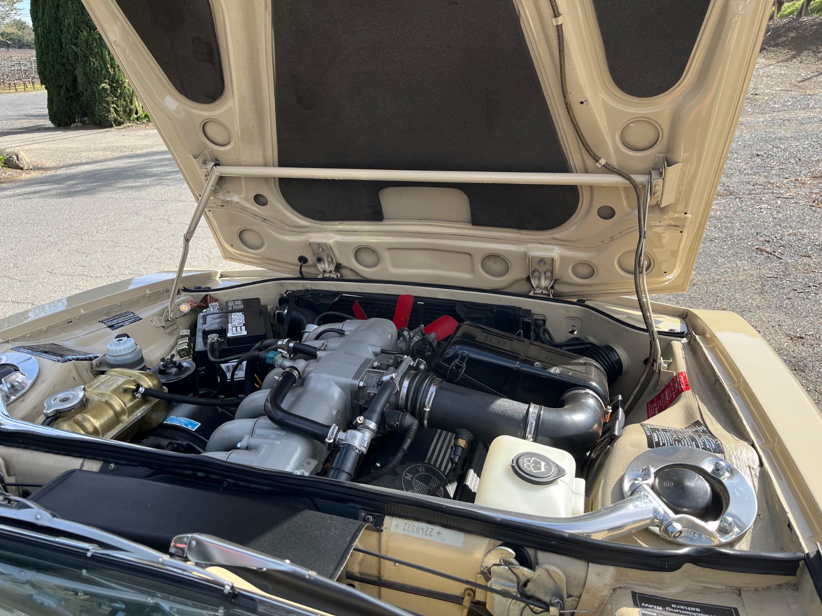

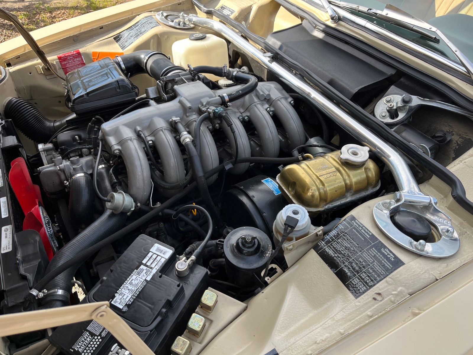

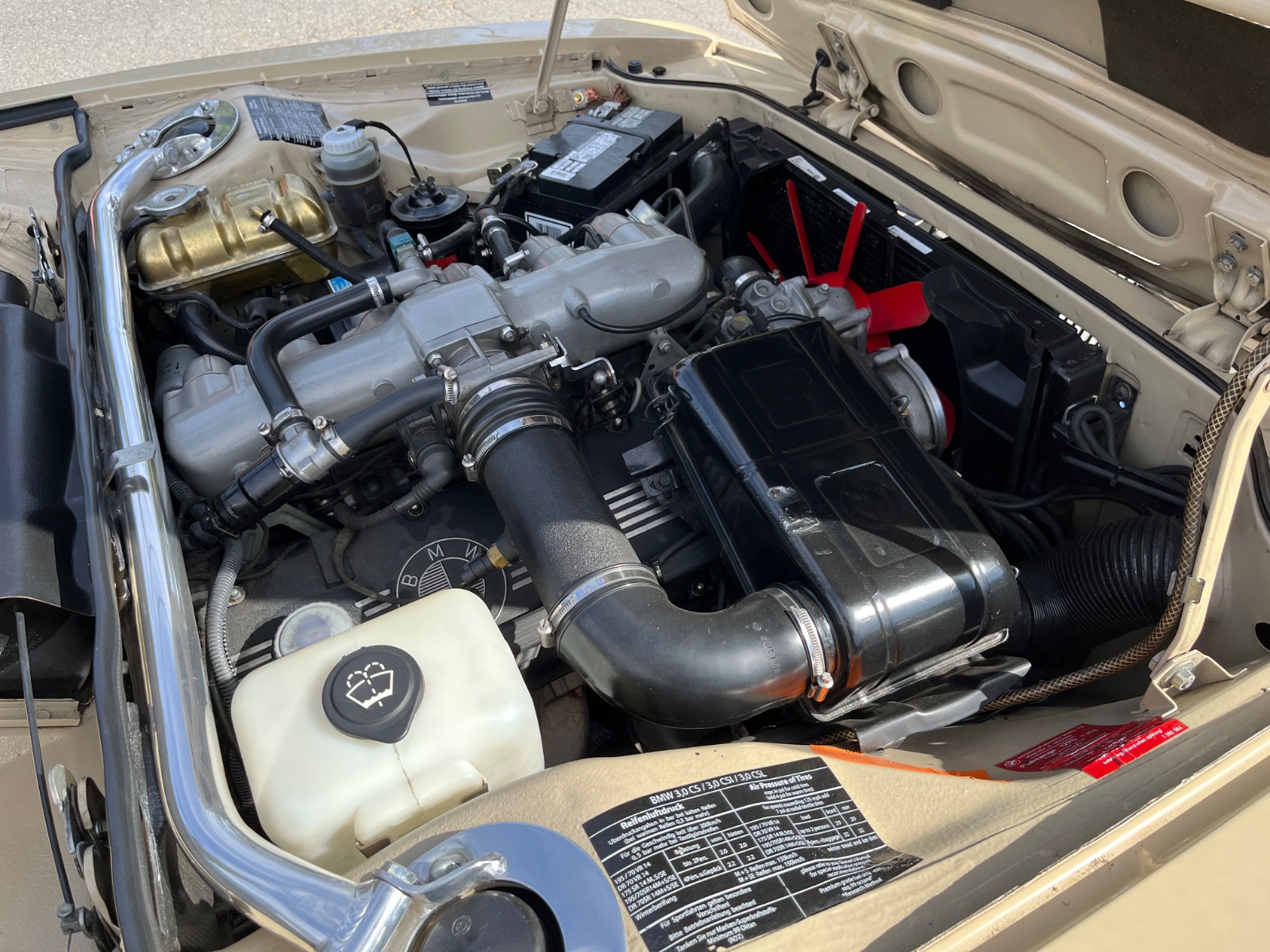

I have been involved with and or done 3 Coupe carb to FI. There are several experts on the Forum that can do the conversion for you, consult, sell you parts or you can do it yourself depending on your level of mechanical knowledge. You could probably first do a search on the Forum to get yourself acquainted with the process. There are several detailed posts on the subject and I think your first and smartest move. You have a number of sources on the East Coast like VSR and several members that will probably pitch in. Here are 3 shots of what they look like. My Sahara Coupe is MegaSquirt, wasted spark, 284 Shrick cam in a 1984 635 CSi Euro 10:1 CR engine and it is very driver friendly. Always starts. My Turkis Coupe uses an Emtron ECU and the Link ECU also is a good choice.

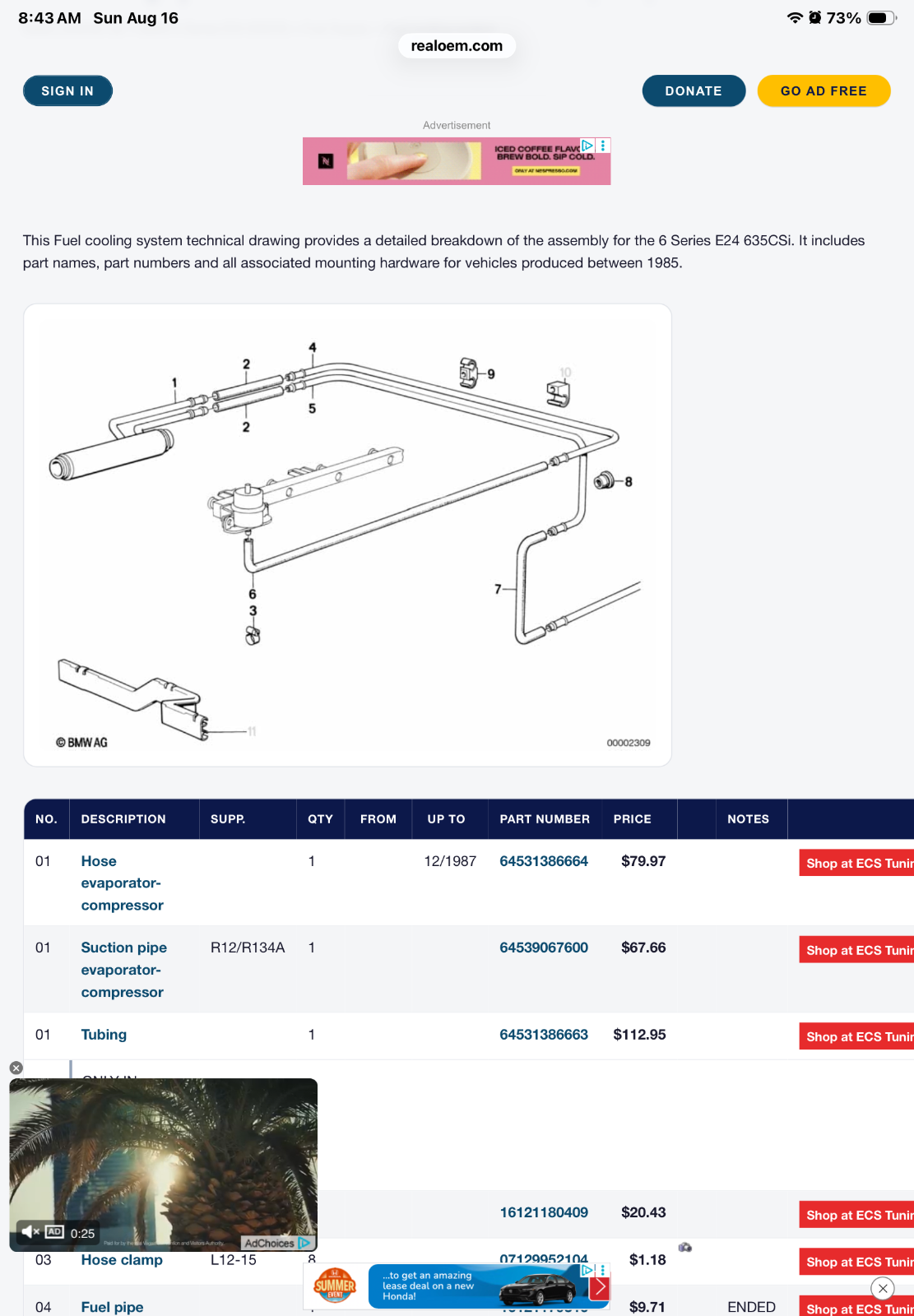

Let’s not forget that the 1985 e24 fuel injected car actually ran the gas through fuel pipes located in the airbox area and then into the AC lines to fix the vapor lock issue…
FI is Not a guaranteed fix for vapor lock….
