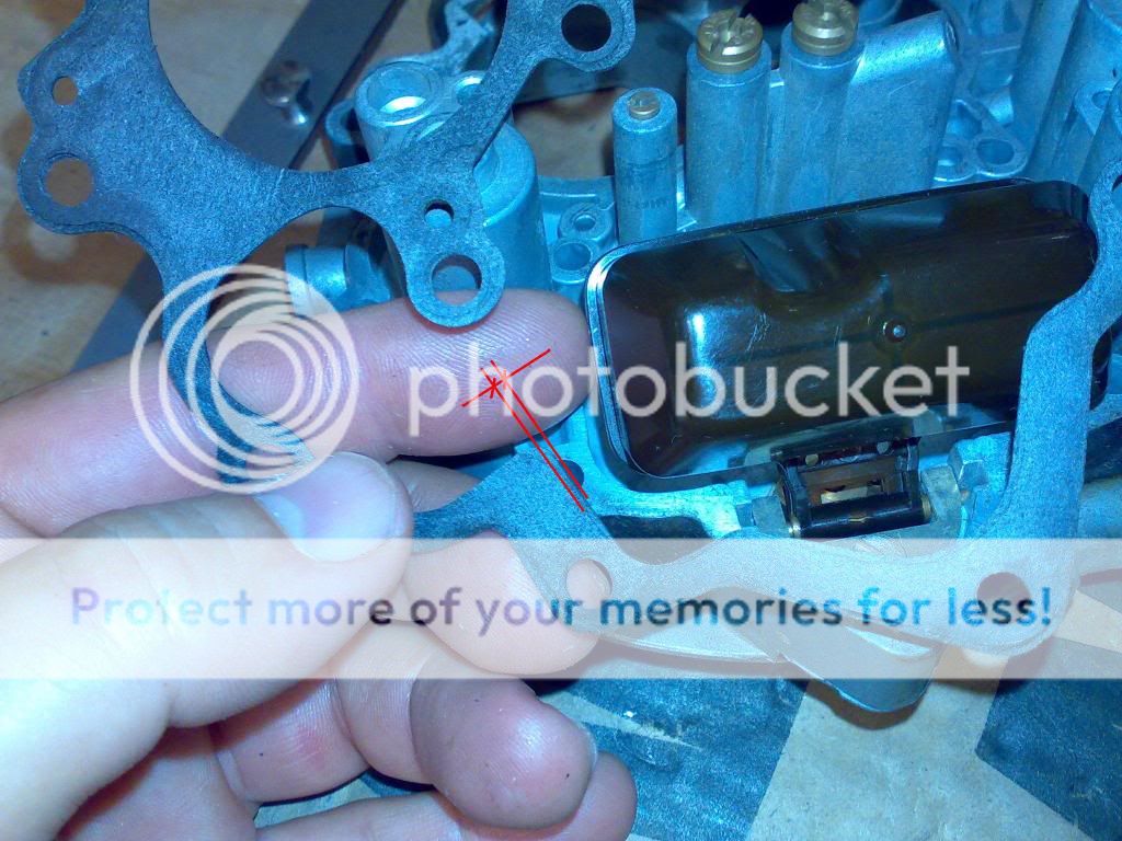

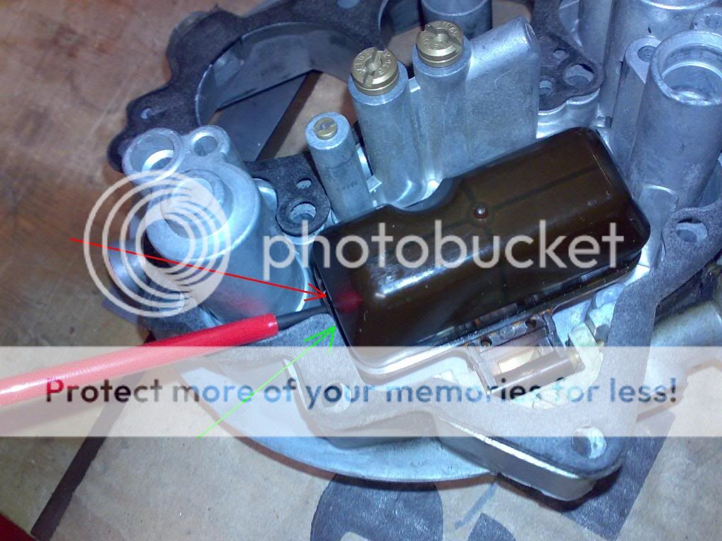

i have found a very interesting sympthom, probably the cause of the problem of the heavy flodding !!
when i oppened the spare carb that i have in my shelf, trying to find a cause, i found that the floater was blocked inside, i shake the carb, and nothing moved inisde, so the floater was blocked !
so i opened it, and i found the following situation, the gasket flange was very big in that area and it was blocking the floater in the "lower" position, the gasket flange was interferring the side of the floater
as the floater is in that position, that means that for sure the valve is not stopped, and the fuel flow will continue
in the following pic everything was moved, but you can see the contact interference points between green and red arrowed areas
in this pic you can see the gasket excess that surpasses the carb body (it is in between red arrows
it is really possible that this is the cause of the erratic behaviour of the floater, i mean the flodding was not always happening, normally the situation was the following:
hot weather, i stop the car for more than 1/2 hour, then i start the car, run a little and then rough engine (now i know that it was running on three cylinders). Explanation: the little run is sucking the fuel in the reservoir and the floater wents really down and in its way up it becames blocked in the gasket flange
surprisingly, if i stop the car until the next day, the engine works again
it is a great discovery, because that means that if i make that gasket excess dissapear (cutting it with a sharp knife), i will eliminate the cause of the flodding problems, right ?
do you agree ? have you heard about this ?
regards
ps. i will have to check it in my "problem" carb in the car
Yes sir.The kits come with several gaskets that are close, but not exact. It's terribly important to save your old gaskets for comparison. There's one more that has an extra hole that's easily mistaken too.
Trim the gasket so the float won't scrape it and hang up.
and also make sure the float is centered in the bracket that holds it down at the pivit point - not too far off center one way or the other.
ok, just to close this issue properly,
the gasket was trimmed carefully with a dremmel tool, that ate a little of the aluminium block too, all material removed help avoiding the contact with the floater, all this was made very carefully to avoid any damage
and, i have to say that after 2 months and 1000km, the problem has completely dissapeared !!!
