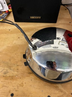

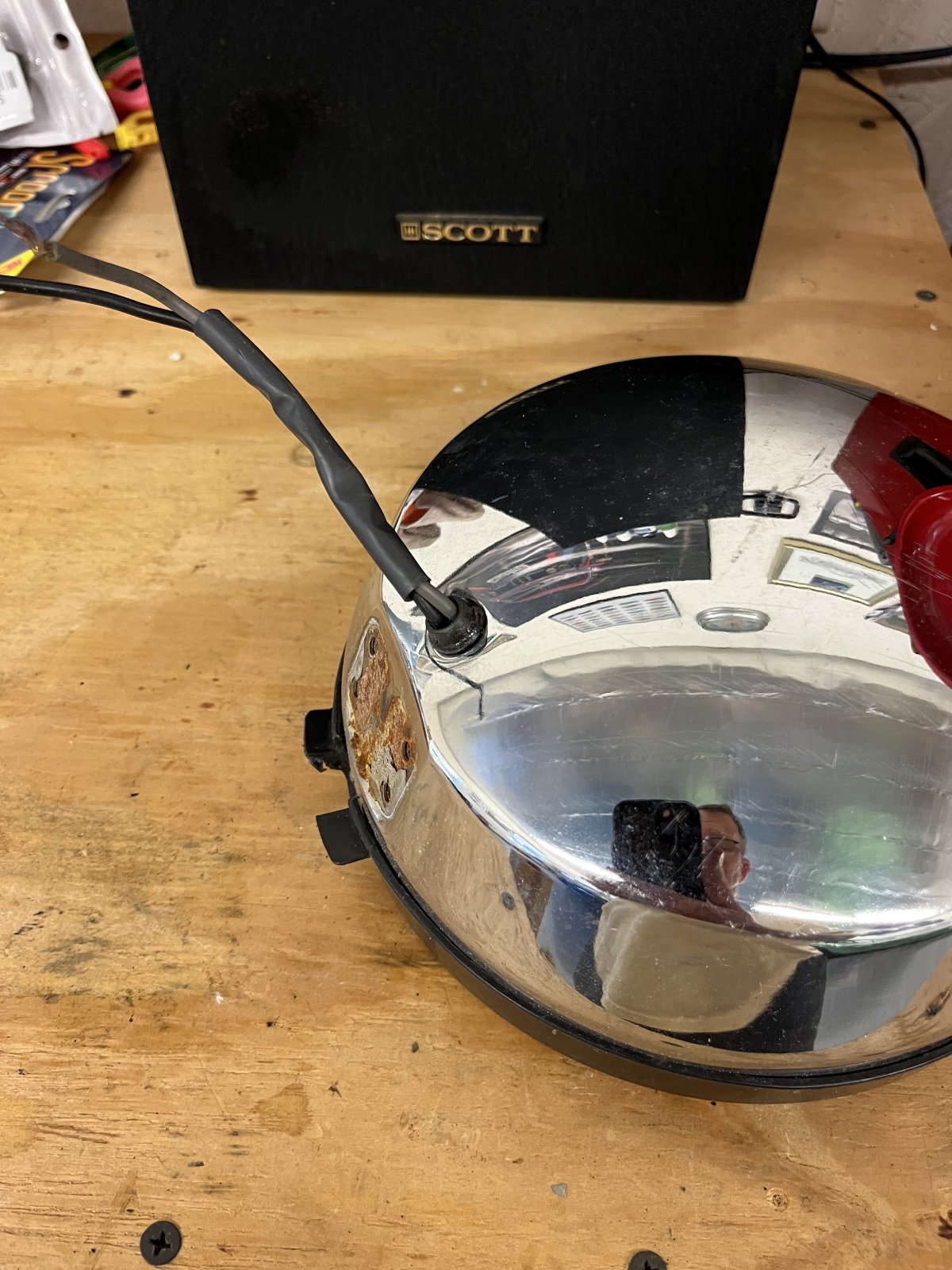

In 2018, I bought another 2002, fixed it up and flipped it. Included with that purchase was a set of large Carellos. Unfortunately, one of them did not have the mounting base which needs repair (see the pics). I'm looking for someone who can fix it or tell me if it is even repairable.
Let me know if you know of a resource.

Yes, the mounting plate is riveted on, you may be able to DIY with just a hammer and a flat dolly. Inspect the good light for the solid rivet style; round or flat head?
If you don't have the mounting plate, it's a different story. Maybe you can find a single. Which model are they?
I do NOT have the missing mount. The outside diameter is ~7 and 5/8” inches. 02.700.700 is etched in the lens
