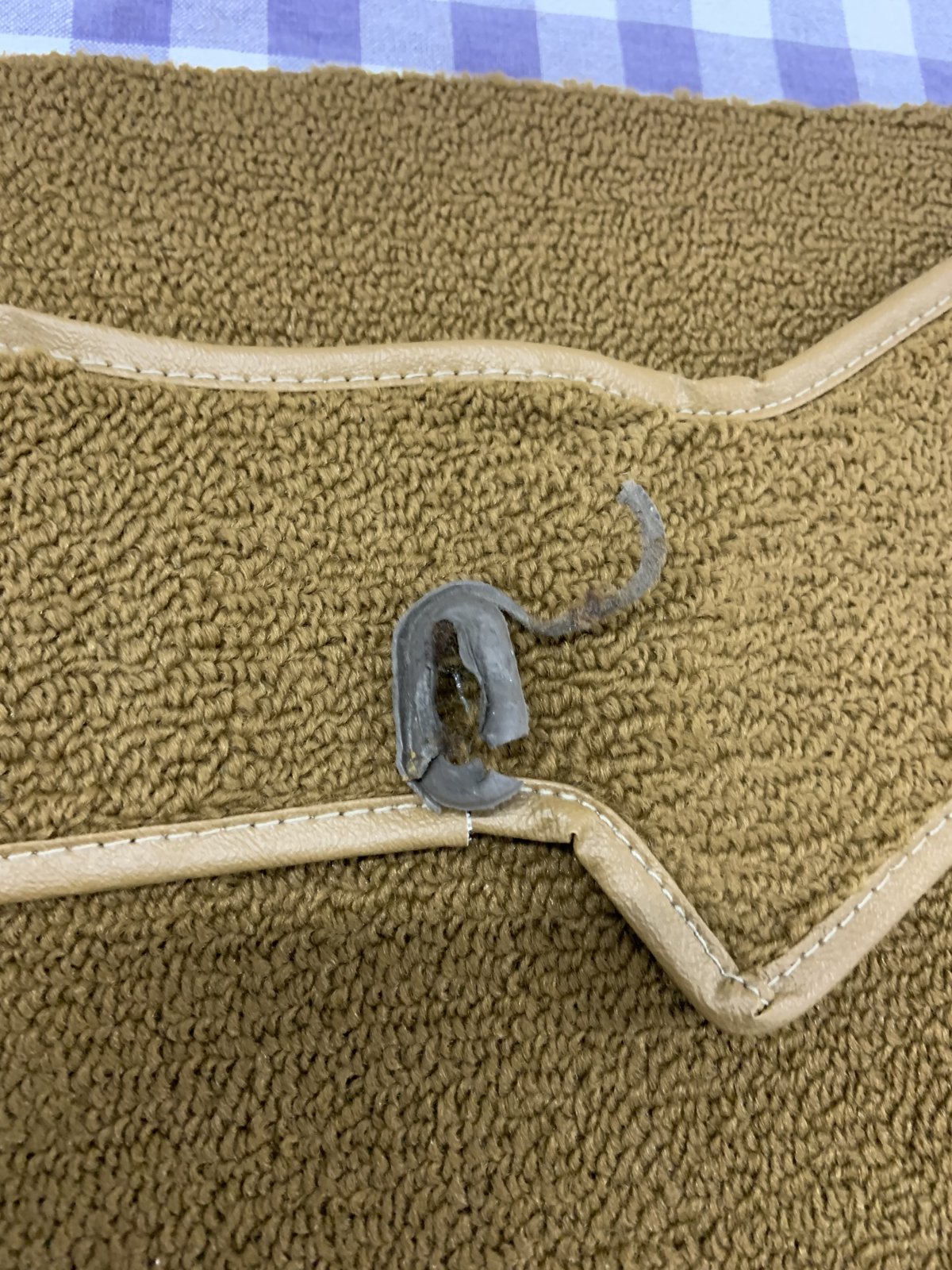

Any idea where to find this rubber piece that goes around the seat track release? The one in the pic was removed from the original carpet. Thanks.
Like Dan, I would like to know if there is such an animal available...I know from him that the World Uph set doesn't have them...do any of the other suppliers of carpet sets have this feature? Foot and heel pads are sort of generic on sets, but this is a pretty specific part that I'm guessing new sets don't have, even the German ones? My guess is that even the German sets don't feature the vinyl flaps, that cover the seat rails, either?
