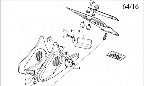

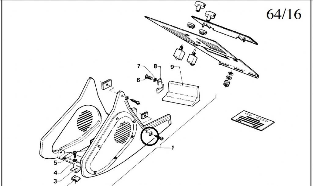

Thanks. But I don't think that's it. That type of screw and washer is generally available, but the part I once had has more of a conical shaped washer that's about 1/8" long. The part you show will compress the covering and padding around the mounting hole, but the OEM part keeps the head of the screw flush with the cover.
David, that's what we are saying. The washers as original are NLA.
I used the upholster screw in the photo above and it worked fine.
