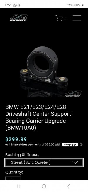

Thought I’d share the install/review of a very nice product: JXB Performance BMW10A0 (link below).

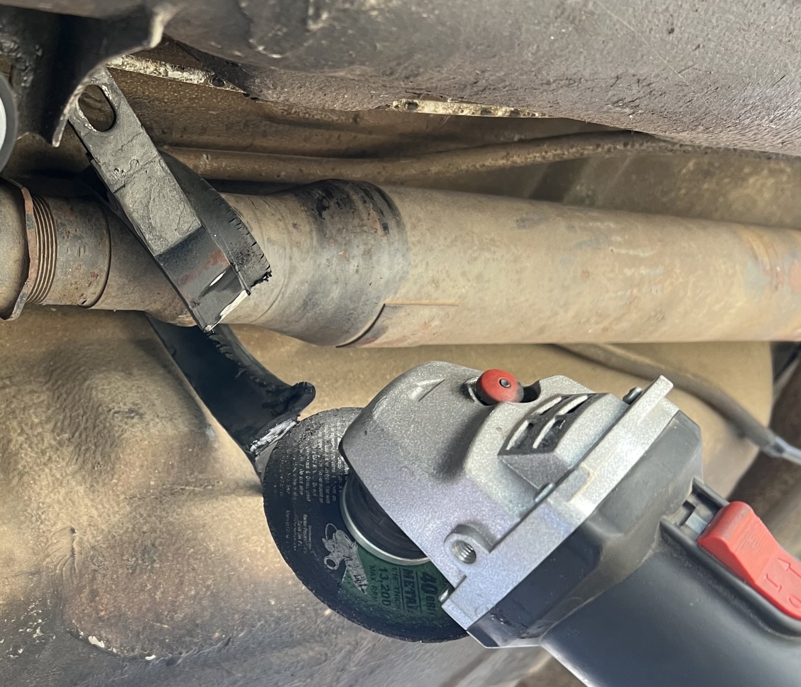

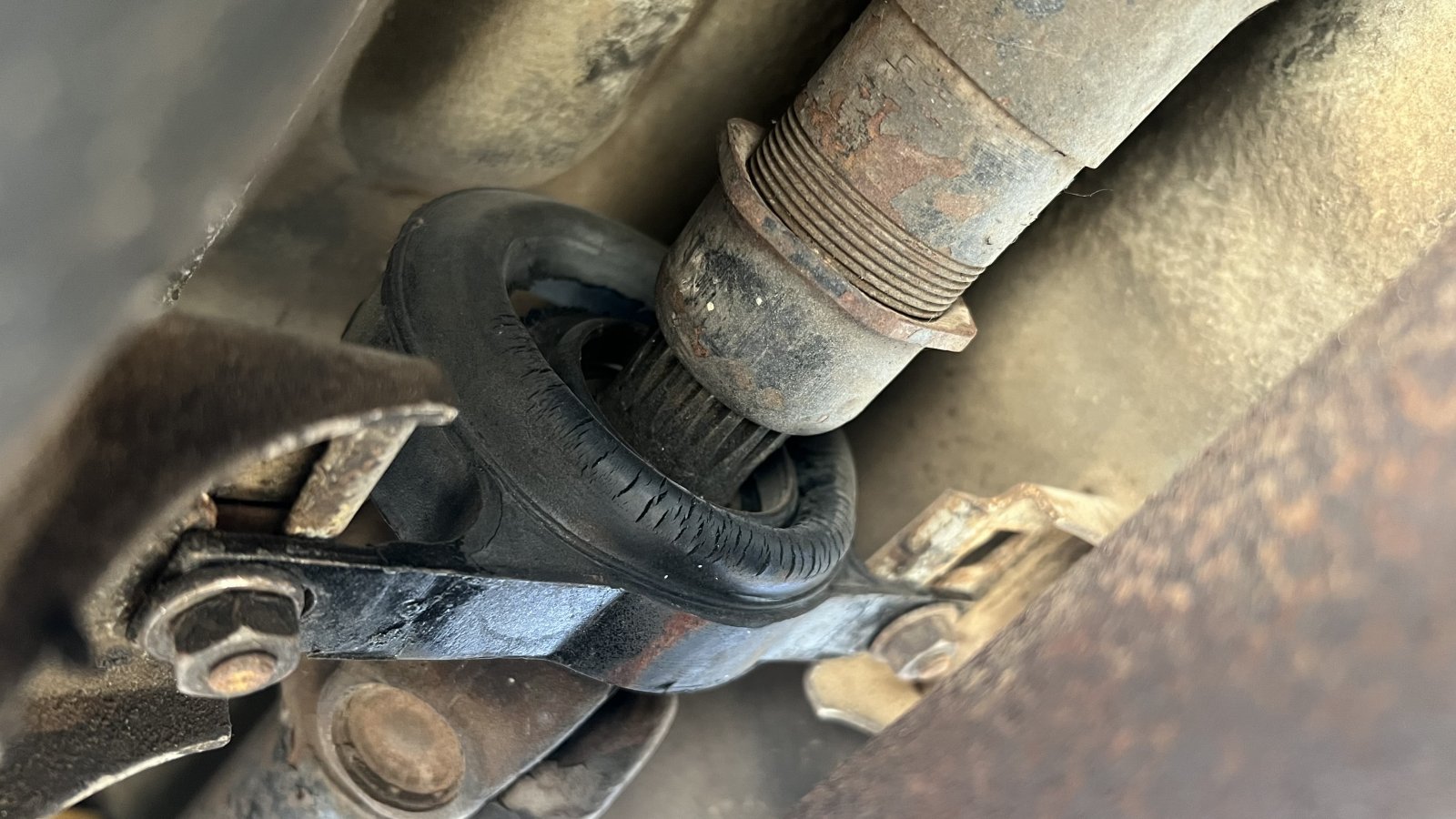

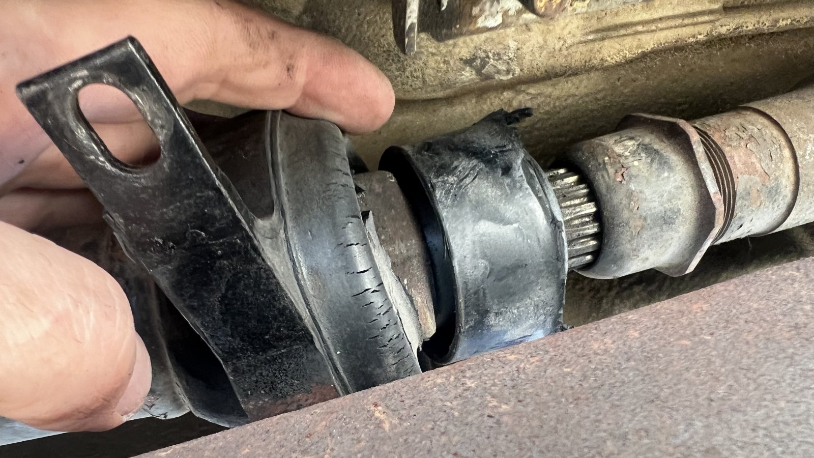

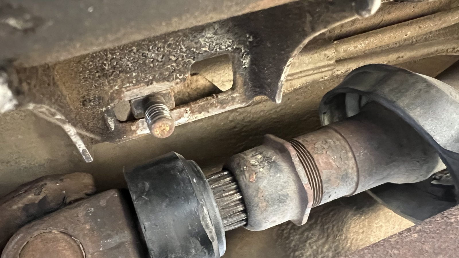

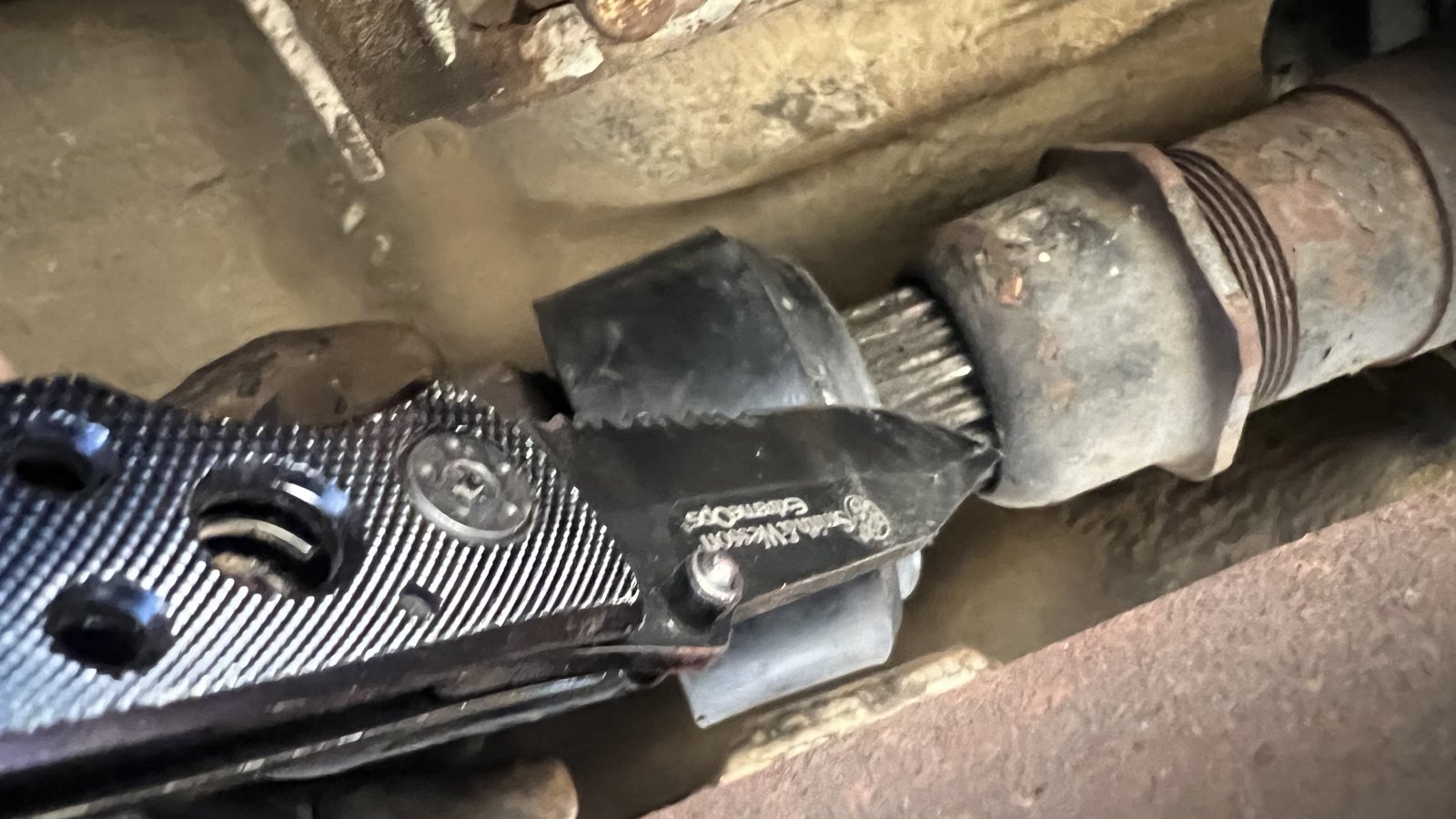

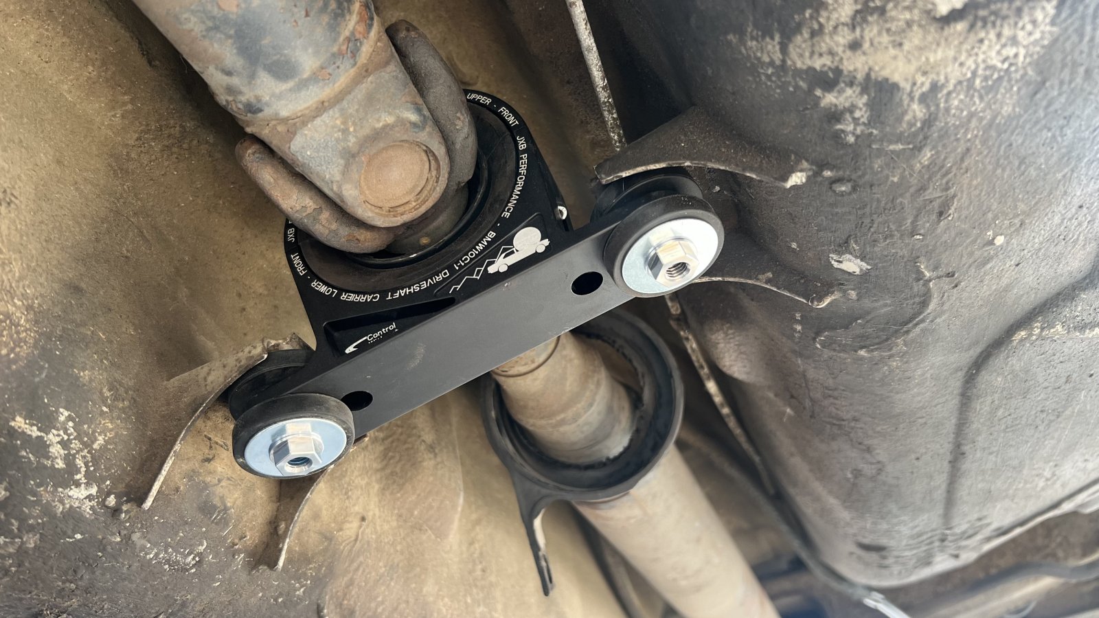

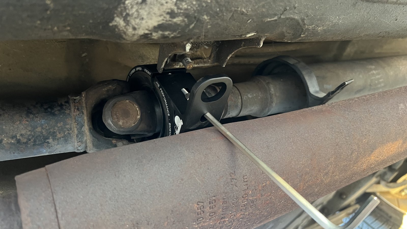

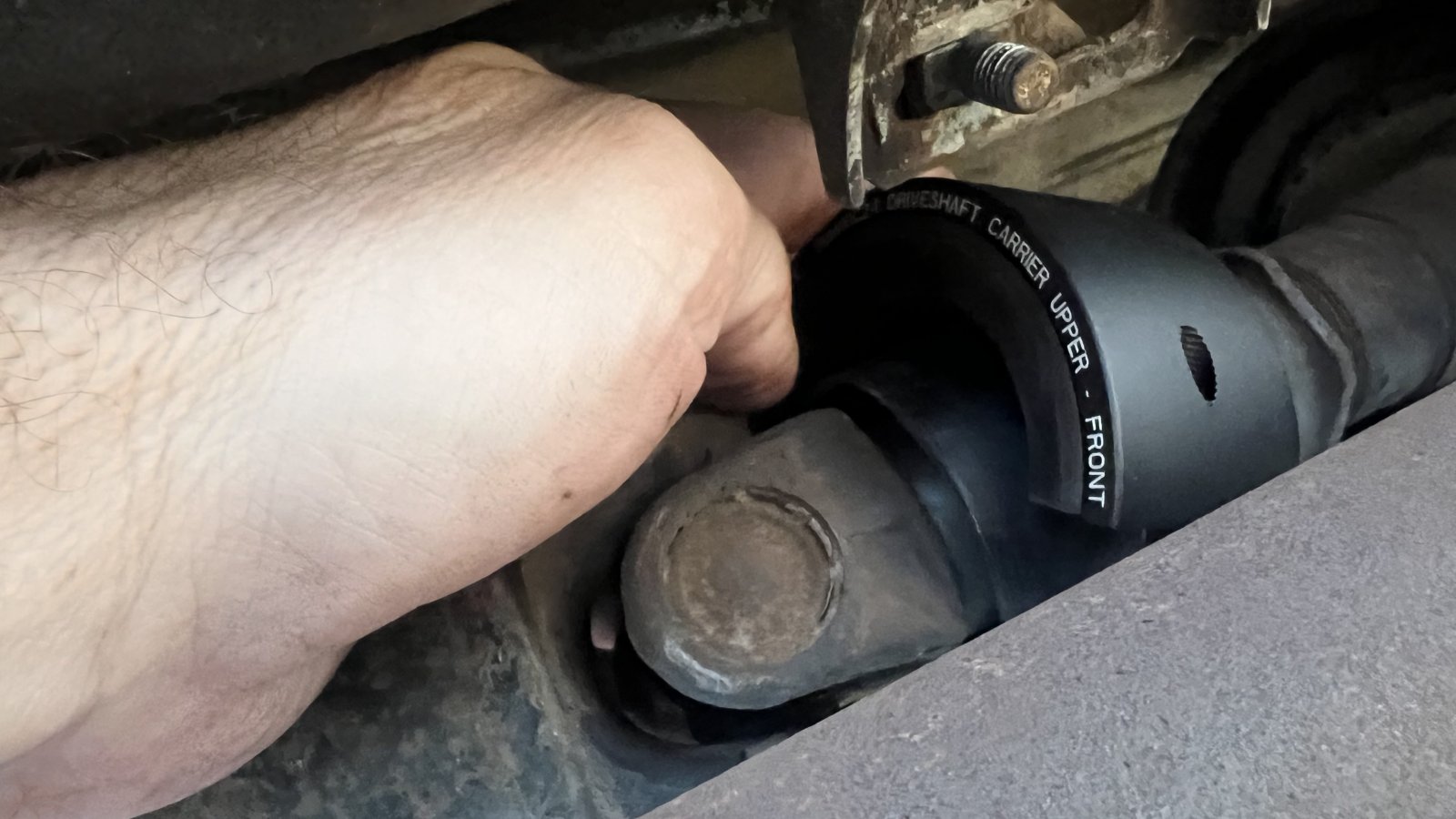

Install took all of about an hour, tools out to tools in. No dropping the driveline. No fighting with that 24mm nut. No removing the guibo. You cut the bearing from the rubber support of the oem CSB, smooth out the rubber, clamp on the new JXB support, cut off old CSB, and test drive. Dropping the exhaust may not be completely necessary, but it does give you all the room needed and limits the curse words. I dropped it midway through.

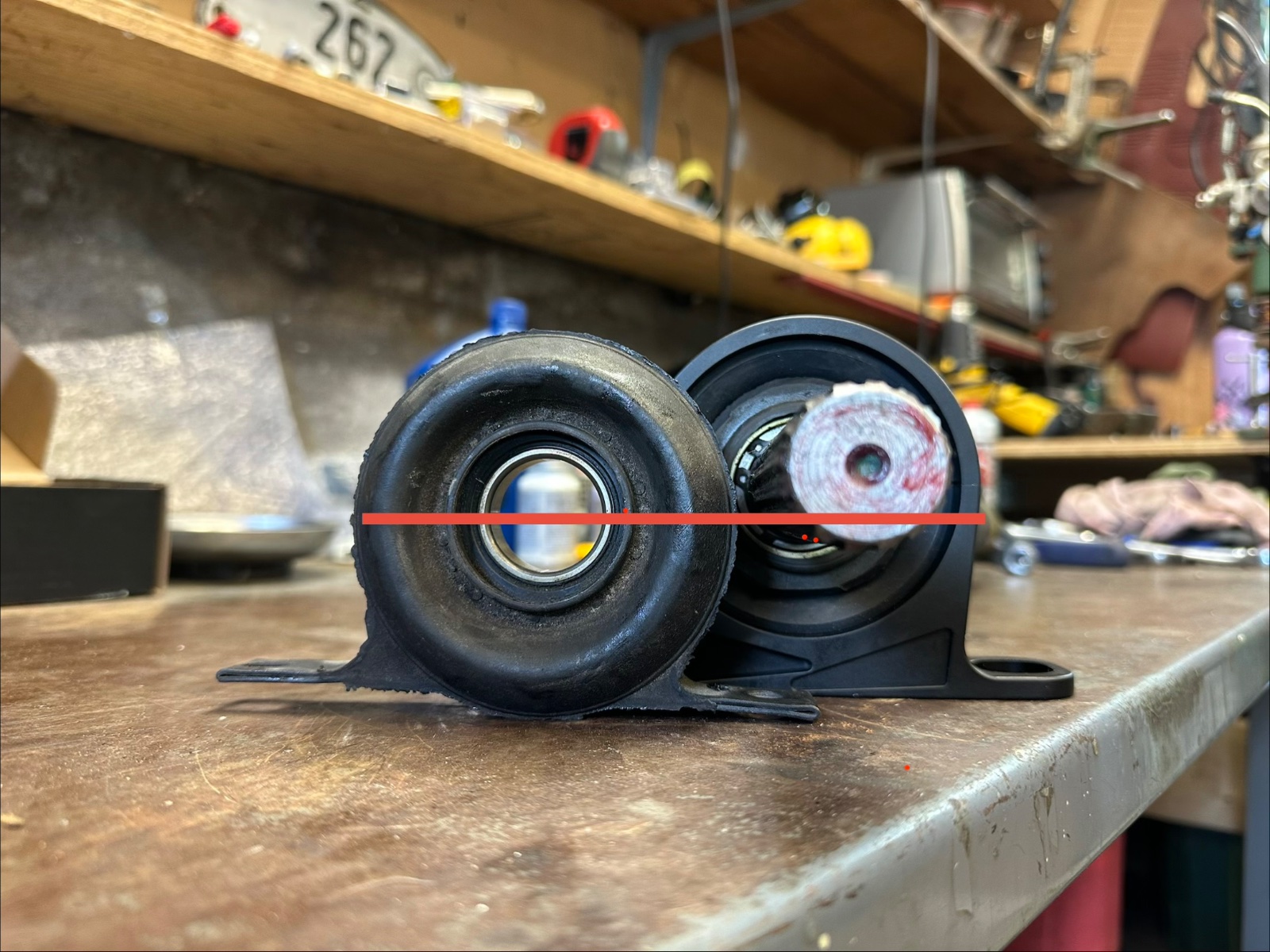

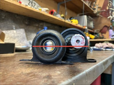

Yes, there is a minimal amount of fore/aft adjustment. The rubber isolation pads are tapered to fit down to the depth of the bearing, so I just centered it the best I could, which turned out well. Also has a bit of port/starboard adjustment as well. Helped to clock the bearing housing square to keep the driveline inline.
