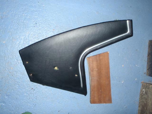

I had my centre console out today, part of fitting new carpets etc. It practically fell out from prior poor assembley. Mine is less AC and RHD.

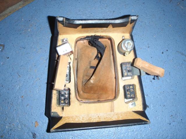

Can anyone tell me the correct assembly procedure and let me know if mine is orginal, it seems to have tiny screws everywhere, many through the console side walls and some parts look like old furnture chipboard!

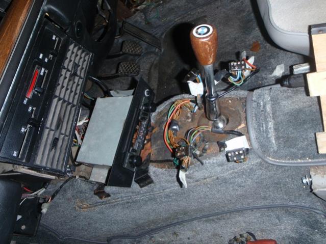

Is the process via the gearlever orifice, or to take the radio out and then the console floor with the rubber pieces in it? Neither seem too sensible.
The image with the radio shows some brackets probably once screwed to the inside of the console, could it be that these are fixed first, then it is installed complete, then the console floor then radio?

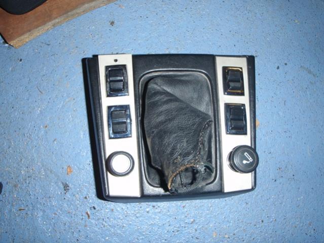

Any ideas what is the best way to hide the holes in the sides of the console where my radio mount screws in?
One image shows the window switches with a hole that someone drilled into the alloy strip, any suggestion how to hide that or what to put there? On the back of the console two of the 4 clips that hold the alloy strips on are gone and the wood poor in places.

Those small wood blocks should be attached to console side permanently, shift platform attaches to wood blocks with wood screws, I see you have the two brackets.

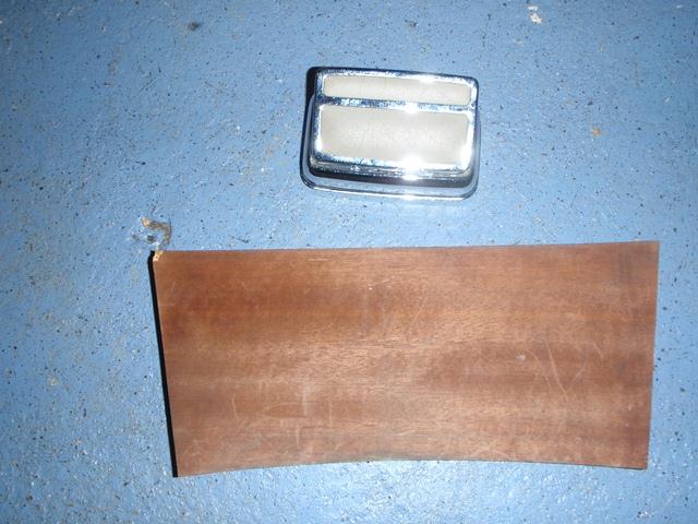

Is this part of the console?
Can you tell me is this piece of wood part of the console, or perhaps it replaces a missing part or is an extra? The ash tray is just for scale.
Mine console side panels were once screwed into it. It is made of chip particle) board so I doubt it is original.

Best is to mount the 2 metal brackets first. Then put the 2 sides, with the wooden panel attached (and holding them together), so that the upper ends go where they should against the dash board. Mark the holes for the screws attaching the metal brackets to the side panels. Take it all out and attach the metal brackets properly. This could be done with them attached to the tunnel, but easier on a workbench. Lastly, mount the gear lever console by small screws to the 2 wooden brackets on the inner sides of the large panels.
