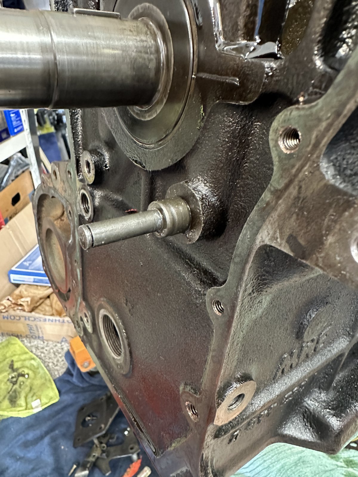

I got the chain guide pins off no prob with a 10mm socket, but how does the tensioner one come off???
It’s going to the machinist to be cleaned and gone through. Do you think they won’t need this off? They said they want it stripped. I suppose I could ask them when I bring it if there’s no easy way to get it off.
They don’t need it out after all - thanks

Leave that one. I’d only worry about it if it is messed up in the process. They’re still available new and not too expensive. I had to replace the one on Bert’s M90 because the E-clip groove was damaged. You’ll ruin it removing it.
