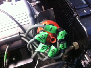

So it should be
DISTRIBUTOR < - > ENGINE
1 <--------------------> 1
2 <--------------------> 5
3 <--------------------> 3
4 <--------------------> 6
5 <--------------------> 2
6 <--------------------> 4

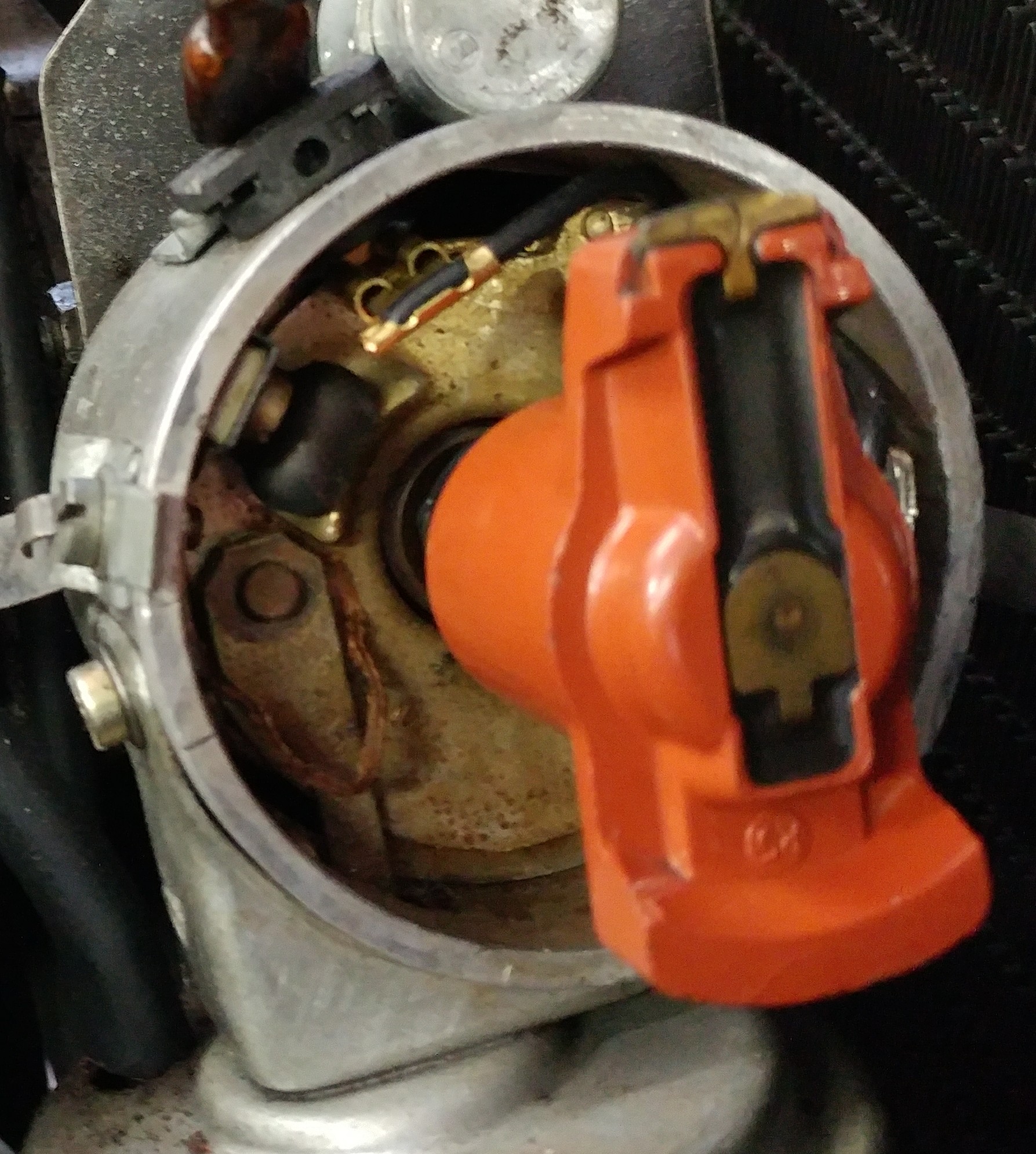

Look at the picture, slot in the rim of distrib at about the 7:30 o'clock position, that's #1:
Yes, that is where it was when the factory built it. But who knows where various mechanics may have set it since that time. The car will run just file as long as the distributor body is any even, 60 degree increment from that point, as long as the wires are shifted accordingly.
The key is where the rotor is pointed when #1 is supposed to fire.
