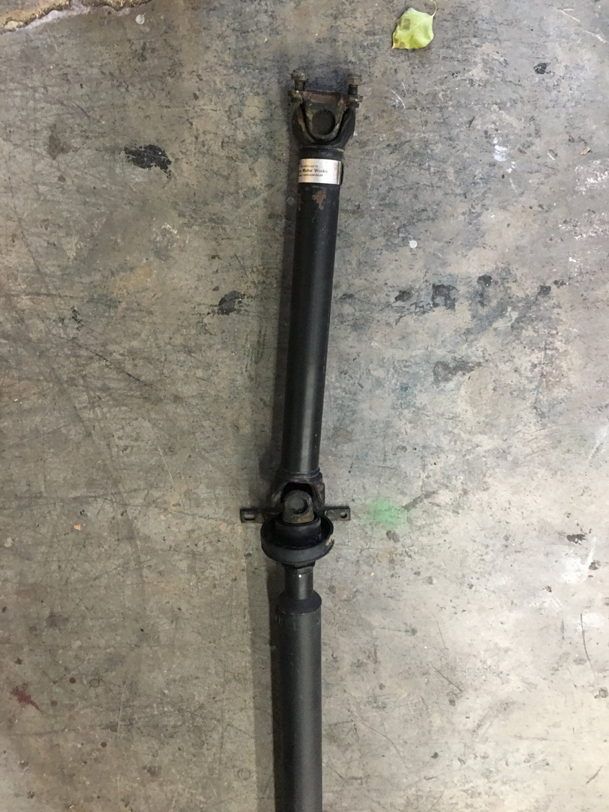

Hi Don. I have a 4HP22 in an E9 installed by clowns. I *believe* the driveshaft is from a late E24/big motor E28. Part is coming out today for measurement. Front U-joint came apart and made a mess.
I'm seeing $250 new driveshafts on eBay/Amazon with ASIN as spec. Curious.

That's not what this is about. I can and have built, spliced, and rebuilt BMW driveshafts with greasable U-joints in my shop. I have been replacing BMW driveline parts for 50 years. I know how much it all costs now that Driveline Pro has bought up all the local driveshaft shops. I get it.
What I'm after here is: Who is selling new $246 E24 Asin spec driveshafts and what are they exactly?

I have a few 4hp-22 shafts including a couple of Beyer remans but they’re all for the 4 bolt flange at the trans from the EH trans. If you want the 4hp 5/633 shaft that uses the guibo, that’s a hard shaft (lol) to find.
