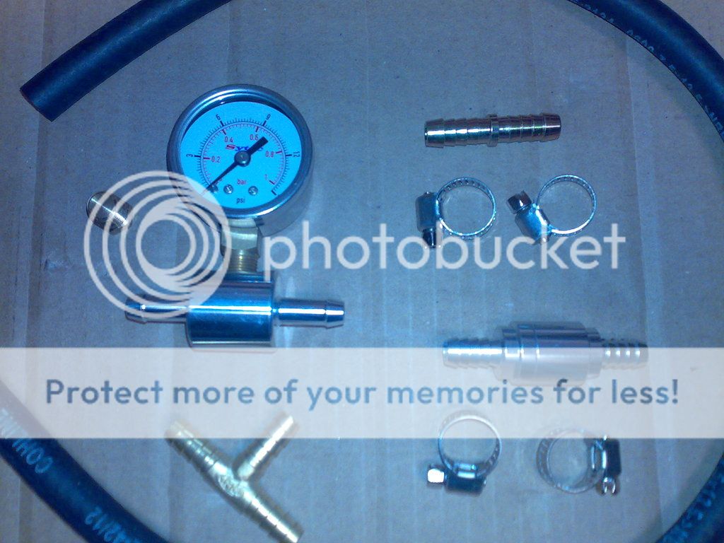

i would like to check the pressure that the fuel pump is able to give, there is this or other similar kits that contains the elements to be able to do so

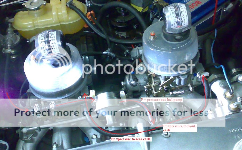

the usual setup for a CS is this one
obviously there is not too much room to put the pressure gauge at the output of the pump, moreover, once the air filter cover is in place you can see nothing

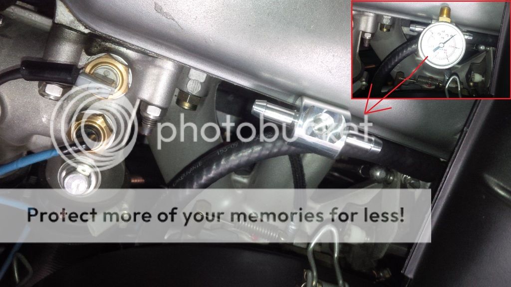

but the hose that goes to the front carb is free and in a good position to hold the gauge

1- is there a chance of meassuring fuel pump pressure output ? you must consider that when the carbs are refuelling their reservoirs, and thus their floater valves opened, Pressure = 0
2- provided that both carb floaters are closed, do you think that the three pressures are equal ? i mean: ( P = Pr = Pf ), i think so

The hoses between the fuel pump outlet and the two carburetors are short, gently curved and fairly large in diameter, so the pressure should be consistent throughout. In other words, what you call "P", "P f" and "P r" should be the same (at least to an accuracy that's >> the resolution of your gauge). So putting the gauge near the front carburetor should work OK.

As JMackro stated, the output pressure in the three lines is the same, so you can install your gage in any of them, choose one for convenience.

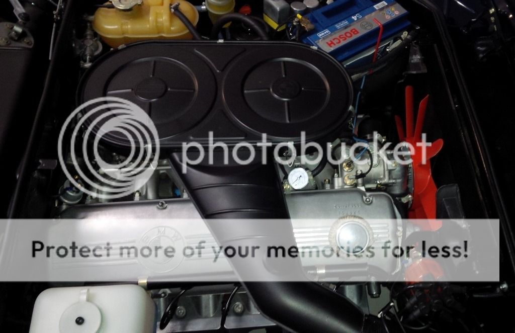

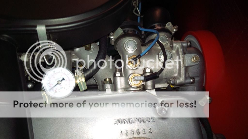

nice theoretical approach, here comes the praxis, after some empirical moments...

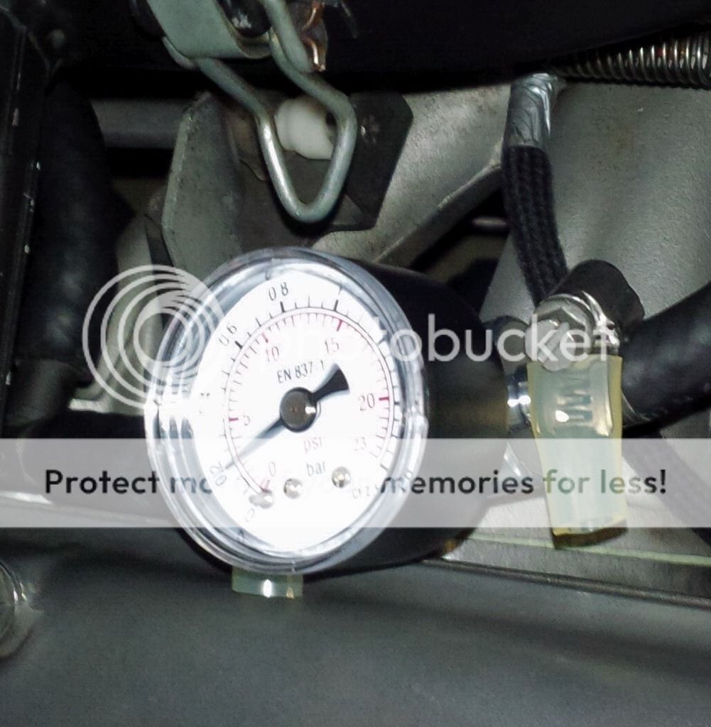

0,2 bar at iddle
and 0,2bar at any rpm,....no variation
and obviously, when engine is stopped pressure remains,
the setup adds a bit of control illusion to the engine bay ;-)
