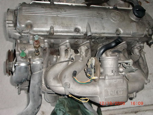

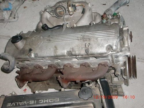

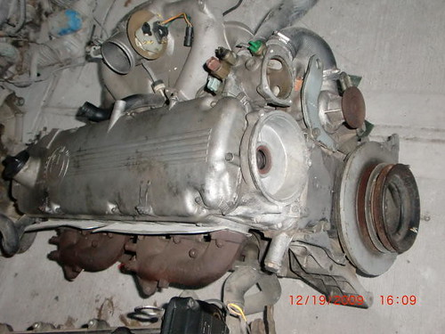

I am looking into doing a 3.5L swap and have located an engine candidate from (what I have been told) is wrecked 1986 735i. I haven’t gone to see it yet but am planning to sometime in the next week or so. Can anyone lend some expertise on things in particular to look for and check which would raise major red flags in regards to the engine condition? When I am there, at a minimum, I plan to pull the valve cover look at the cam lobes and check the color as well as signs of head gasket failure. The seller has provided these images as an initial look. My Bavaria is currently carb’d and I plan to keep it that way for the time being. Any advice is greatly appreciated.

Based on the pictures:
1. Missing injectors- check the plugs.
2. Water outlet missing; use your old one.
