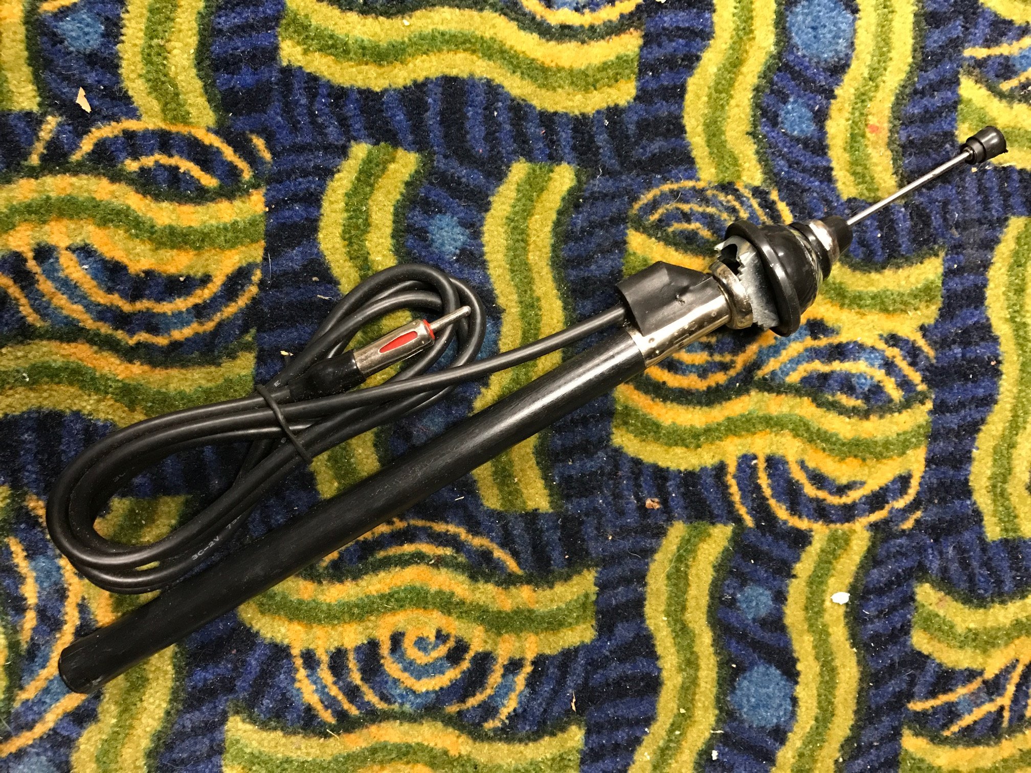

i do have a brand new antenna - 25 bucks shipped to you
very easy to install - you could do it yourself. one thing you should do before hand is to measure the hole in the fender top ... you don't want to enlarge the hole.

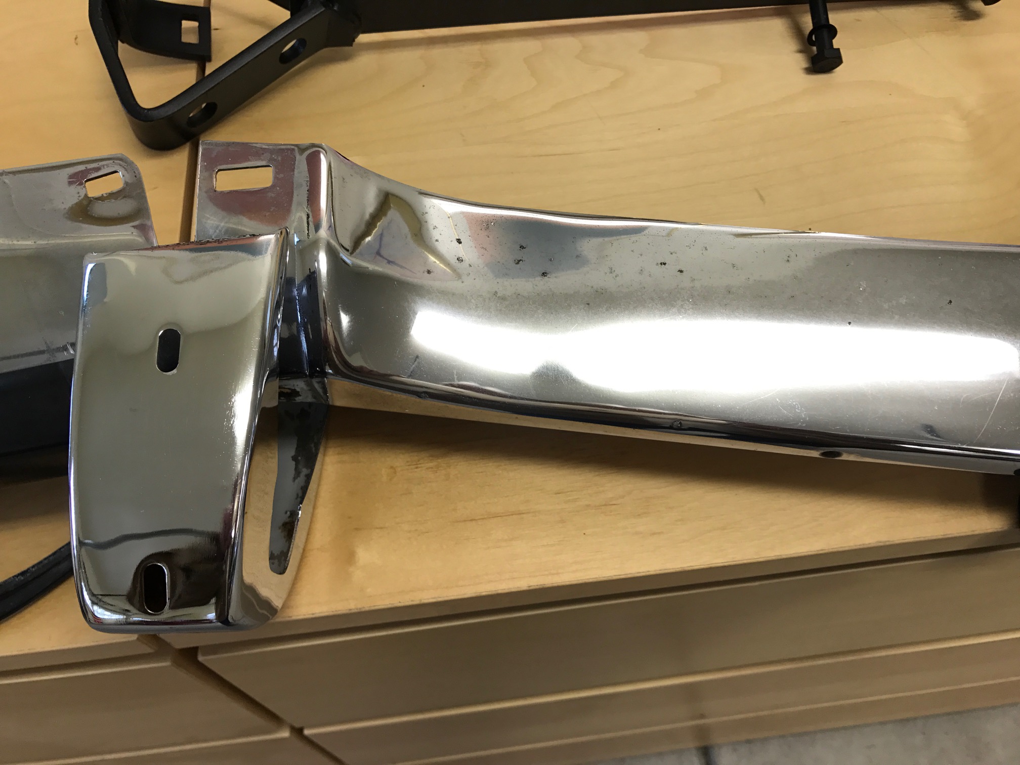

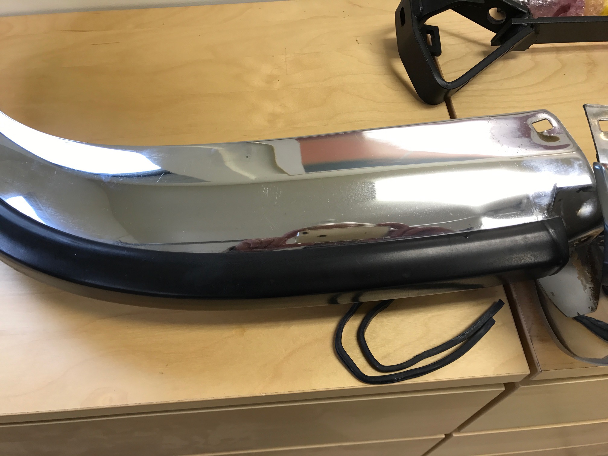

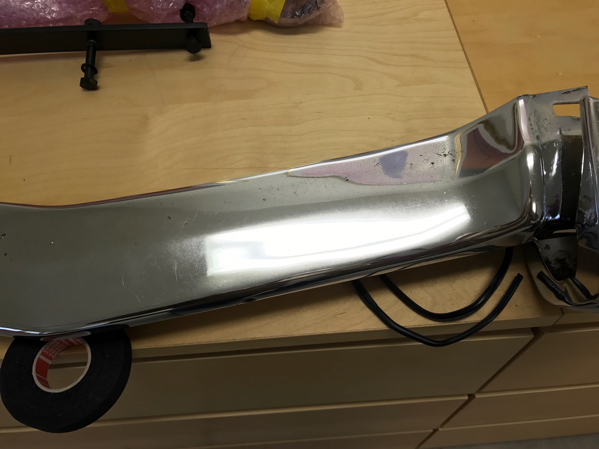

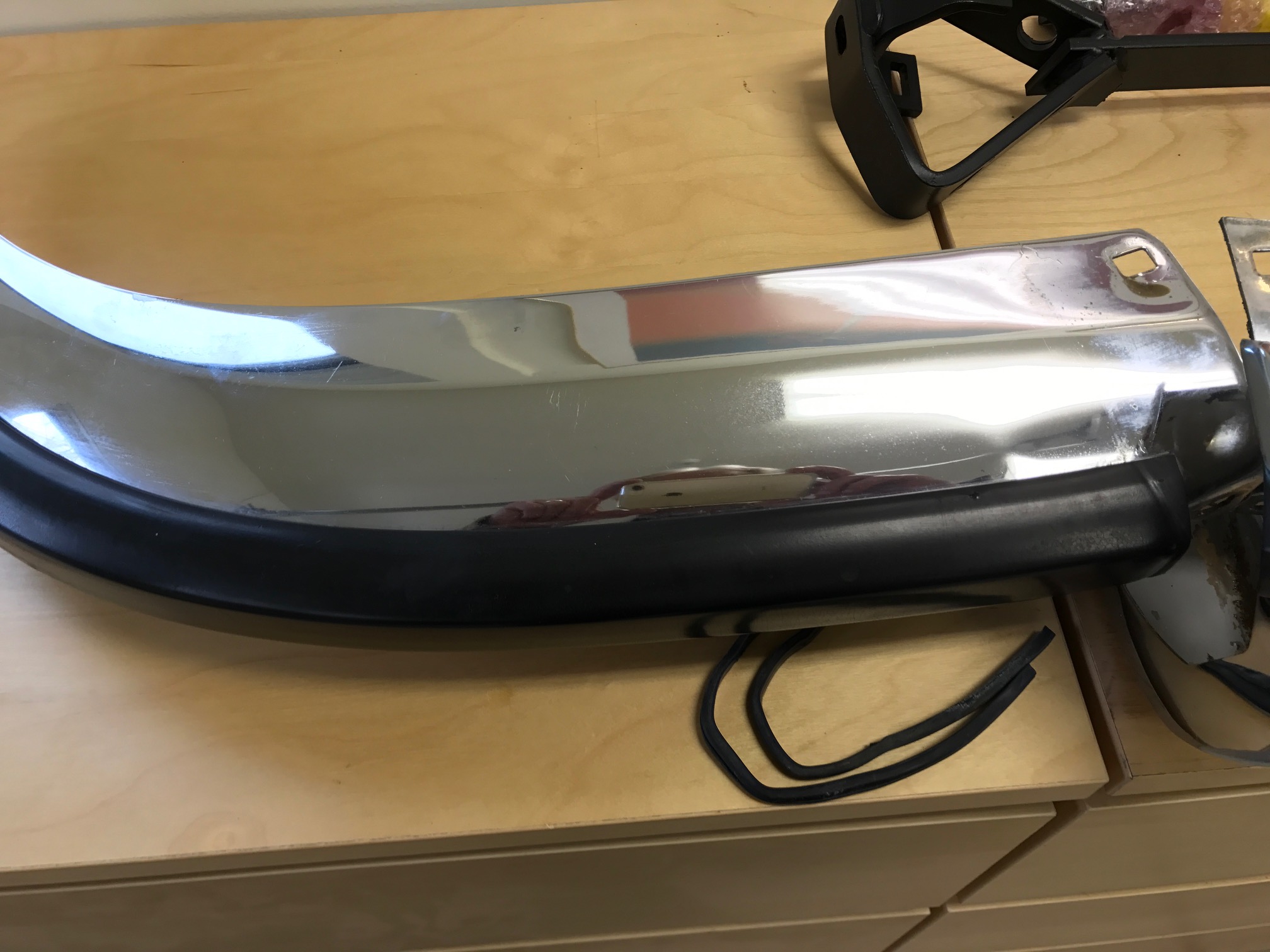

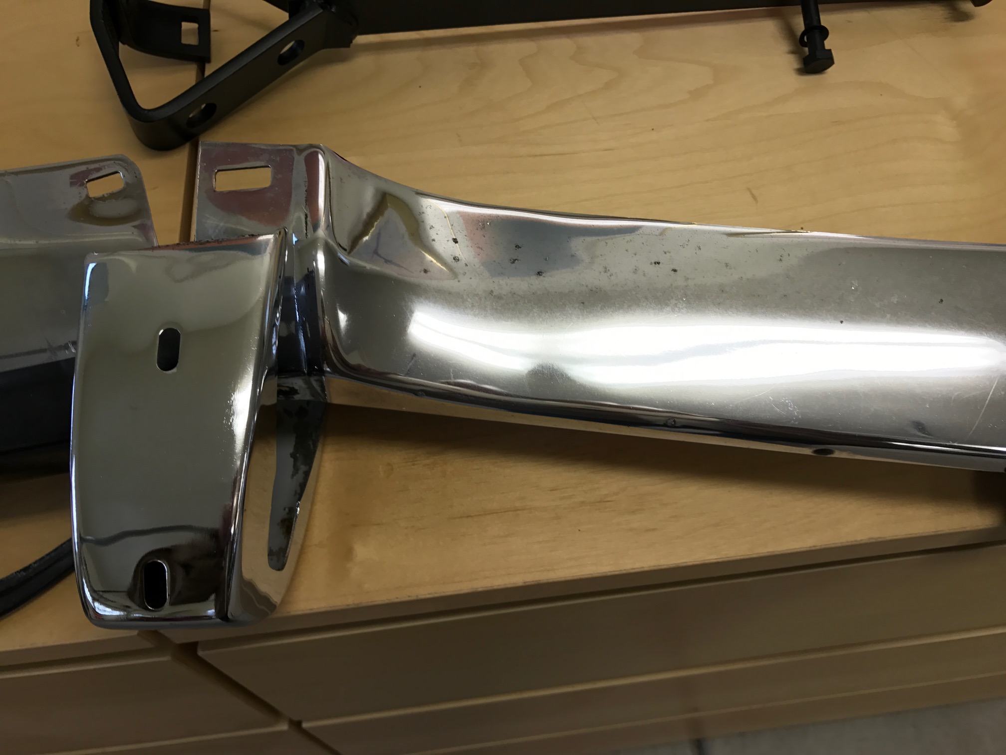

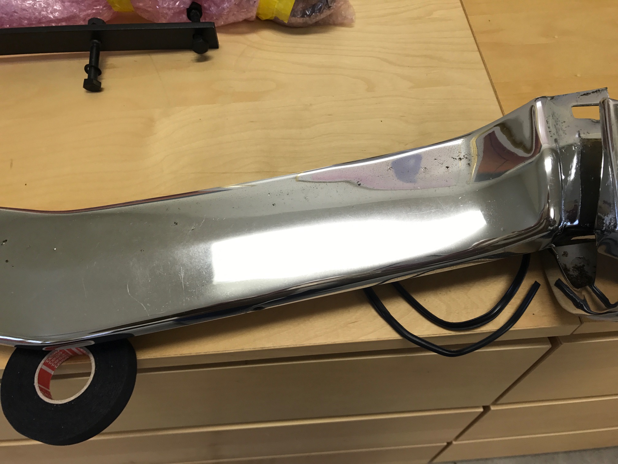

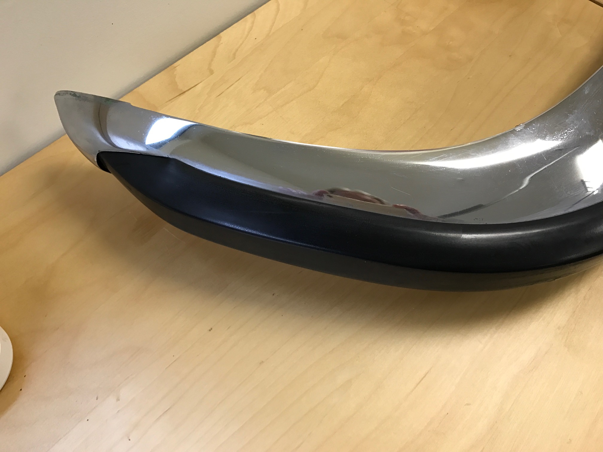

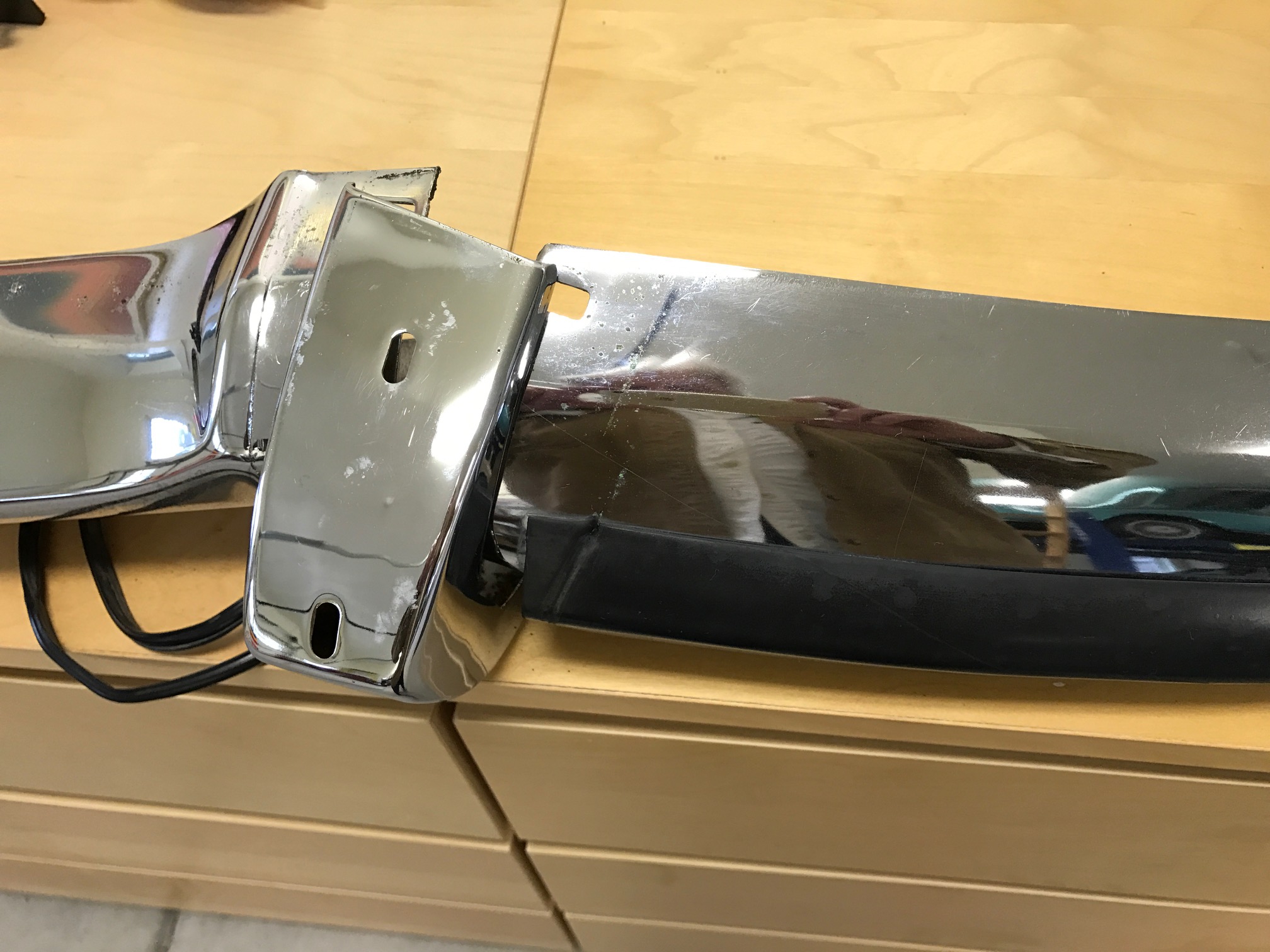

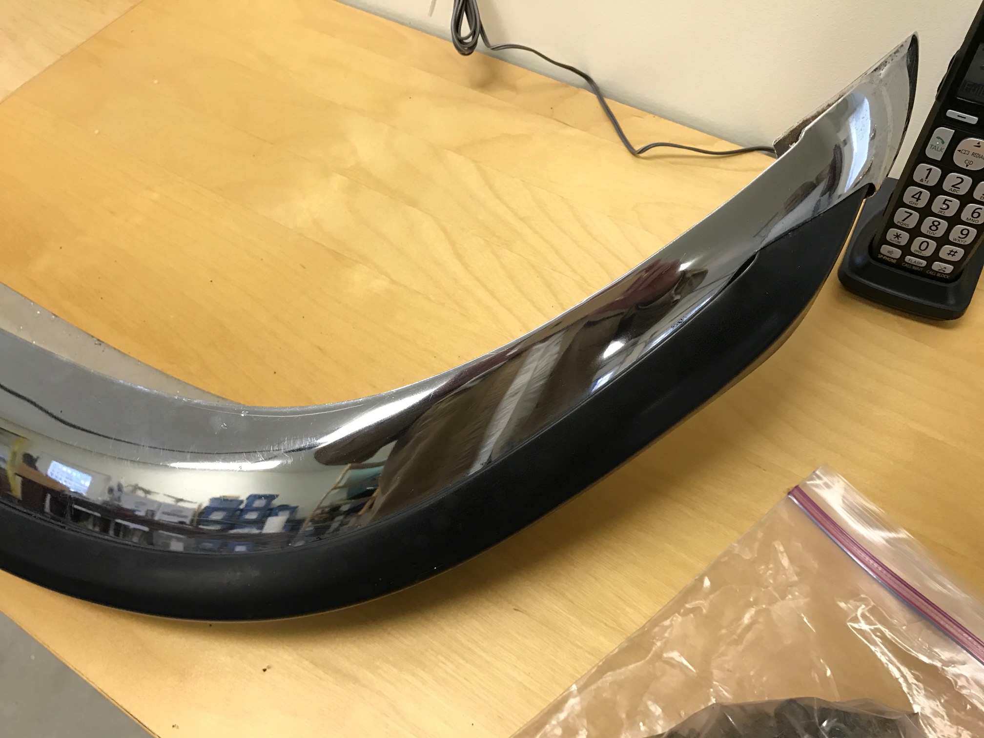

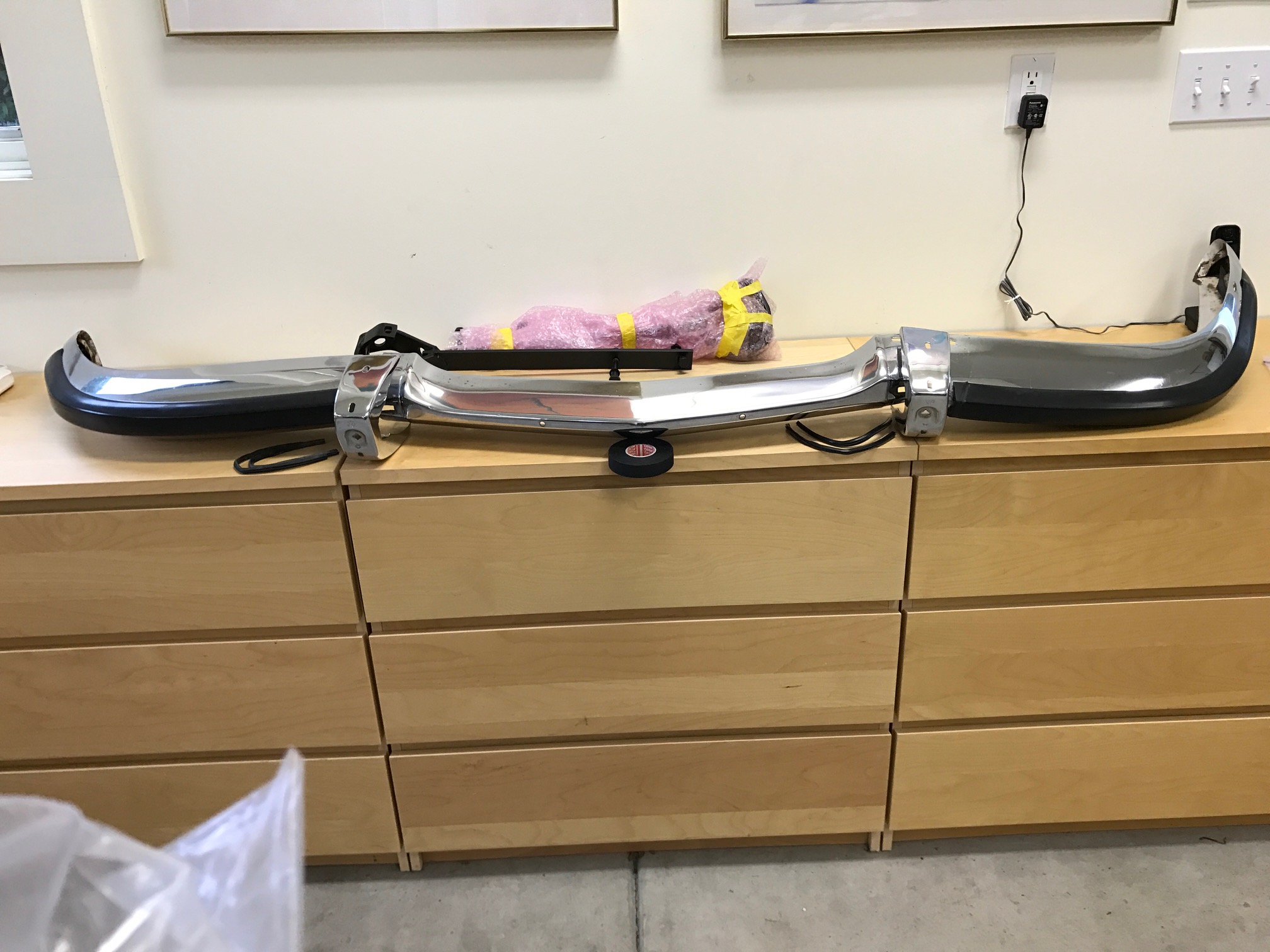

the front bumper doesn't look that bad ... not perfect, but not bad. i would try polishing the chrome and see if you can clean up the center section as it seems to be the part most in need. if you rechrome one, you have to rechrome it all.
I'm with Scott, Polish the $n0t out of it and use it as is- save a grand. Regarding the bumper holes, in the front- the round pipes fit in the original holes and in my case I made plugs for the rear rather than welding them and they can't really be seen, but if yu want them welded and painted then the price would be a little closer to what you were quoted.
