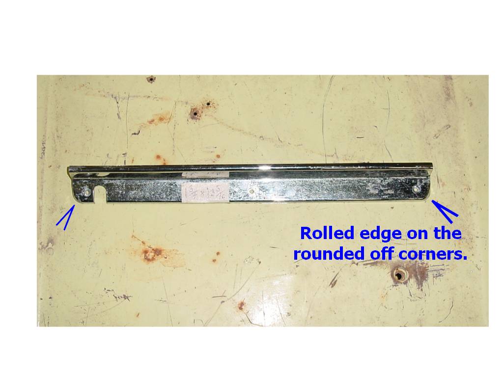

I have been wondering for a few years now but the Left and Right seat rail chrome trim is a piece that is broken or missing from many E9 coupes. This piece would seem to be a great candidate for reproduction in aluminum or some other light weight metal that can be polished. These pieces are originally made of a plastic material that easily breaks when either sliding your seat back and forth or when being removed. I am sure we as a group would be able to offset the cost of having a batch produced. I have attached a copy of the part from a link from ebay for further clarification. If I had the time and or skill, I would do it myself. Just wondering if anyone has reproduced these parts before.

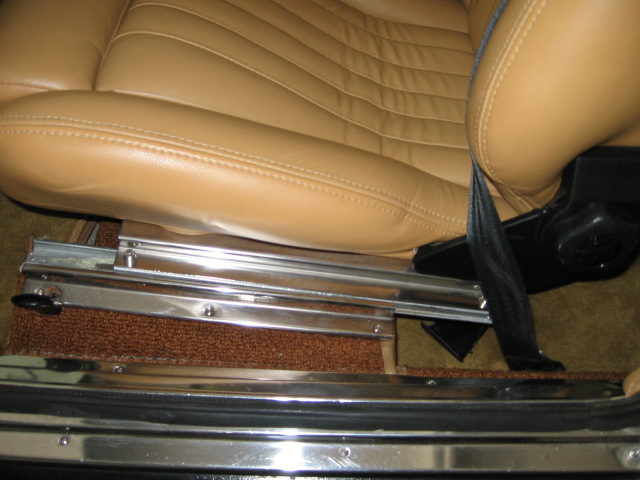

I had a friend make a set from stainless and then polish them. I'll ask him if he's interested in making any more.
Wow those are very nice seat trim rails that you won't have to worry about breaking. That is what I had in mind. Also, looks like you also had the seat rails cleaned up. Thank for posting these Doug! Please Let us know if your source is interested in making a few more of those.
Was your friend able to do the rolled edge on the sheet where the 2 corners are rounded off ? If he can then he should take on the job because it will be a month or two before I can get to it. I have 2 possible ways to make the corners look just like the original part which is the challenge or the fun part of the job for me….. I’m thinking both will work but you never know for sure till you actually make a piece. ~ John Buchtenkirch
no, john, you can clearly see in the photo there are straight angled corners, not rounded

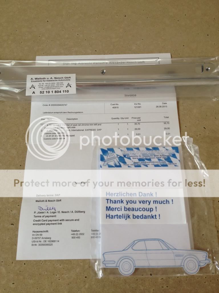

Got a set from Walloth!
Just wanted to post the set of the plastic chrome rails I received from Walloth. Really fast shipping and they even sent me a E9 notepad as a gift! Also, when is the last time you saw an actual signature on a receipt? Love the German efficiency and thoughtfulness. Quality seems ok but I haven't installed them yet. Anything special I need to know or are they just bolt on?
