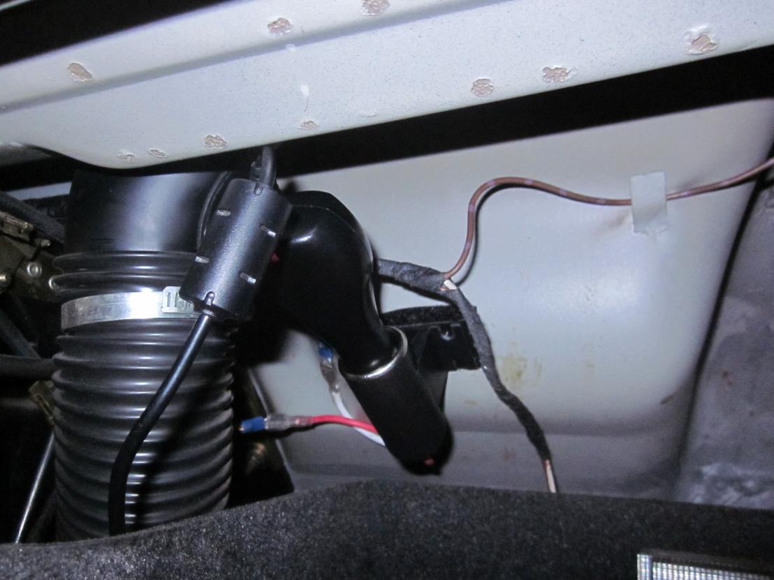

Put an accessory plug in the glove box. I used velcro to mount one up out of sight for powering an iPhone.
