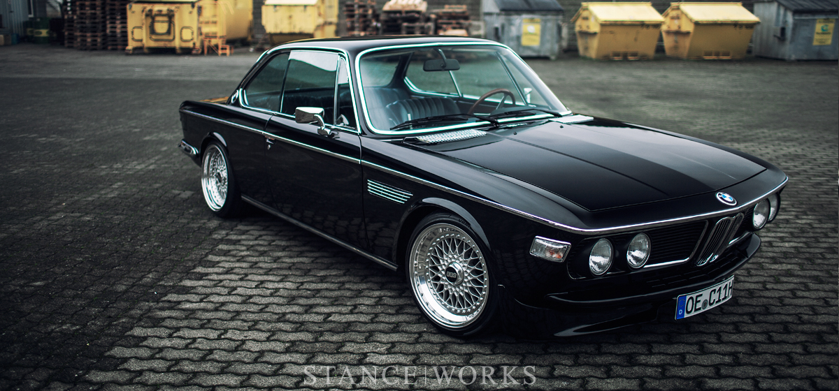

I was talking to Erik at Coupe King, and he mentioned that I should have the side marker lights removed on my coupe when I have it painted. I thought he meant the front corner, amber corner lights were new to 74 year, but in looking at a bunch of images I see those are on pretty much all model years as far as I can tell. What am I missing?
But, in looking, I noticed that some are clear instead of amber, as below. I really like this look. Any ideas on how to source the clear lenses?

Scott, I'm quite certain he's referring to the yellow reflectors immediately behind the corner lights (not shown on the Stanceworks image, as they probably removed them already). You can see the reflectors in my avatar image. Federal regs forced the addition of side markers, sealed beam headlights, and those bumpers we love to hate, among other things. Got to admit the fenders do look cleaner without the additional reflectors. I have seen Italian side marker lights that are yellow and clear, but haven't seen the full clear ones shown in your photo.

It appears that someone has already remove those reflectors from my vehicle. I am glad. Really do like the clear lenses as shown in the image I provided. I love the Amazon green color. Hard to tell from your avatar whether you changed your color to black?
there are 3 versions of the front turn signals - the full amber, the italian mostly amber with the clear fronts and the full clear (with amber bulbs).

Thanks. Really prefer the full clear. I will hunt for those.

I too like the 'monochrome' appearance of clear light items on the front and red on the rear. I replaced my front signal lenses about 18 months ago. Yes, you will need yellow bulbs, available at most auto supply stores. I paint the 'tops' of those bulbs with high temp silver paint, so they are essentially invisible when the lights are off, but very visibly yellow when they are on. By 'tops', I mean essentially the hemispherical portion, leaving the bottom half of the bulb glass clear.
I bought my lenses on eBay from Brazil or Argentina. They are good quality, except for small deviations on the screw mount holes. Those were easily modified and a bit of clear epoxy added to fill a small bit of plastic that was incorrectly bored out by the supplier.

I remembered one other aspect of the clear lenses I bought for the front. They do not protrude out as far as the OE orange ones did (don't extend as far out from the fender as the OE ones did).
I like that, but in order to fit them, I had to trim about 3/8" off the reflector for the bulb. Used a Dremel tool to cut and trim it so they fit well. Sorry I'd forgotten about that when I posted on 9/8
I too got mine from Sephito. These clear lenses are for Euro (Italian) models and the lens housing I believe is slightly different than the US models (besides the wiring).
