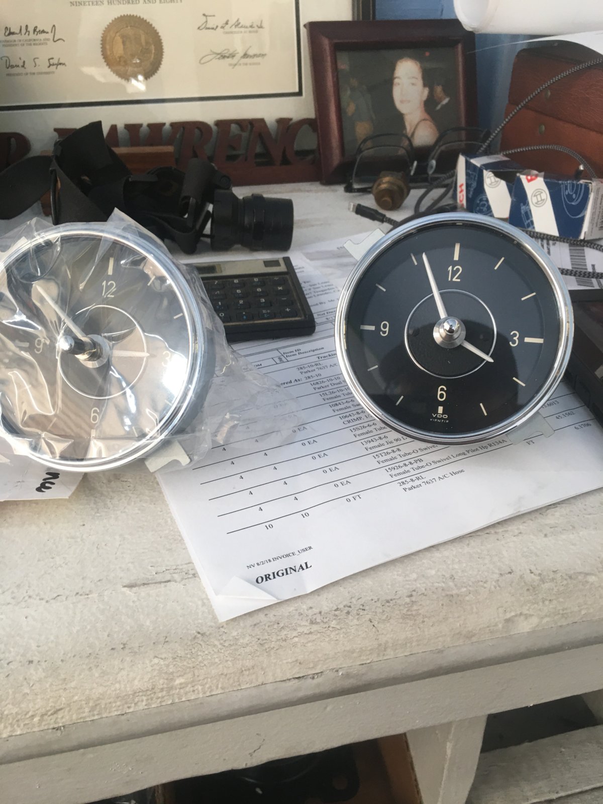

See my post #4. I sent Clockworks 2 Bavaria clocks. Both VDO. One was a later model quartz and the other electric/mechanical (a ticker). They replaced the quartz movement in the one and repaired the ticker. $225 total. I like the ol skool ticker and installed that one in my car. Anyone can have a quartz or a ticker converted to quartz. The ticker has more of the personality associated with these old cars. :cool:

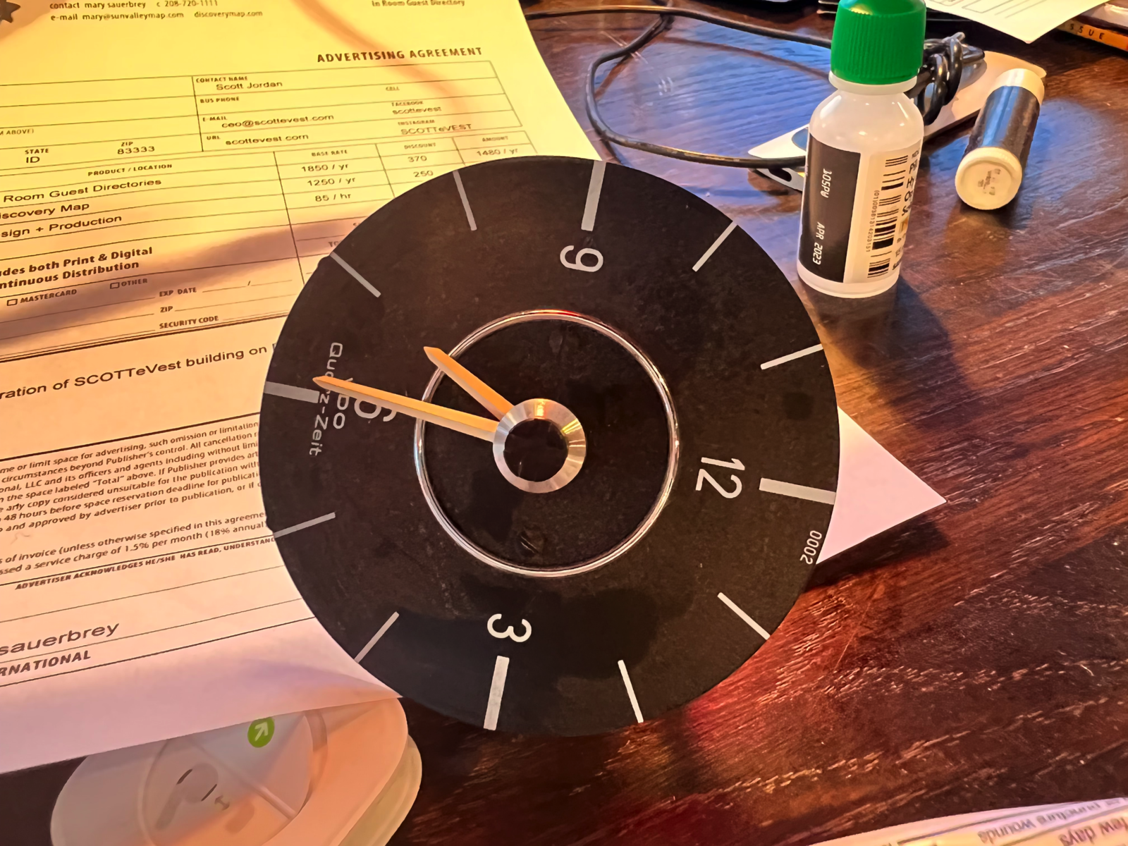

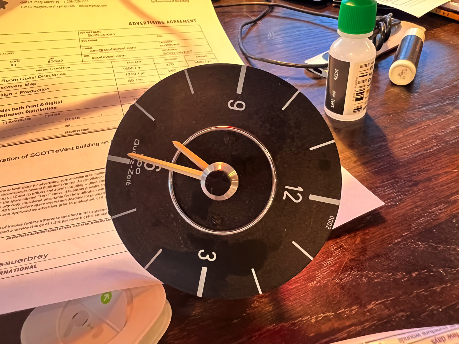

I actually have 2 clocks. Both say "Quarz-Zeit" and seem to make ticking sounds. Frankly, I suspect both work, but there is an issue with power, although I have tried to get my shops to do this right without any luck. Is my clock already "quartz"?
I am going to try to attach power to it and see if they work as is or really probmemetic.

Scott your picture suggests it's already quartz by the text on the face, unless for some bizarre reason you have a mix of parts from previous owners.
You're on the right track, figure out the power first then address the clock if you have to
