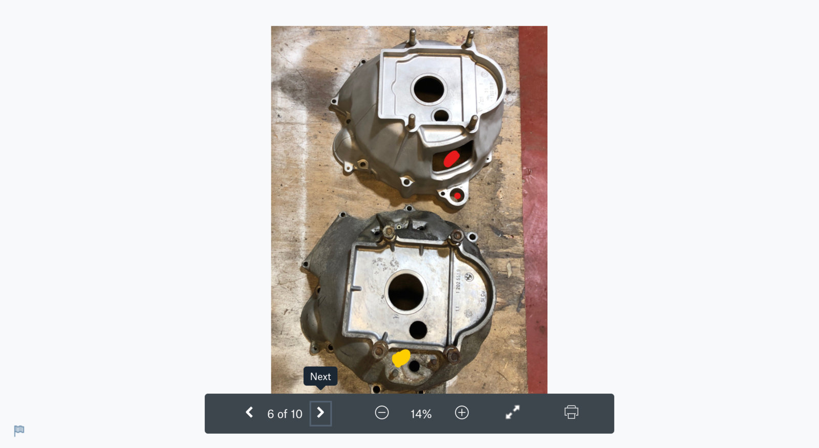

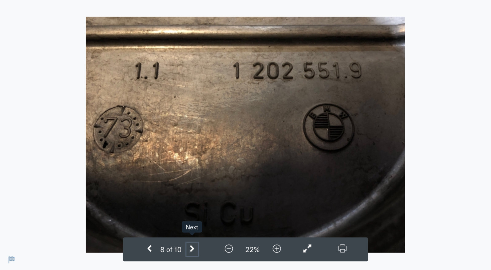

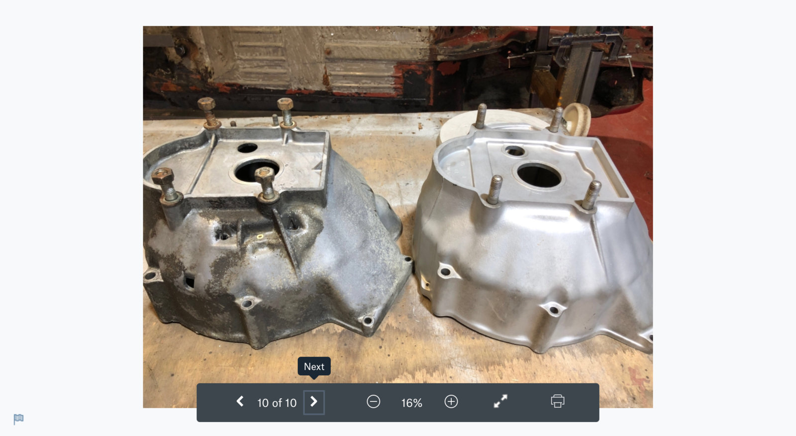

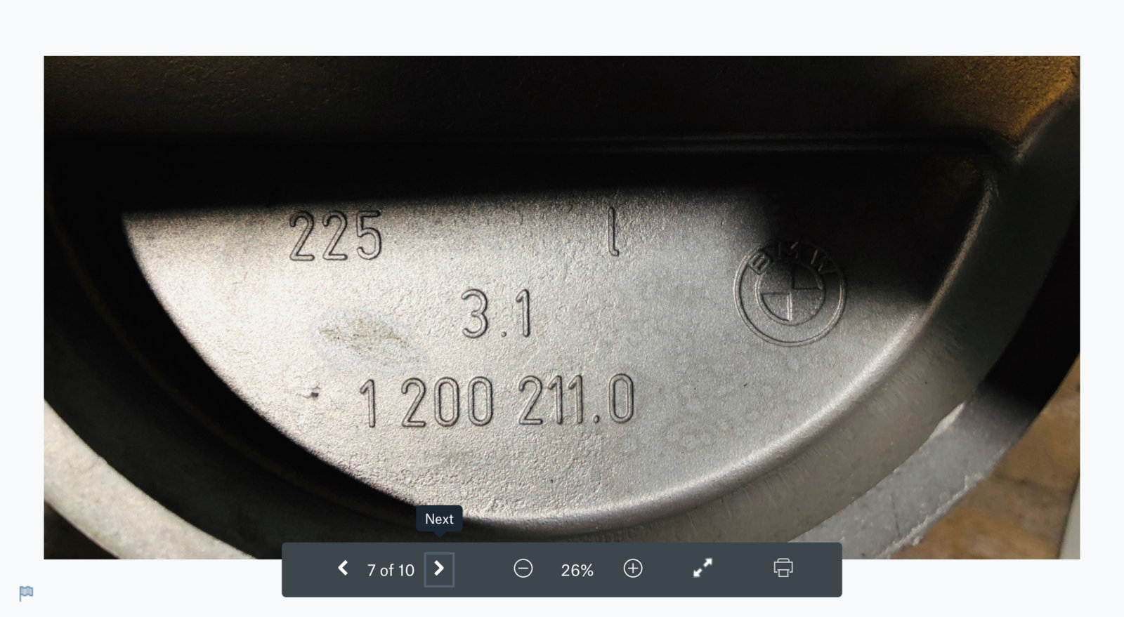

1202551.9 is the later style Getrag bell housing used in the 4spd gearbox where the clutch cylinder is outside rather than the older style 1200211.0 where it’s inside.
I pointed out the eBay clutch cylinder that matches the 51.9 type. The older style was in the 72 model cars and newer type in 73, when exactly the change took place I can’t say.
Most prefer the later model due to cheaper clutch cylinder (30 vs almost 200) and convenience in swapping it being outside.
I must admit that mechanics is not my strong point so please confirm from the experts. The cleaner one is the old style...

I’m sorry - swamped today
You must define one key point before you can choose a direction.
Measure the shaft travel of the slave following directions in manual. That’s what the cutout is for.

Btw- from memory hahaha - to use an early tranny with the later bell housing and pivot and fork and clip and TO- we would need to change the housing cover. Contact srennoc for more info
What defines early tranny? Not being a smart a$$. :)
