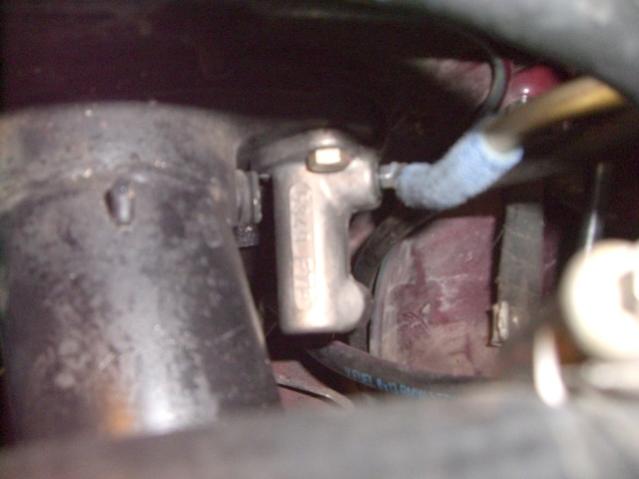

Bert Poliakoff has a nice master cylinder for sale. You can PM him. You can also rebuild them if the insides are decent.
Clutch master is e21, e23, etc, e9 is NLA. It fits but sits at an angle, there is a thread on this in the Forum. You may need to tap out the flange on firewall where it mounts, pretty easy to do.
Got in touch with my good friend Jeff Karp,
and he can re sleeve them in SS and rebuilt them,
all for reasonable $.
I think that might be a good option.
Regards, Alberto
