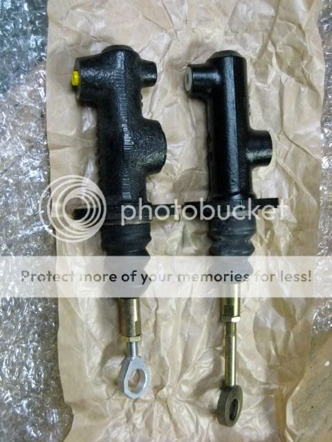

This post is more general to the earlier questions regarding the master clutch availability. Walloth & Nesch has master clutch cylinders that appear to match the old style configuration. I just picked this one up from them for around 82 €. All I had to do was swap the eye bolts. The input and output ports are the same size and in the samel locations. The cast body of the unit appears a bit more streamlined. I have not yet installed it but it seems like a good match.
The part number is 21 52 1 104 262
