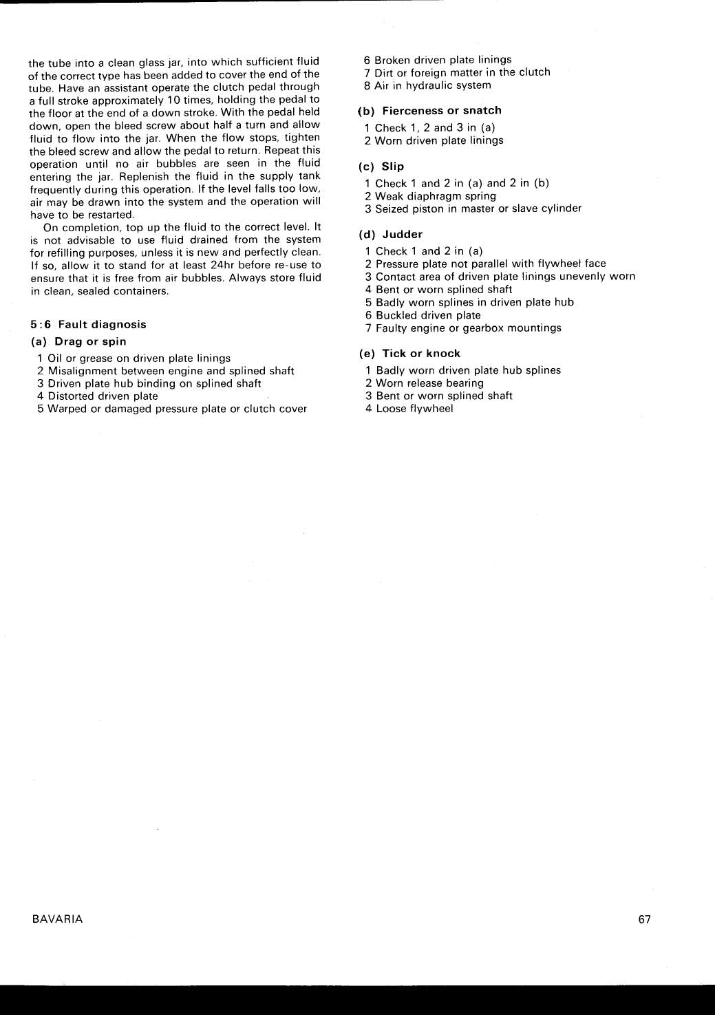

Many things come to mind regarding "wobble" or "judder." Among them: worn or sloppy motor and transmission mount/s, leaky rear main seal, glazed pressure plate, contaminated disk assembly, over-greased trans output shaft splines, worn transmission output splines and even a worn/dry pilot bearing/s (housed in the crankshaft). Then, there is the remote possibility that your clutch pedal linkage is too tight, so that when the hydraulic fluid warms, it causes a slight disengagement of the clutch plate and a slight slipping.
If the sleeve/guide upon which the throwout bearing rides is galled, gouged, rusty, dry or seriously worn, this can also cause strange or unexpected pedal feel/behavior which you may be confusing with clutch engagement/disengagement. This part is often overlooked when a new clutch and throwout bearing is/are installed.

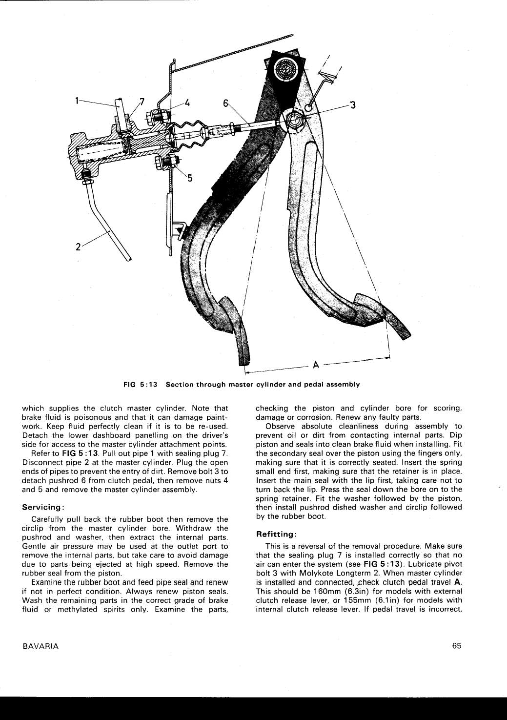

Since your clutch design is fairly generic, aside from consulting the obvious (shop manual http://www.e9-driven.com/Public/Library/BMW-E9-Manual/pages/en/21.html#refertoc or the haynes guide http://www.e9coupe.com/tech/autobooks/chapter5/gallery.htm#autobooks_manual_065 ), consider browsing though this site for ideas: http://media.centerforce.com/DiagGuide/DiagnosticGuide04DL.pdf
I am sure others may have more specific and alternate suggestions. Best of luck.
