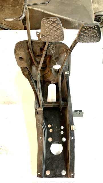

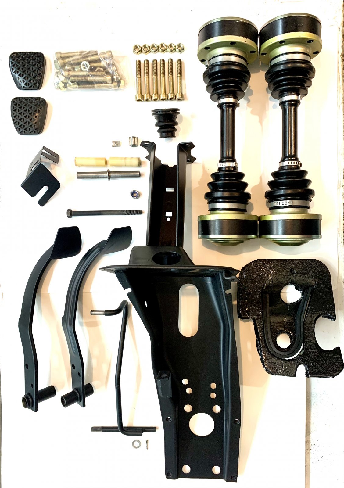

Restoring and installing the pedal box:
As disassembled, wire brushed, sanded, bead blasted, primed, painted.

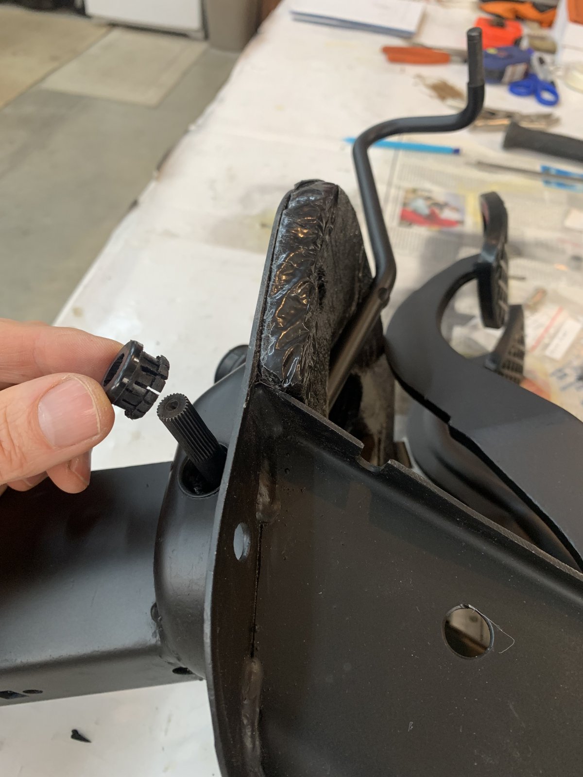

I purchased new bushings from WN to hold the accelerator pedal but they required slotting the back sides and adjusting the diameter to fit. The foam insulation that goes up against the firewall was in bad shape on my car so I formed a new one using layers of neoprene. After I was done I noticed it is now available on WN. Wish I had known sooner!
A mounting gasket was made from 6 MM thick foam
