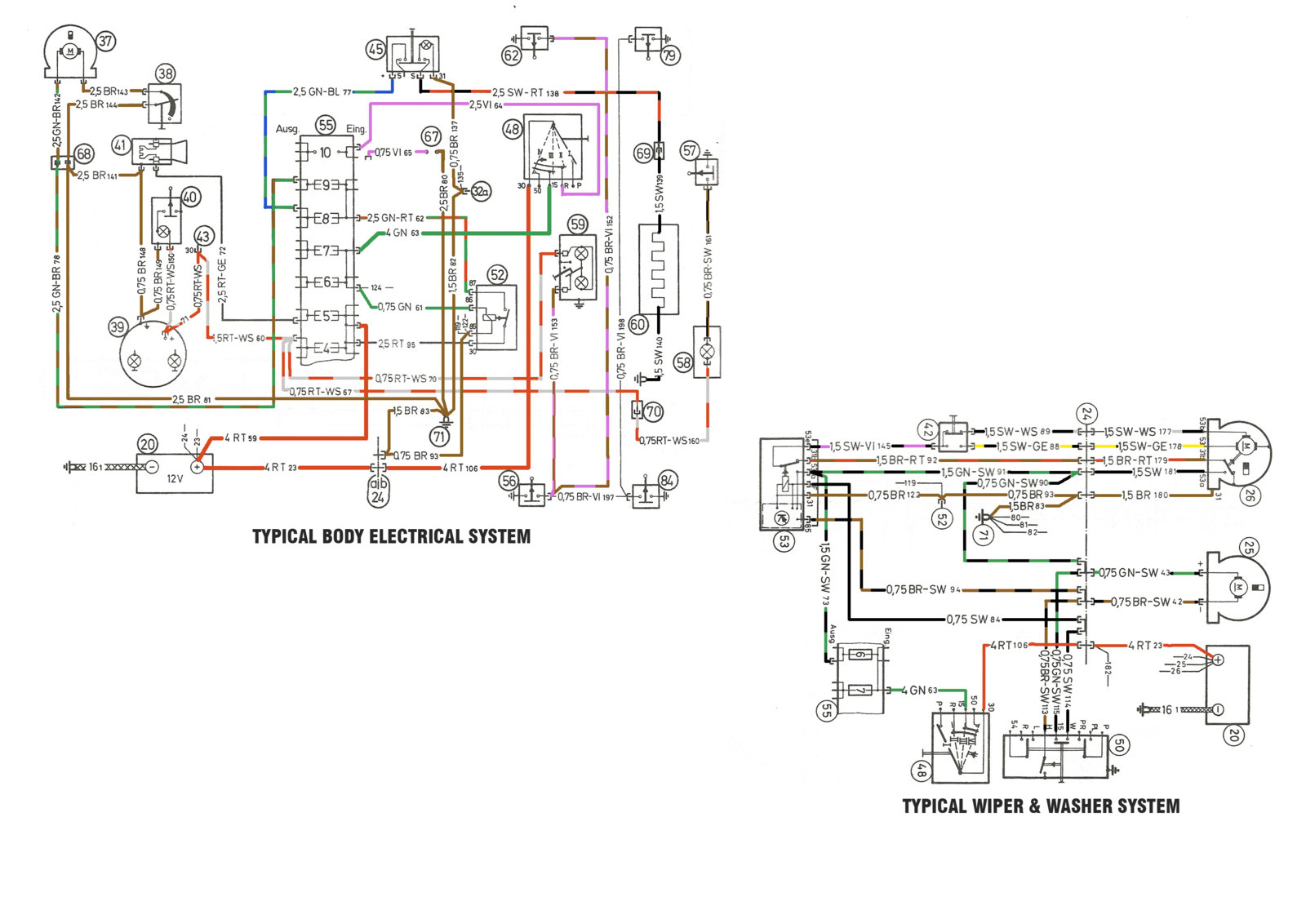

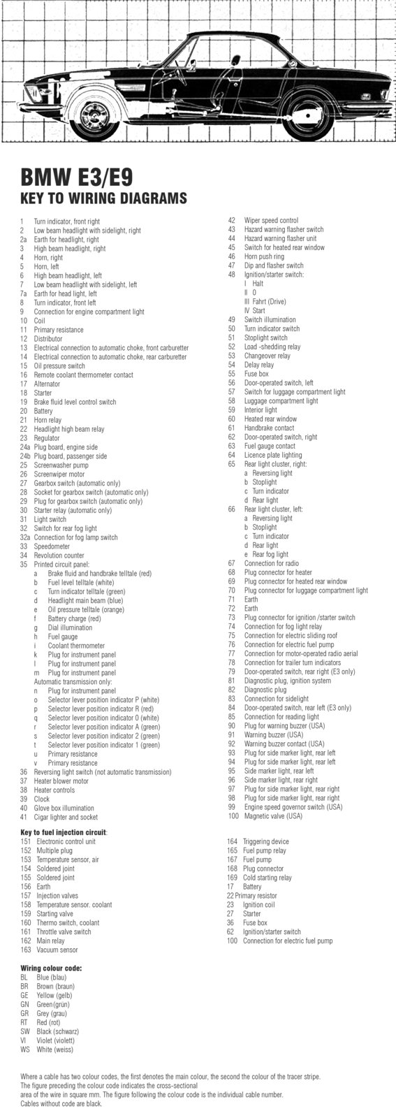

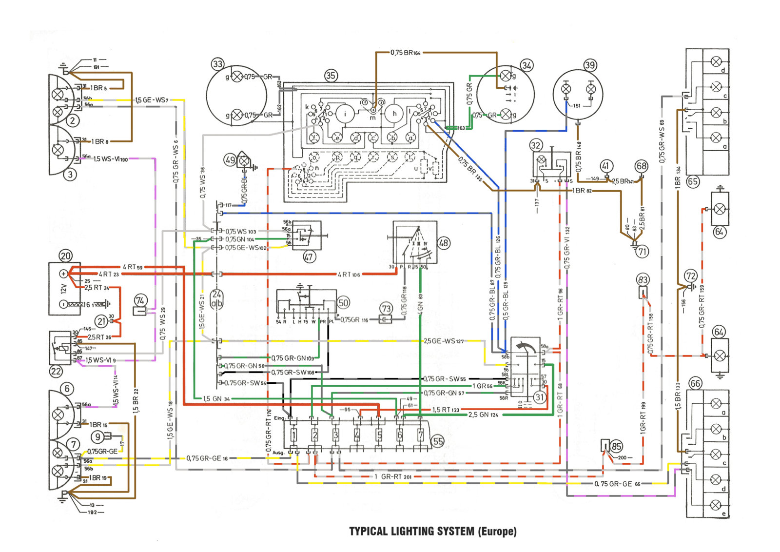

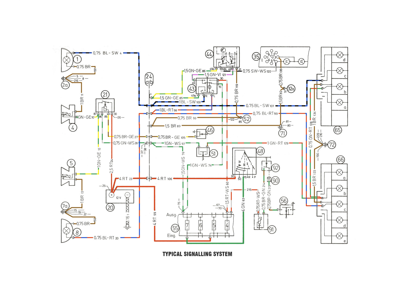

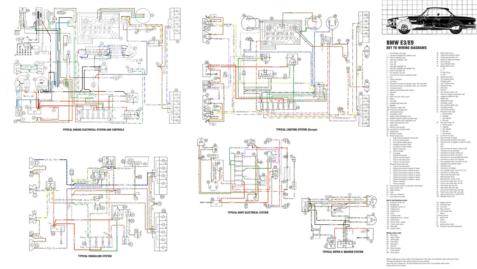

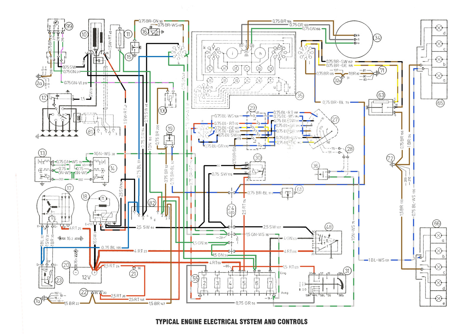

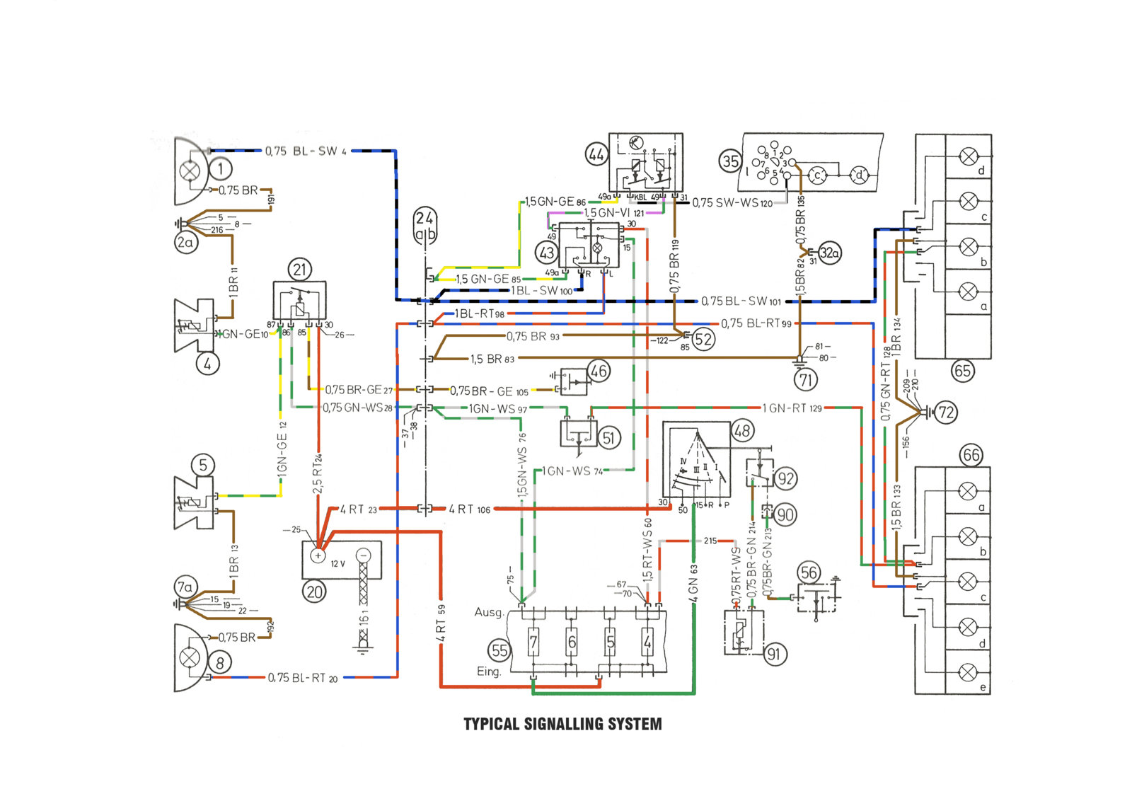

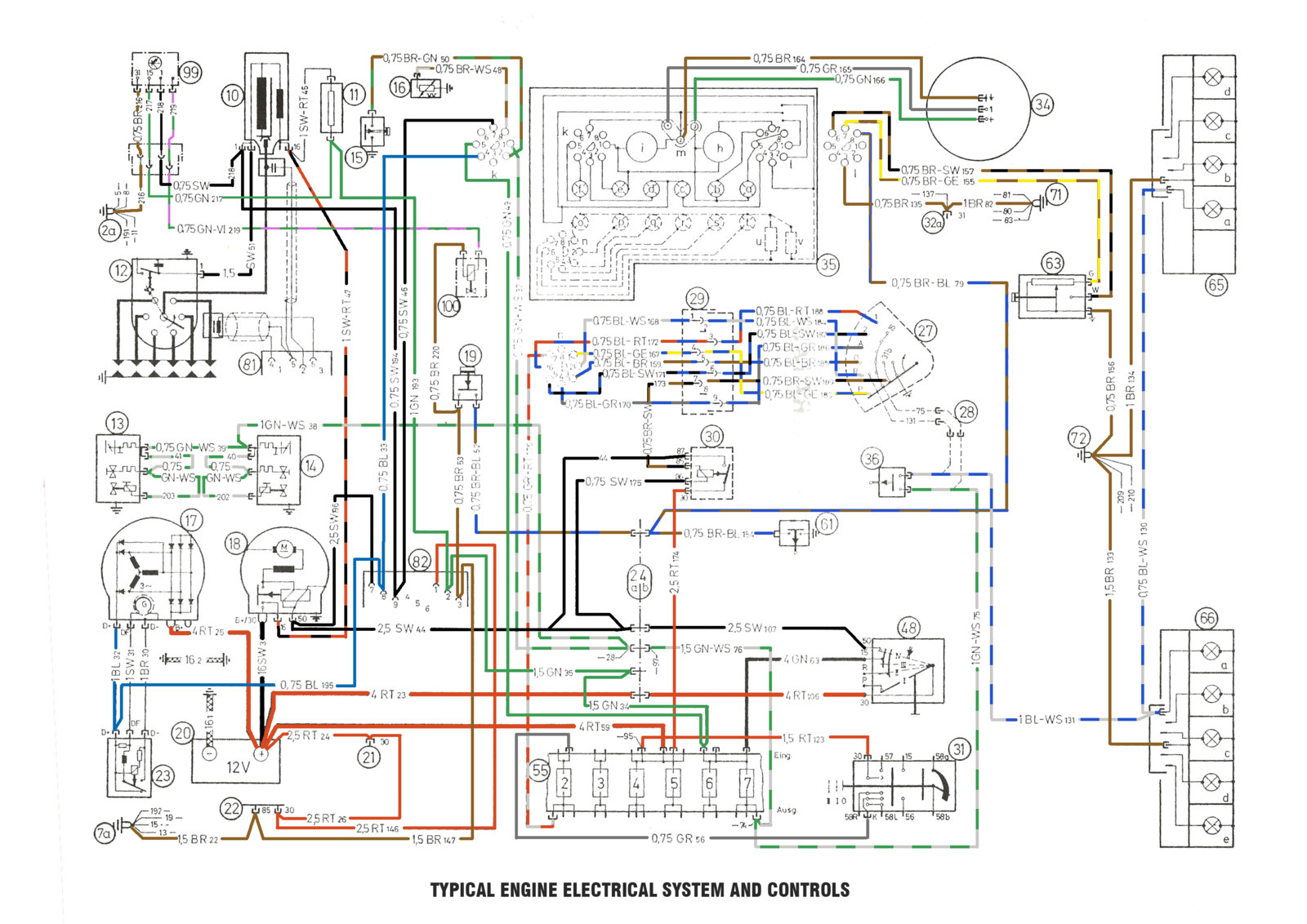

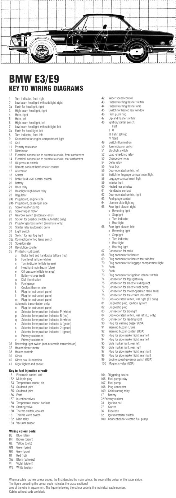

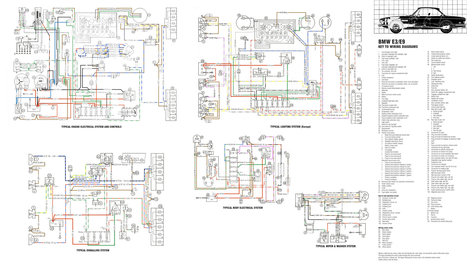

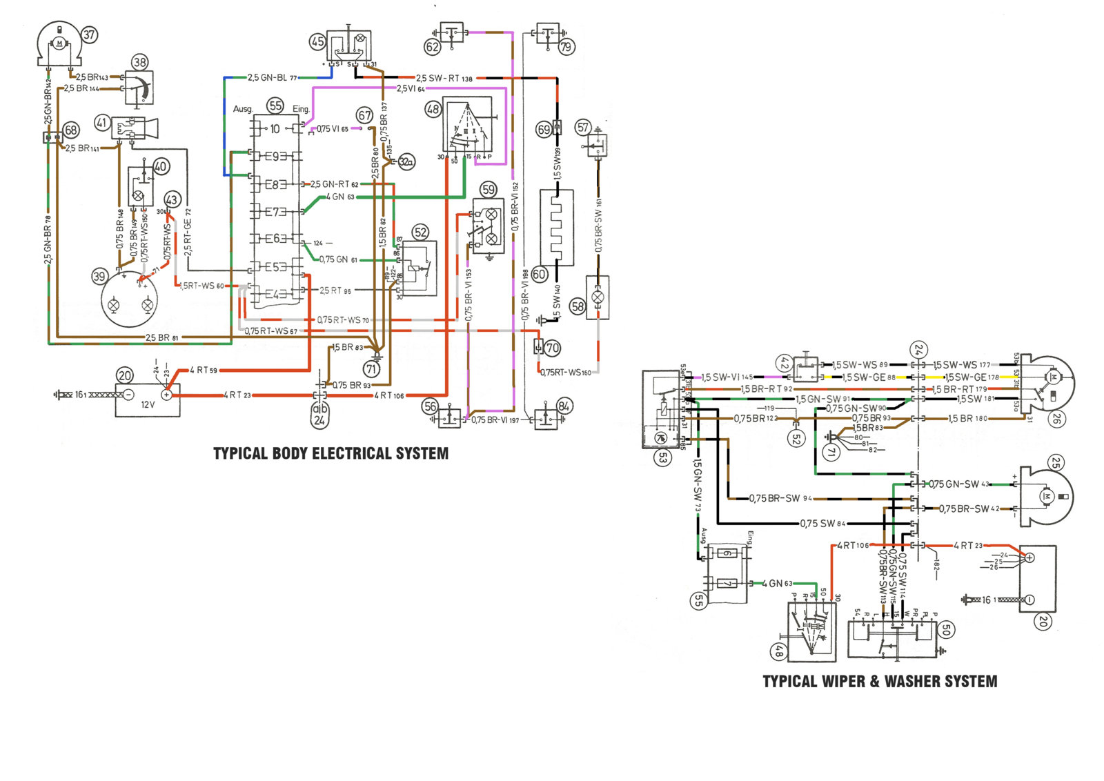

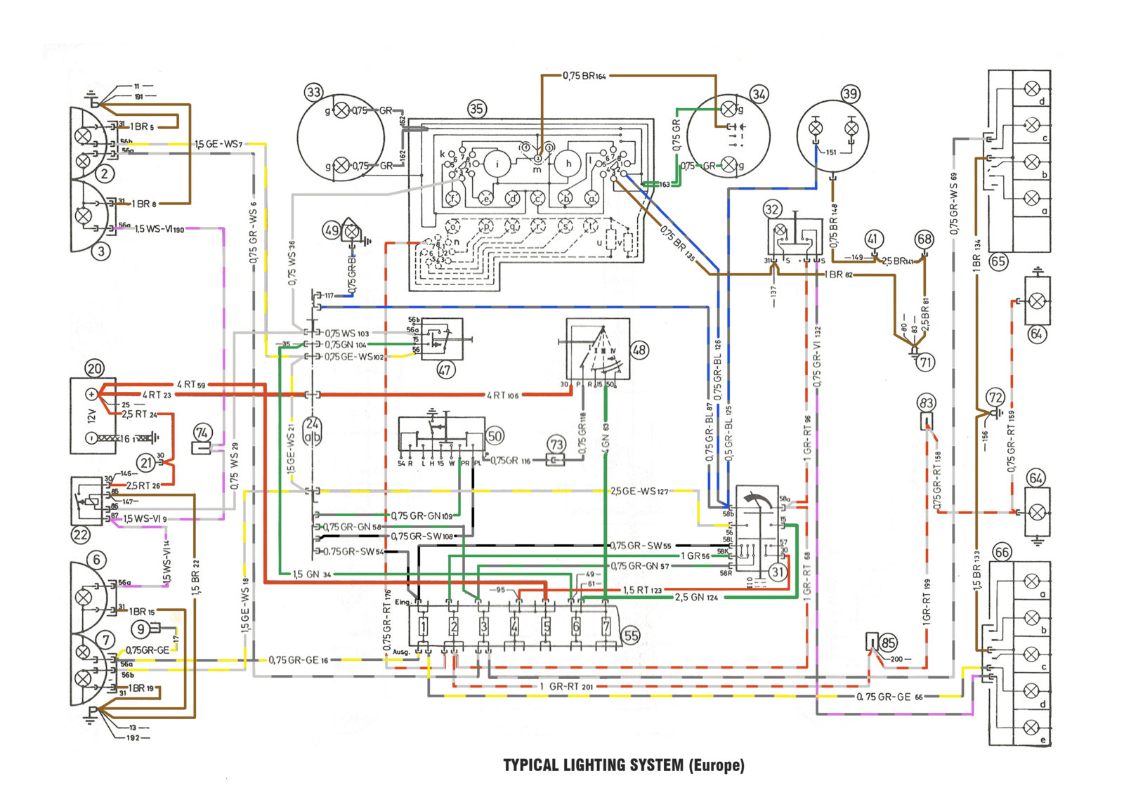

Here's a little Christmass present for all youn E9-lovers of the first hour...
As mentioned/promised a couple of days ago, hereby the complete elecric diagrams colorized.
I made them on one big sheet, to use as a poster in your shop.
But also as seperate printable versions. I hope you can use them.
The diagrams seem to display e3 instruments. It is hard to show both e3 and e9 in one diagram but could be helpful when comparing to the factory diagrams which can be hard to read. These are also pre 74 as well and don’t show electric window motors or switches. I lIke the added colors.
The diagrams seem to display e3 instruments. It is hard to show both e3 and e9 in one diagram but could be helpful when comparing to the factory diagrams which can be hard to read. These are also pre 74 as well and don’t show electric window motors or switches. I like the added colors.
True, there are a few differences, but overall the schemes are quite the same.
