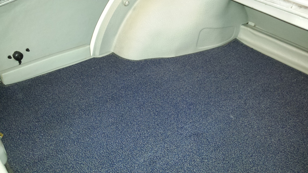

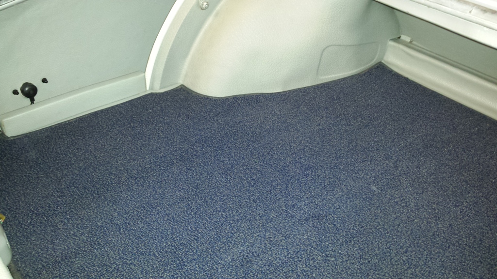

You can get quite aggressive with the carpets. I used woolite, a medium brush and lots of rinsing then hang up to drain out the water and then lay flat on an old (clean) piece of carpet or blanket to dry flat. Truly will bring back all the brightness. If you want to you can then spray scotchguard.
