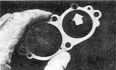

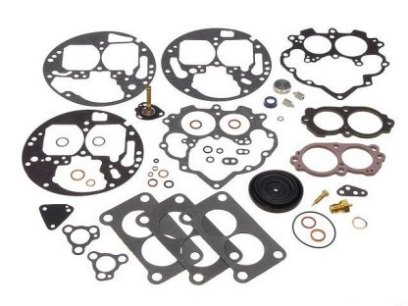

I visited the car this morning. They showed me the gasket that had been taken out of the carb. It had two small vacuum holes rather than a larger single hole as in the picture above. Are there different versions of the gasket? Here is a picture from the kit from classic garage. It looks like it has two different gaskets.
I'm no expert on Zenith carbs, so can't answer your question in detail. But I do know that including multiple, different gaskets in a set is pretty standard. To the manufacturer, the cost of the gaskets is low while the stocking and other supply chain costs are high. So if they include an assortment of gasket configurations, a single kit can service multiple variations of carburetors.
Is it possible that your mechanic used the wrong gasket? That is, if the kit included multiple gasket configurations to handle Zenith models A, B, and C, he grabbed the "B" gasket, but you have an "A" carburetor?
Yes, the kit has multiple gaskets that you will not need and there are such subtle differences between them that it is easy to use the wrong one.

Yes, you can easily use the wrong gasket. The carbs were also used on Mercedes and Unimog and those set ups are different than what Zenith did for BMW.
If it were me and I had to get it going:
1. The original gasket- Phenolic had paper gaskets shellaced to either side. DQ- look the other way. Order the real BMW Mercedes gasket.
2. The four bottom section screws have to be torqued like a head gasket. Slow, steady, and incremental. Snug and a little more. 5-7 ft. lbs. Then do it again. This is important.
3. Find the air bleed jet on top. Stick your finger over it with the car running. If it's lean- meaning there's an air leak, this will tell you without taking the carb apart.
4. Work one carb at a time. I've never found both to have a problem unless it was a fuel issue.,
