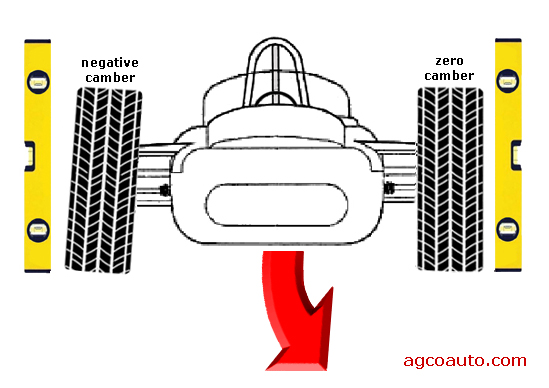

Decreasing the length of the control arm would probably result in a camber increase, or positive camber. Conversely, increasing the control arm length would result in negative camber, over and above the norm. The latter situation may not be ideal for tire wear but it might have a benefit in terms of handling.
As has been suggested, the "braking" or track rods are probably sized for each of the two control arm lengths so that if the wrong ones were installed, it might only be accomplished with a fair amount of force and/or by deforming the fore and aft track rod bushings. Since I have no personal experience with this, I would also guess that using the wrong sized or mismatched tracking rods would result in both abnormal tire wear and "squirrely" steering.:(
