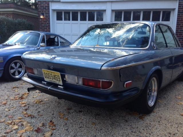

I found a ratty 2000cs bumper for $100 and did exactly what you describe. It turned out well.
I can post a picture tomorrow if you like.
Here you go....the center trim piece is smaller on the 2000CS bumper so not quite correct.
I sanded the chrome aggressively then used an etching primer and some bondo on the dents. The inside was rusty and that's been coated with POR15.
