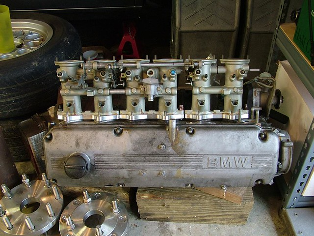

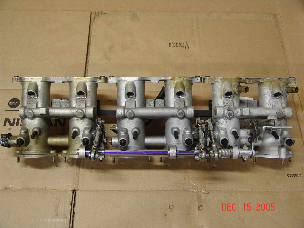

Here's a pic of the points on a S38B38 set of ITBs. You can see the 2 brass fittings on the upper right of the ITBs.
Here's the older set mounted on a M30. Notice it does not have those brass barbs.

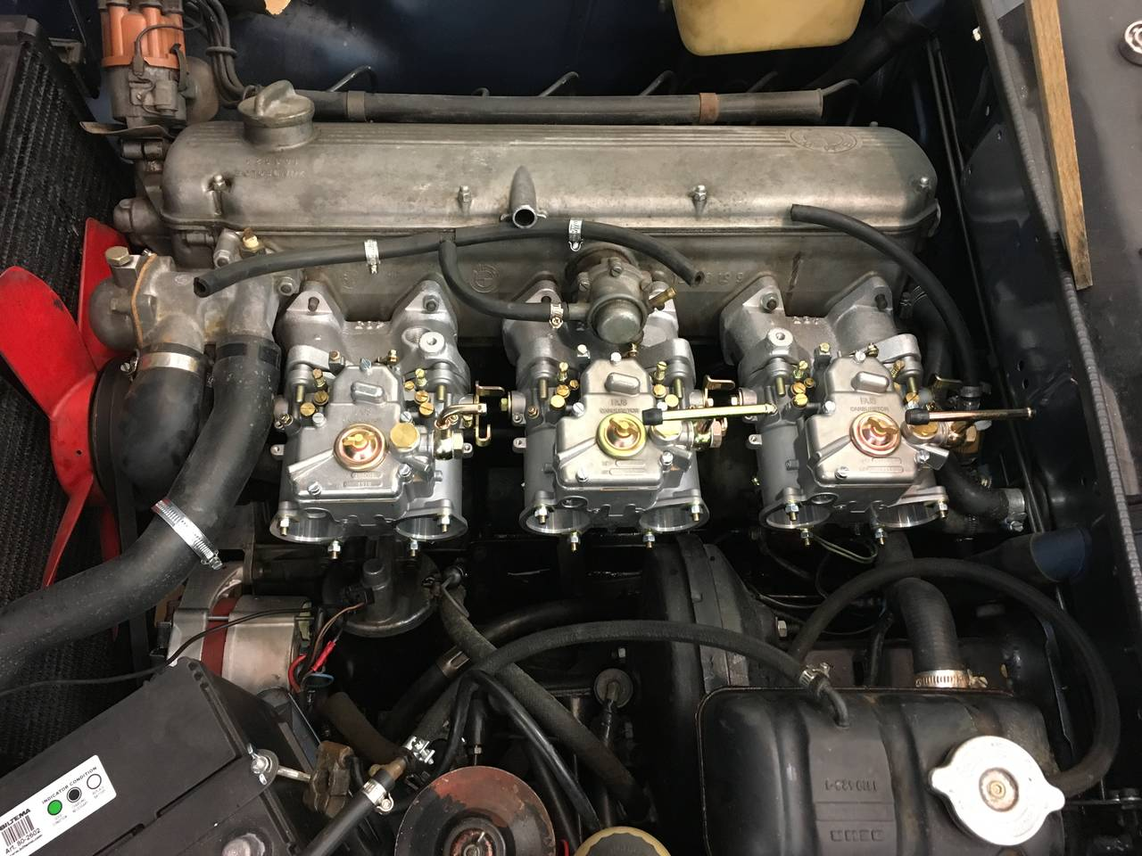

On my triple weber manifold I only use one cylinder to run the booster - no issues.
On the M10 cars with dual side drafts (1600ti,2002ti) and the 2000CS, BMW only used one of the four intake manifold ports to connect to the vacuum brake booster.
I have a Korman intake manifold on my Triple Weber setup - and like Steve's VGS setup, it runs the booster off a single cylinder.
