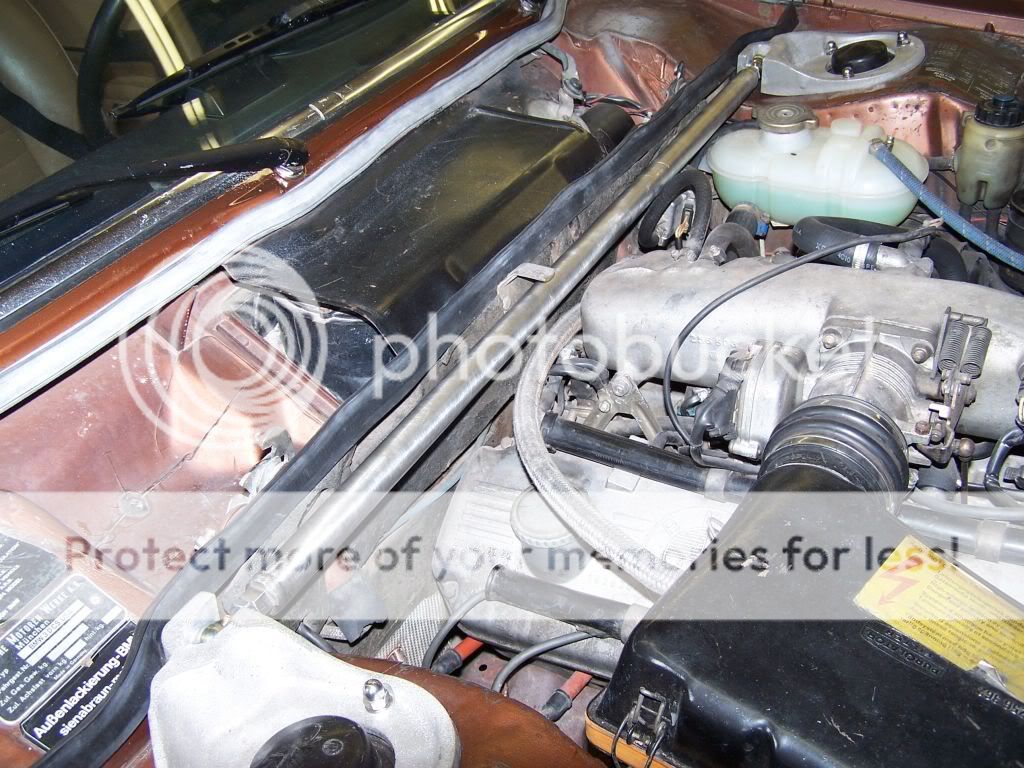

Why is the hood yellow inside the holes where it is visible? Did the CSi's have a brake reservoir that sits on the master cylinder? The regulator should have a green or yellow tape around it's base, this one looks black? Just wondering.

Global Grooves--a friendly suggestion--if you are asking about a US spec car there will be some minor differences--so being specific as to your particular E-9 will help in answering your questions--as "one size doesn't quite fit all"
Sorry but kitty stepped on m keyboard to add emphasis[[[[[[[[[[[[[[[[[[[[[[
Yes indeed it s a 73 CSL right drive, built Nov 1972, its has 2 brake boosters which have 3 main components the valve body, the parts thats holds the small diaphragm and the booster part, all with different finishes, and i am want to make the car concours correct, so any advice is welcome.
