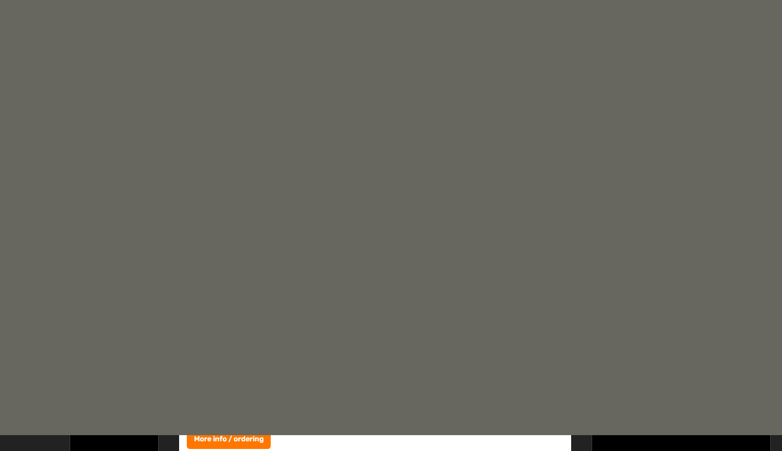

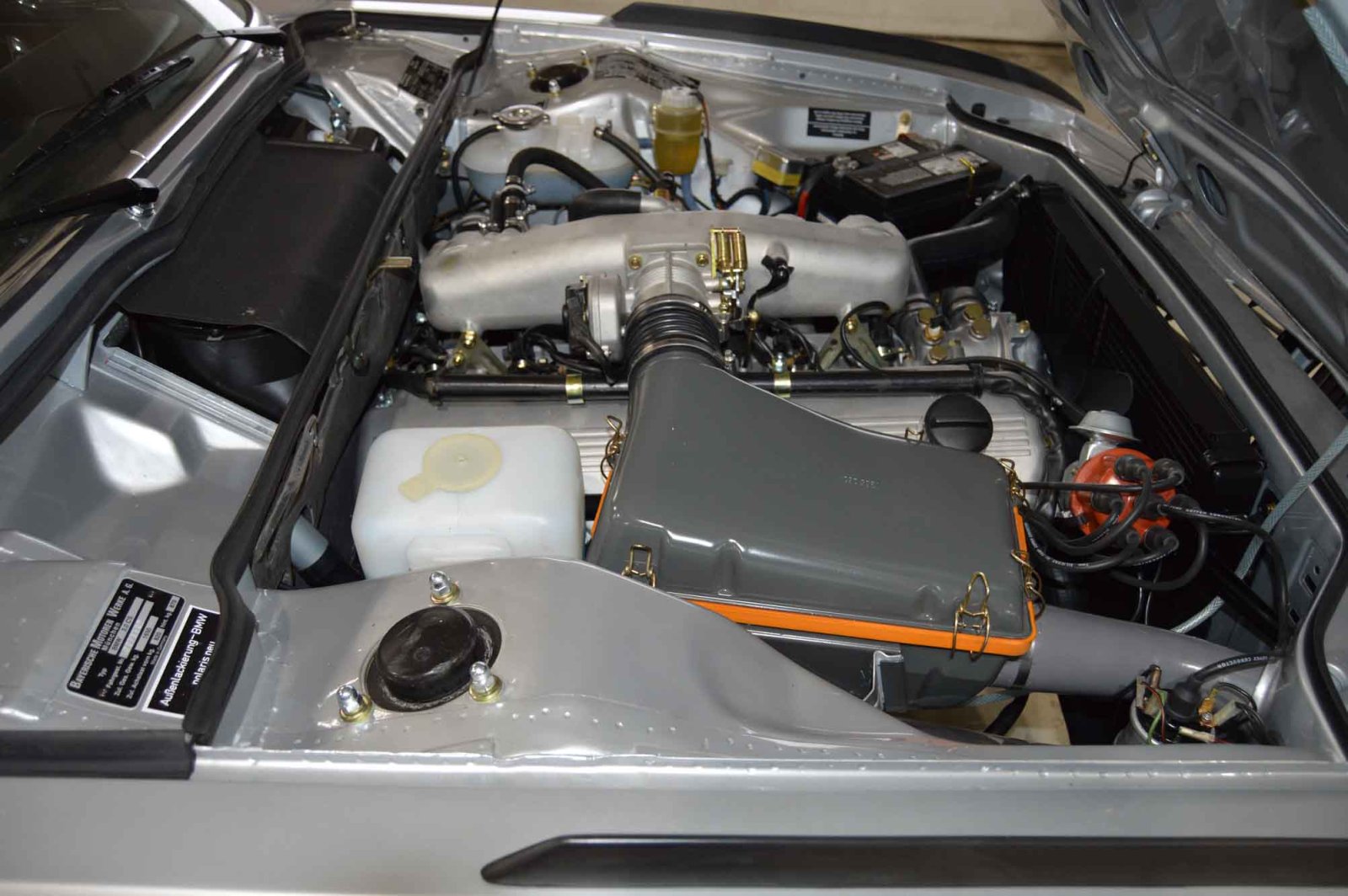

okay, according to information that i received while doing the 'FAQ - what color goes where' on a coupe, the air box color is listed as close to RAL 7022 (Umbra Grey). so here are some pics - what do you think?
ral 7022
here are a couple of CSL air box pictures, one is an older (excellent) restoration
the other is a more recent restoration from a 'noted' restorer
i think we would all agree that these are different colors, but are a grey with some green in it.

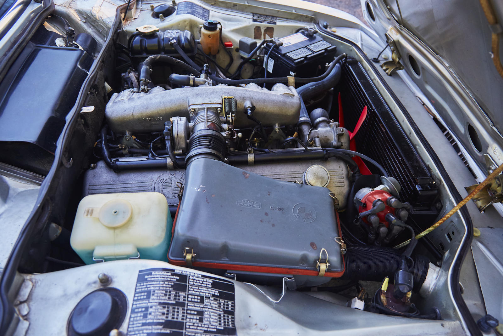

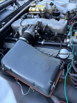

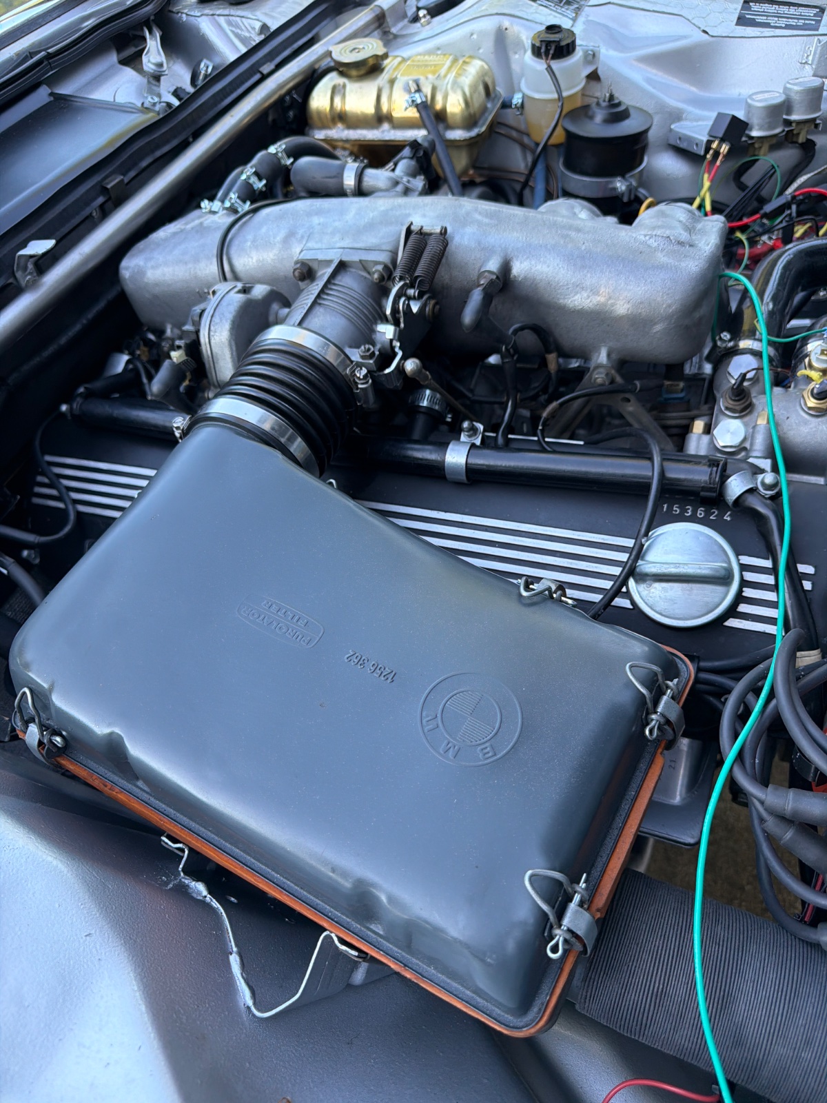

Looking at mine (which looks original and not repainted) it does have a green undertone to it that the 7022 doesn’t seem to capture. Always hard comparing a screen to real life though, but the 7043 seems the closest.
(Note that I decided to use that brassed radiator tank in lieu of my black-painted one while I had the radiator apart to install auxiliary pusher fan. Excuse the random wiring / temporary position to make sure the fan works. I’ve learned not to tuck everything away pretty until I’m sure it all works!

yes, that's what my notes show. in looking at the pictures + ral color charts, i would think either 7022 or 7039. here's another pic of the polaris car and its either 7022 or 7010
this is 7022
this is 7010

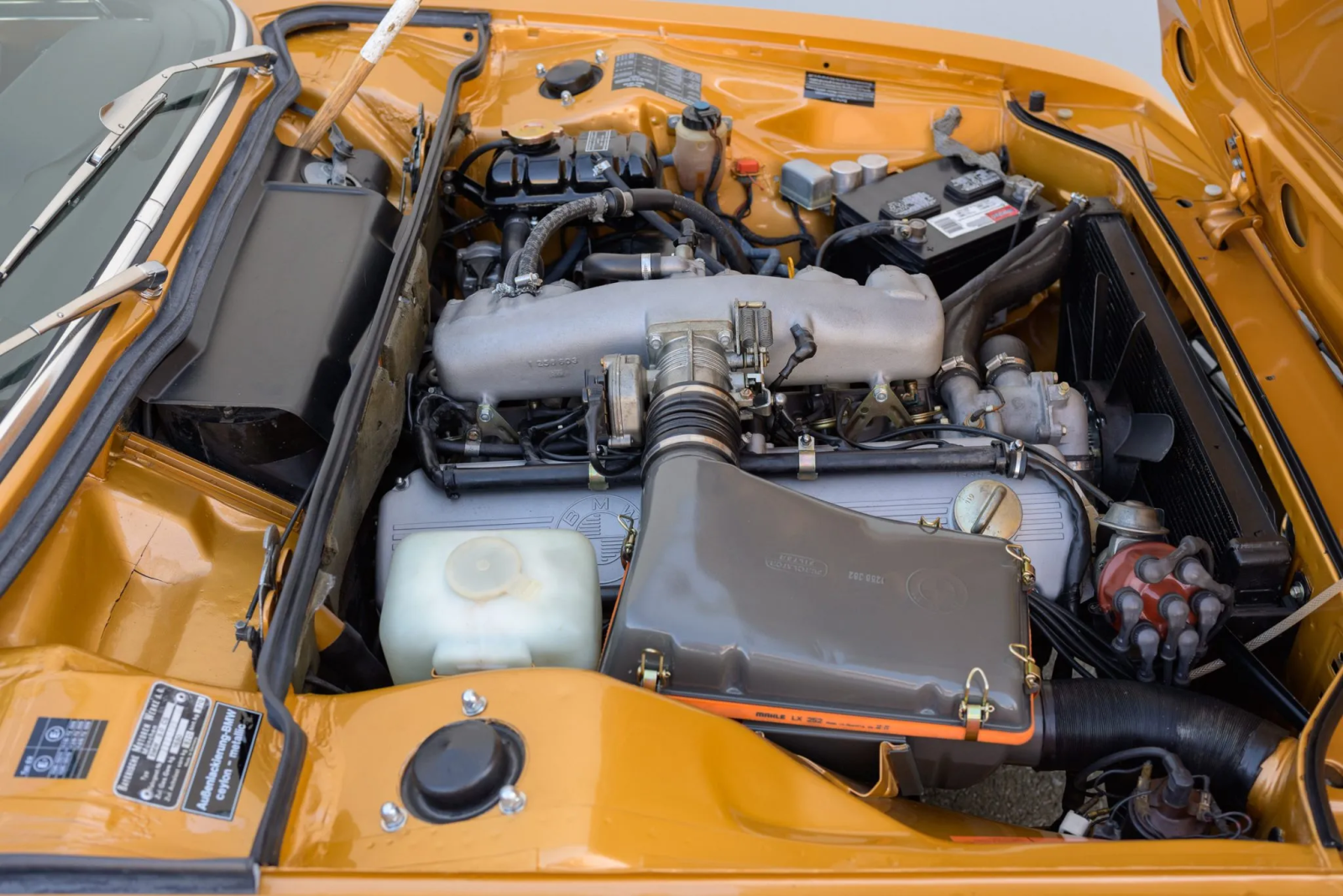

then there is the picture of another unrestored CSL - this one looks a little bluer of a grey
and another golf CSL
and a nice ceylon 3.0 csl - may have been refinished.

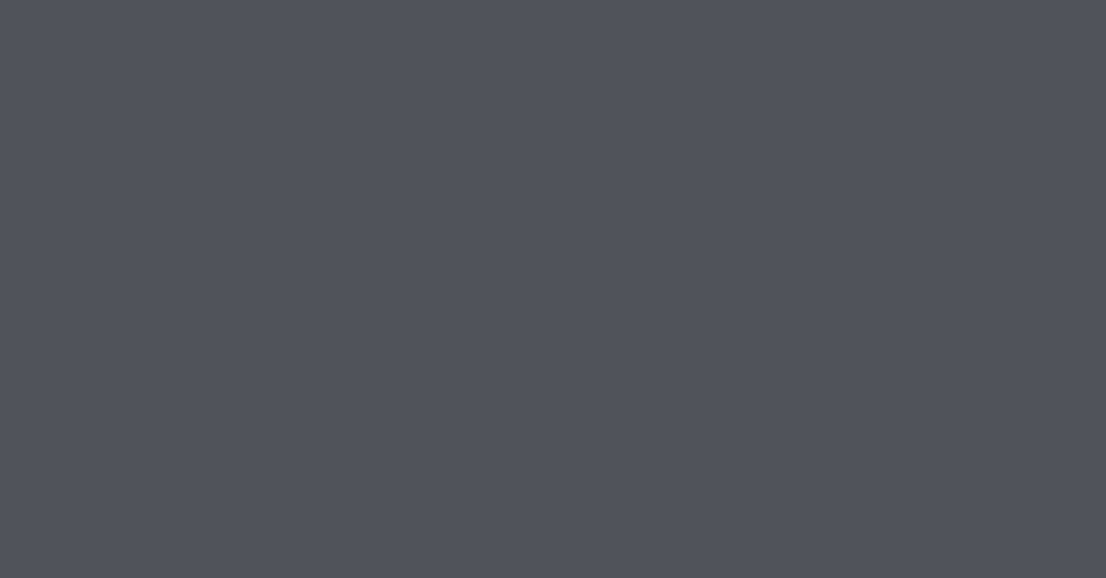

this 7015
this one seems to match 7012 or 7015

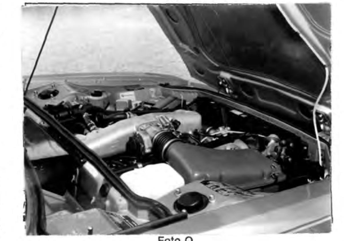

Grp 2 Homologation Doc:

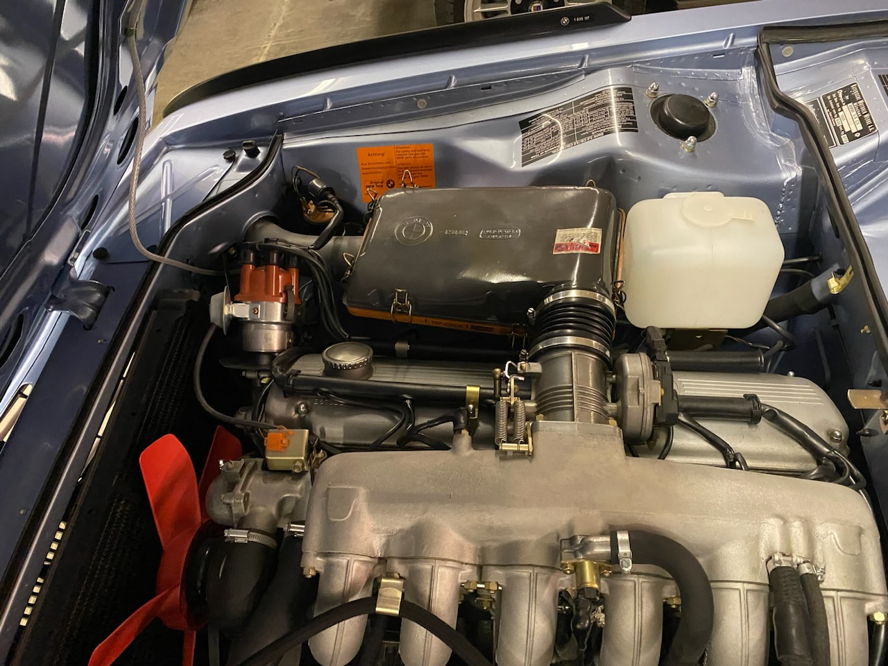

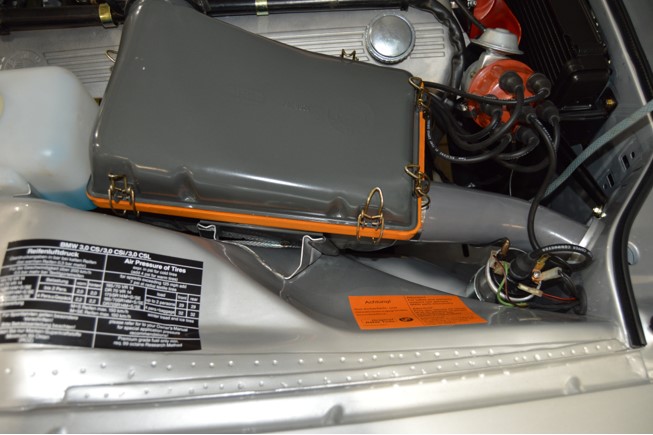

what i can tell you is that @Gerrit was involved with the restoration of this car. so this is the best image i have, and i saw this car in person ... yes, its indoor lighting so that can alter the reality.

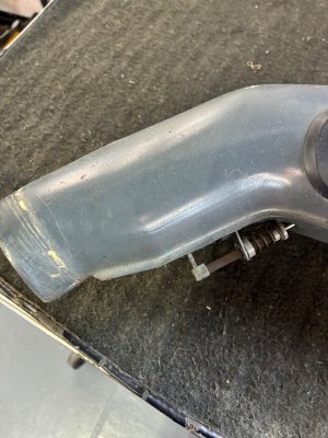

here is another question about the CSi / CSL airbox. anybody know at one point when the clamps turned from flat stock to the rod stock. i know you can still buy new clamps made from rod stock, like the 1st picture ... but the boxes being sold by @TomHom have the clamps made from flat stock like this image below. the other cars with the 'rod' stock are restorations - both are Bat2 cars. the one below and the ceylon car are 2275xxx cars

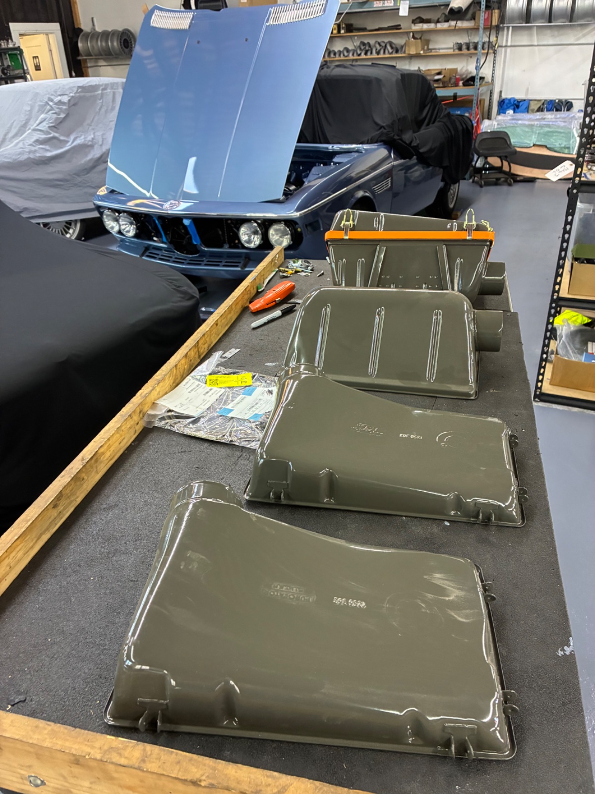

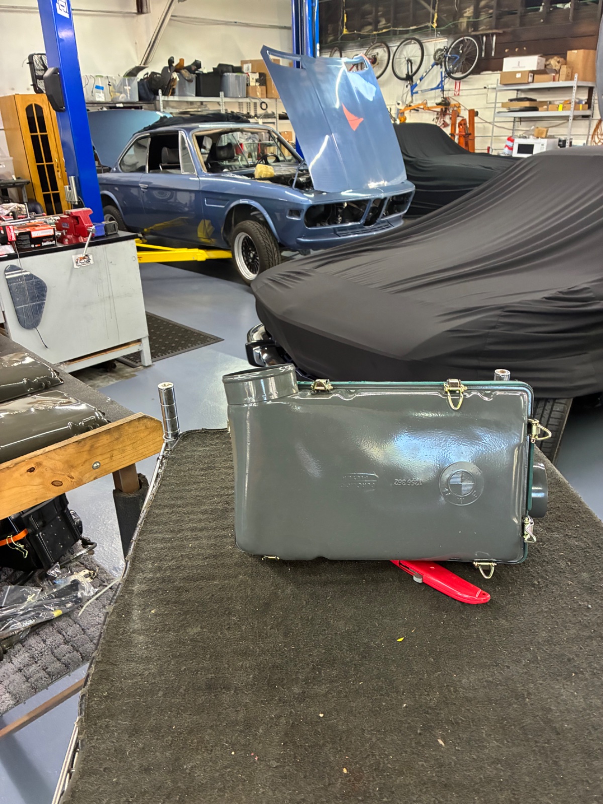

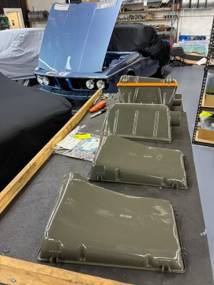

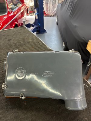

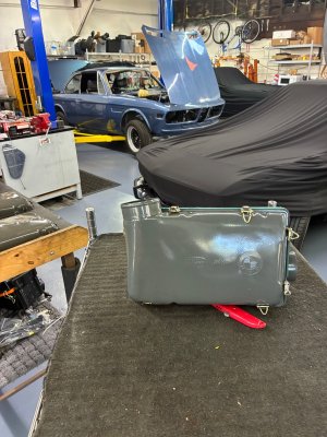

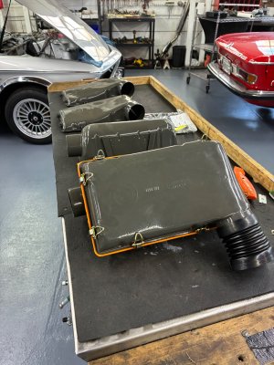

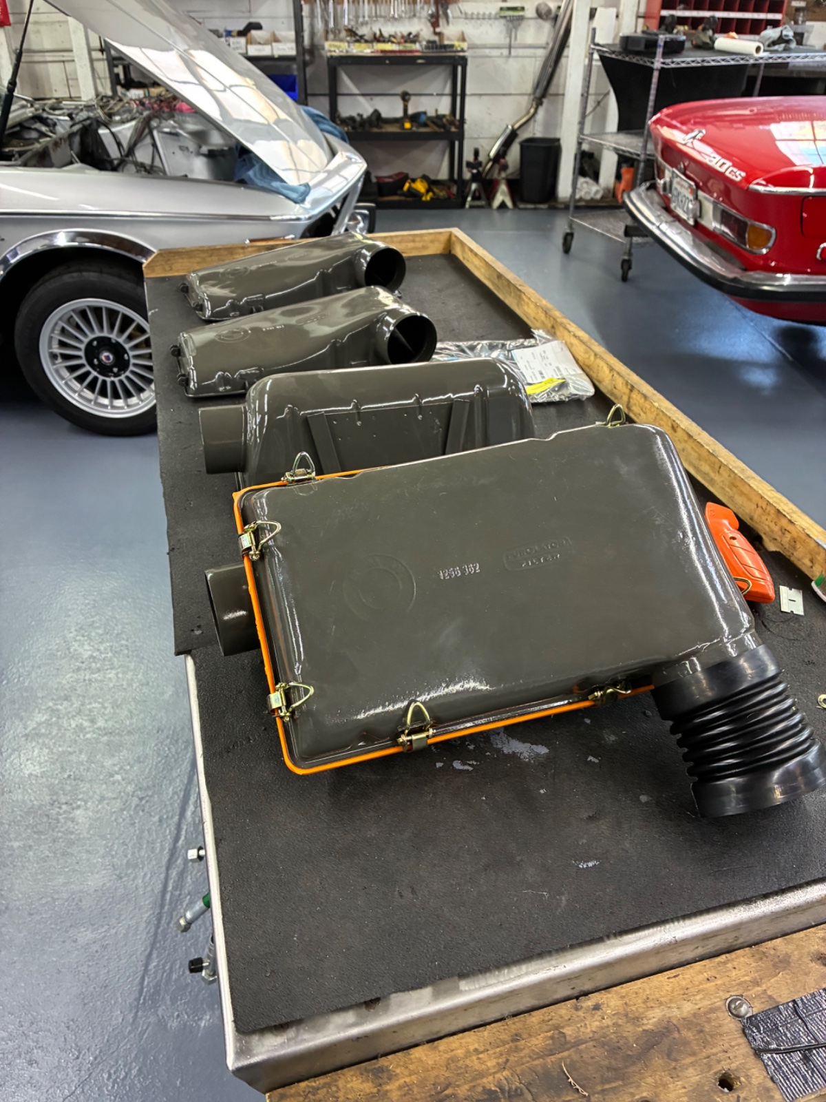

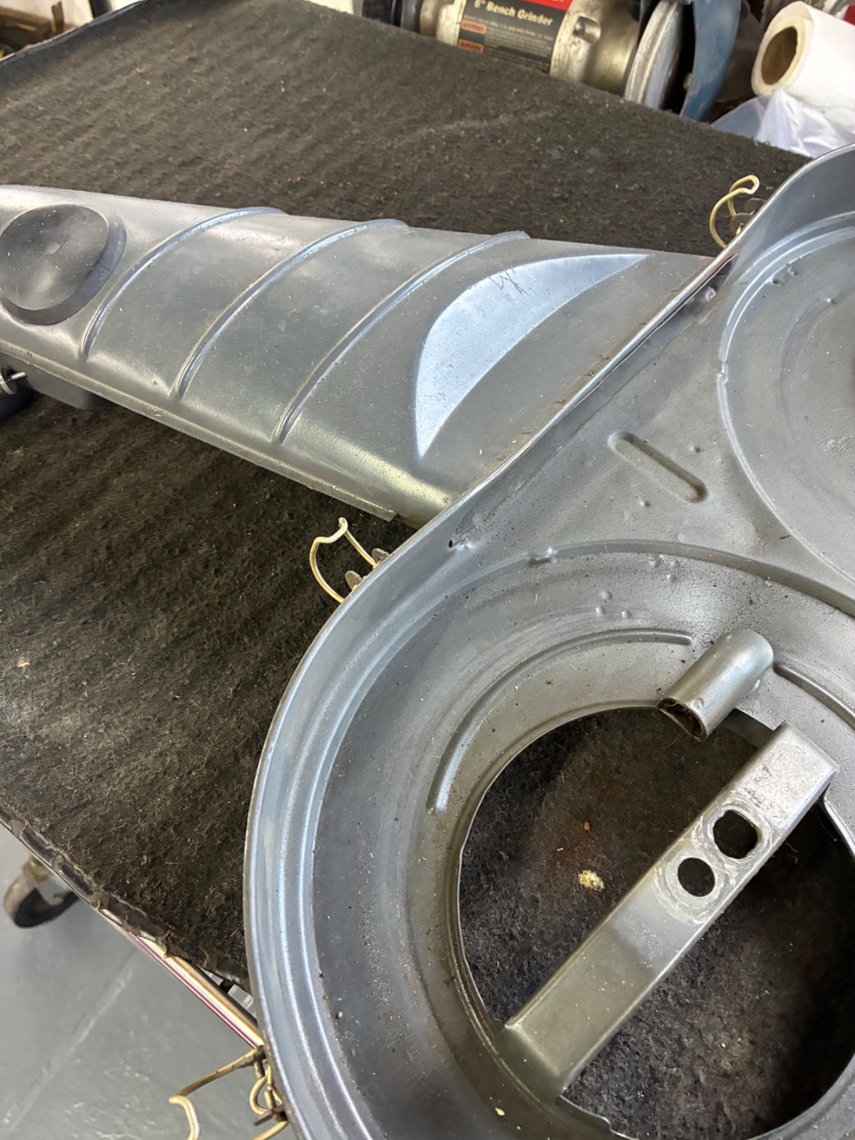

Ours are done in RAL 7022
BUT - we sometimes see one come in with a gray color to it

Almost all of the restorations use the rod stock. As you can see they were flat stock in August 1972.
the color looks great Don ... even in the shop lighting there is variation in the photos depending on the orientation of the panel. the more vertical the panel is, the less 'green' it is. but this answers my question - 7022 looks great and close enough for me.

the ceylon 2275 car has been restored and still has the flat stock clamps + the ones that @sfdon has redone has the flat stock - presumably re-zinc'd. i haven't seen any original pics of a bat 2 car to see whether the rod stock or flat stock clamps were utilized. not really an issue, just a curiosity which the bat 1 + bat 2 cars came with. the airbox i am buying has the flat stock clamps - i have some of the new rod stock ones on the way ... for an e28 air box ... but only 4 of them, not 7 that is used on the CSi / CSL box. i will take the ones i get and have them re-coated in yellow zinc.

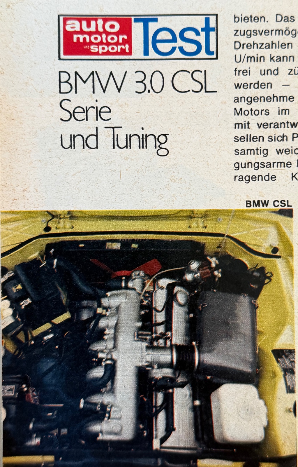

Unfortunately BMW pretty much never has photos of their engine bays in their brochures. Road test magazine are the best option but if it is a b&w article forget about it.

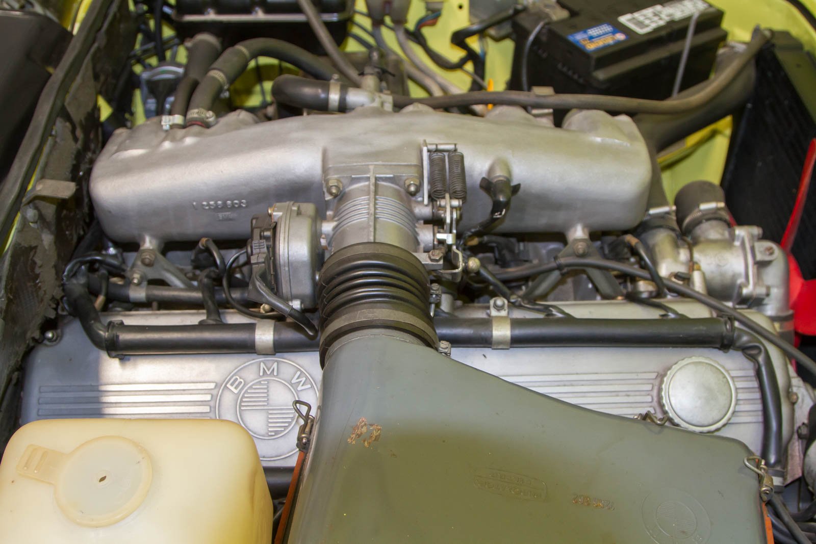

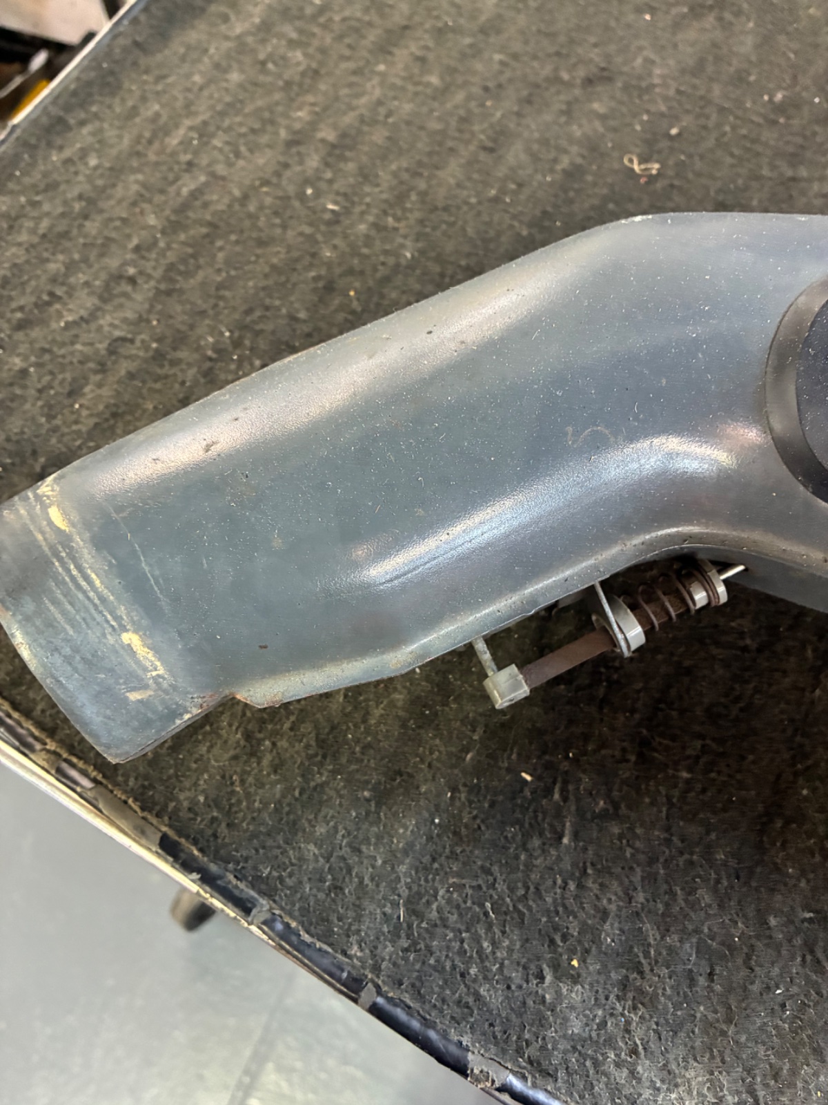

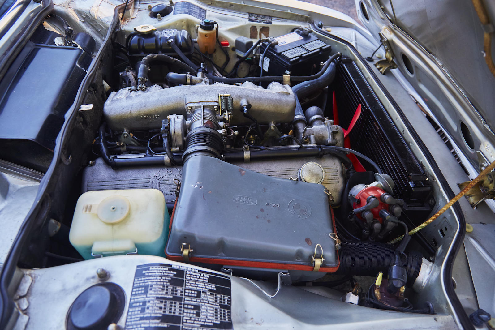

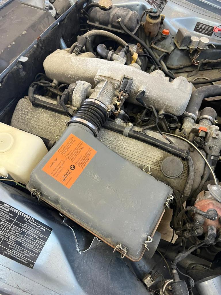

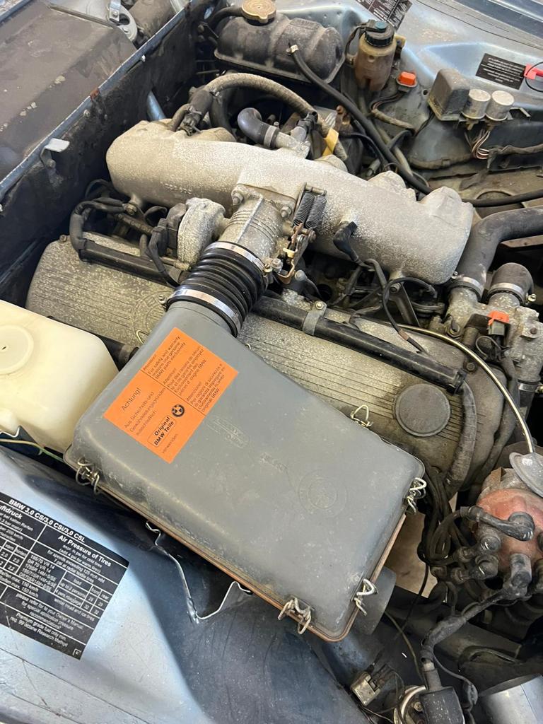

This is the color that I’m trying to determine if factory. This car doesn’t really look restored.

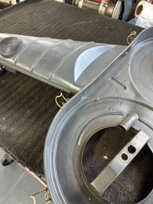

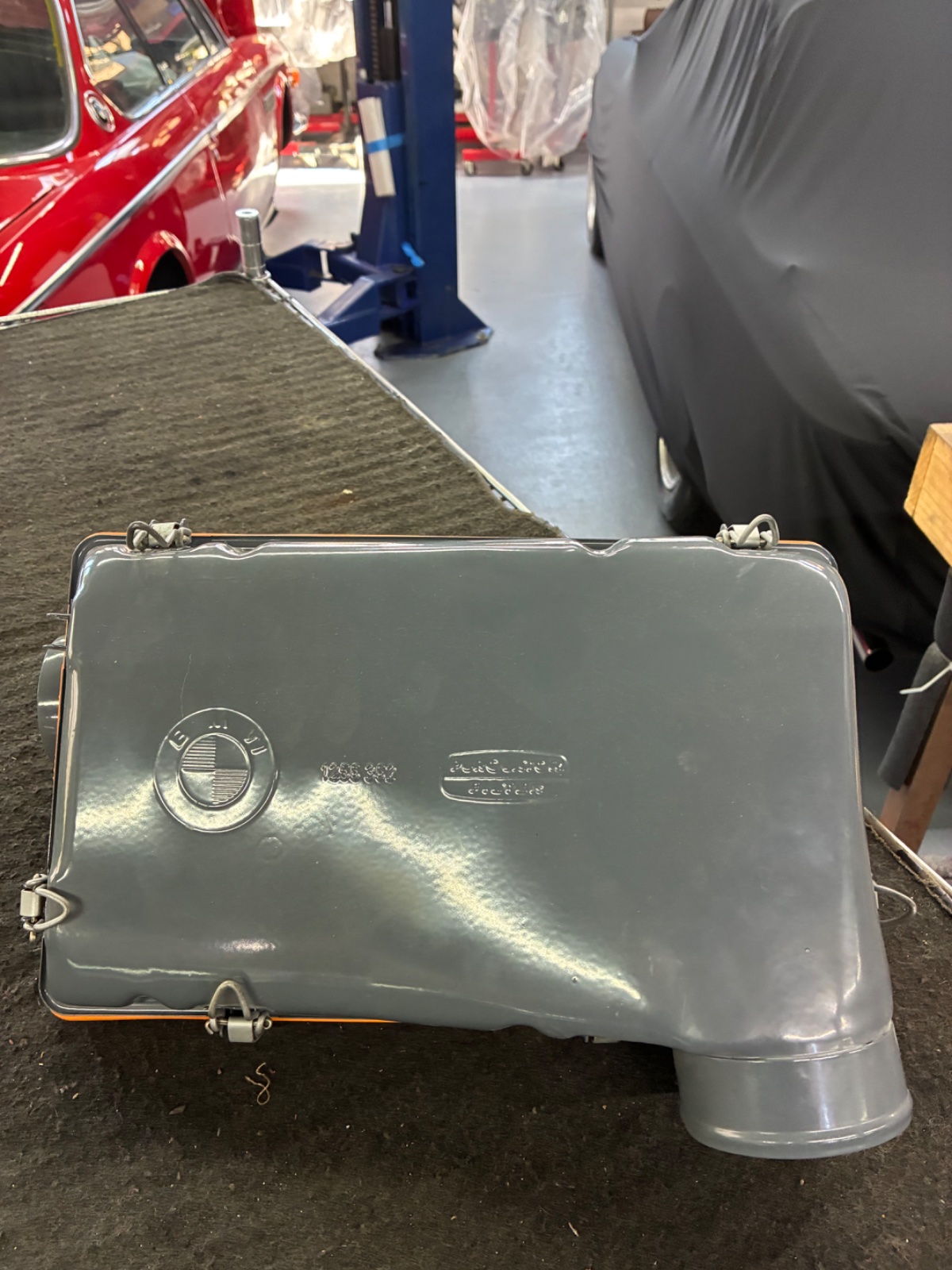

Look inside the box- never mind the outside.
Same goes for the carb version- look inside.
If the box is blue inside, it would be blue outside
no, it doesn't look new. but it does have the rod stock clamps.
The flat clamps were not on the US 3.0 coupes starting in summer 1971 as 72 model year. They were on all 2800CS.
yes, but with the CSi / CSL that was after the 2800cs.
