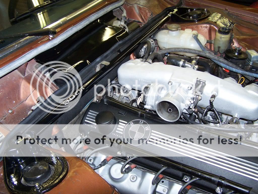

There are still several experts around so don't be worried about not getting help if you need it. Besides, the FI engine inlet manifold looks so michcooler than carbs!

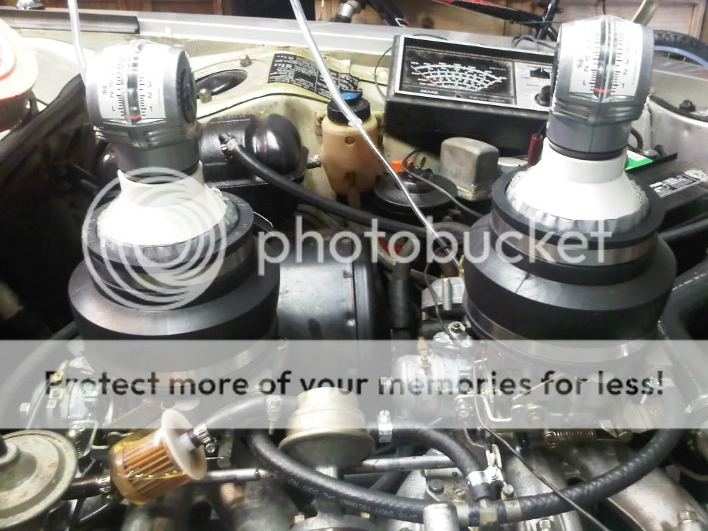

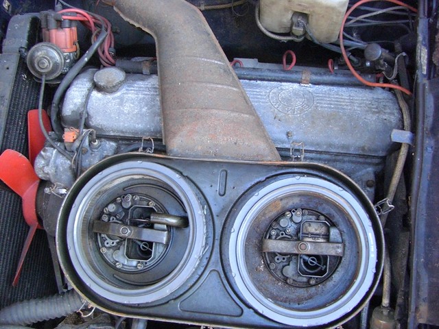

Here's hoping the djet parts remain available. :shock: But if you follow Bill's advice, it's not just the carbs. Don't forget manifolds, throttle linkage and filters. ;)
For simplicity sake (not originality or performance) there is always the single four barrel and single manifold package. It may require less closet space and there are less parts to get lost. :?
