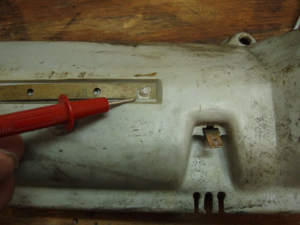

The problem with the rear lights was intermittent but the light would not light using the "wiggle" test. Took it apart and found this
Corrosion between the ground strip and the rivet. The rivet connects to the ground wire on the front side.

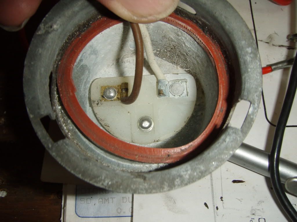

Also, during my exercise to find out why the high beams didn't work I found this
As can be seen, again I have corrosion between dis-similar metals (the wire and the rivet) in the fixture for the bulb holder.
The solution I think I'm going to pursue is to drill out the rivets, clean the connections, and then replace them with 3mm bolts and nuts of the appropriate length. I'm pretty sure this will work, I've done it on previous restorations.

+1
+1 on the rivet problem at the ground strap.
For those sufficiently energetic, remove the tail light assembly, drill out the rivets and as stated above, replace with a small brass bolt and nut, or brass rivet. Good luck finding those.
