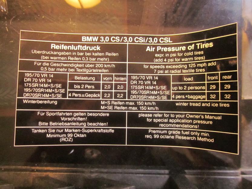

Wondering where on Athena this sticker goes. :confused: It's 3.5 x 6.75 inches. Any help is appreciated.

Mine is euro CSI and it is definetly inside fender well. Not sure which side....memory says drivers side.
Someone will have a picture, good luck.

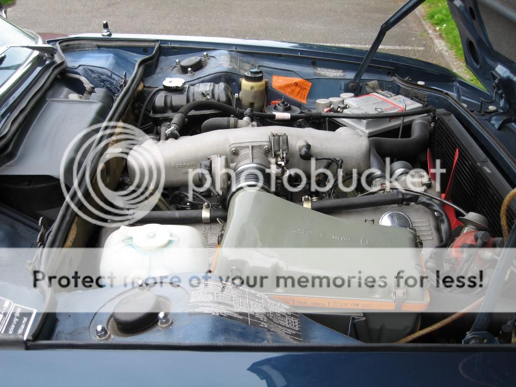

My friend's RHD CSL has the one pictured located near the strut tower (engine bay ).I can get a picture for you next time I go to his house if you like ...as an aside, I was bemused when I saw the bit about adding 7psi if you're driving over 125 mph (!)

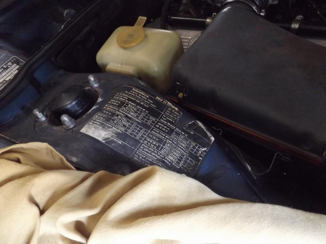

Tire sticker
1972 CSI Italian delivered. Added bonus of seeing how nice your car is in comparison.

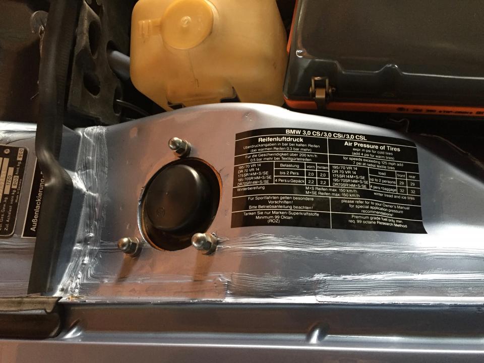

Thanks, just what I was looking for! I'll post a pic once I've installed it. Mine was built in '72 and delivered to Italy as well, titled as a '73. :smile:
