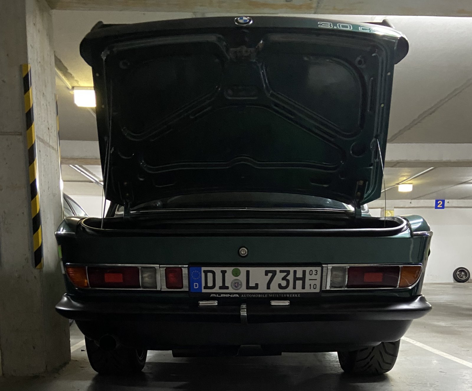

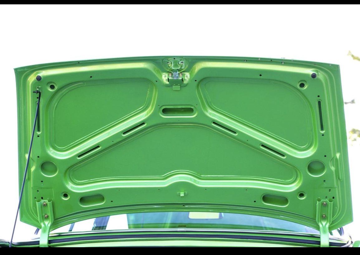

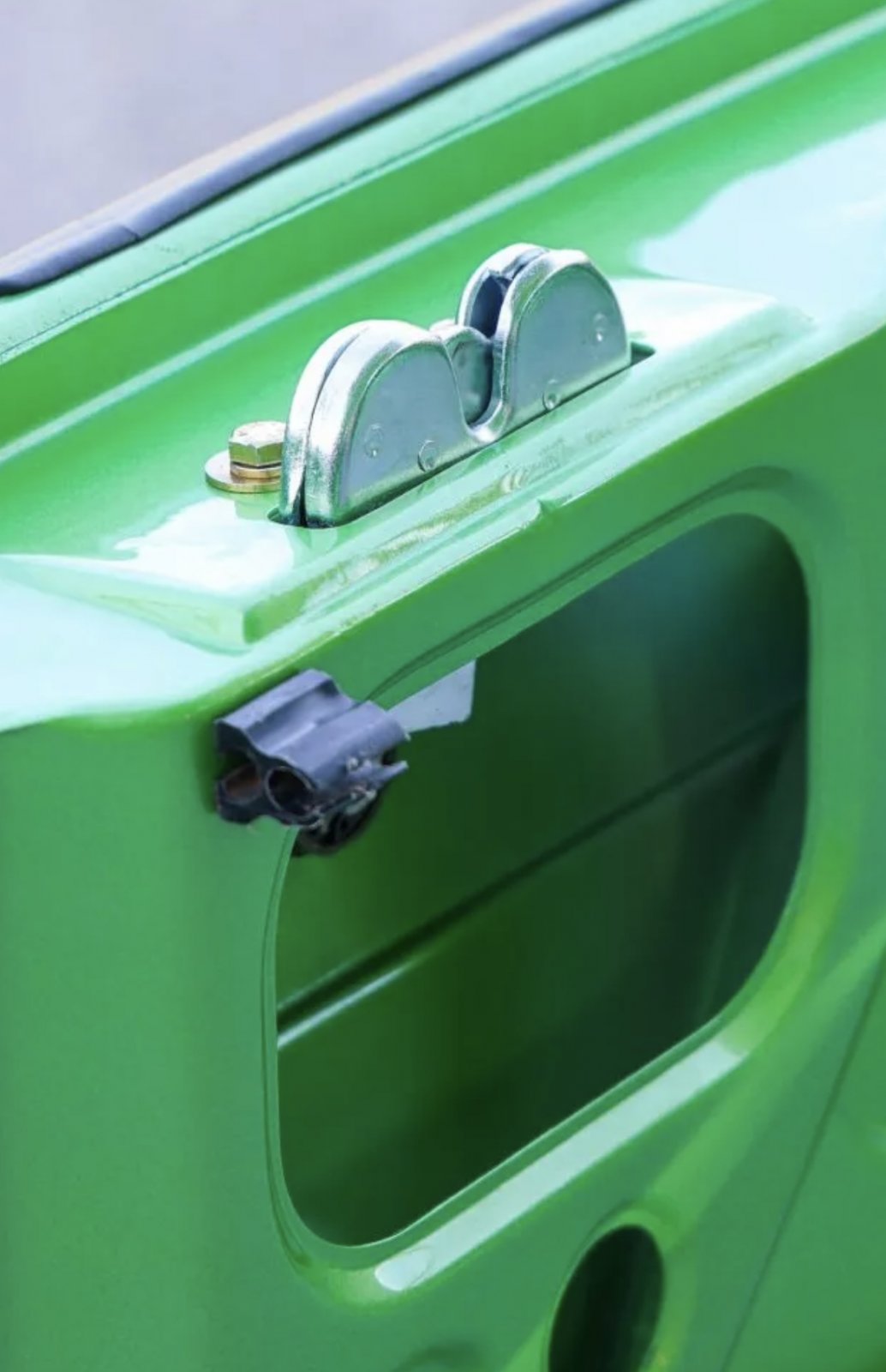

So that means that this CSL which was on BAT is not completely original with this solution of holding the boot lid?

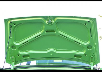

Thanks Keshav! So this rod was not used in the 4355xx CSL versions? That is then because of the Batmobile package and thus weight of the boot lid, correct?
Although the rod infact holds up a steel trunk with big wing…… just needs heaving the trunk lid, lol!
my understanding is that the Bat1 + Bat2 CSL used the torsion bars in lieu of the prop rod as they had a steel trunk lid to support the wing forces.
The torsion bars were only to ease opening the trunk lid, nothing to do with wing forces, just like the torsion bars for all other coupes.
i got that one, sorry if i wasn't clear, the steel lid was to support the wing load ... the torsion bars were just about the opening / closing of the trunk lid.
