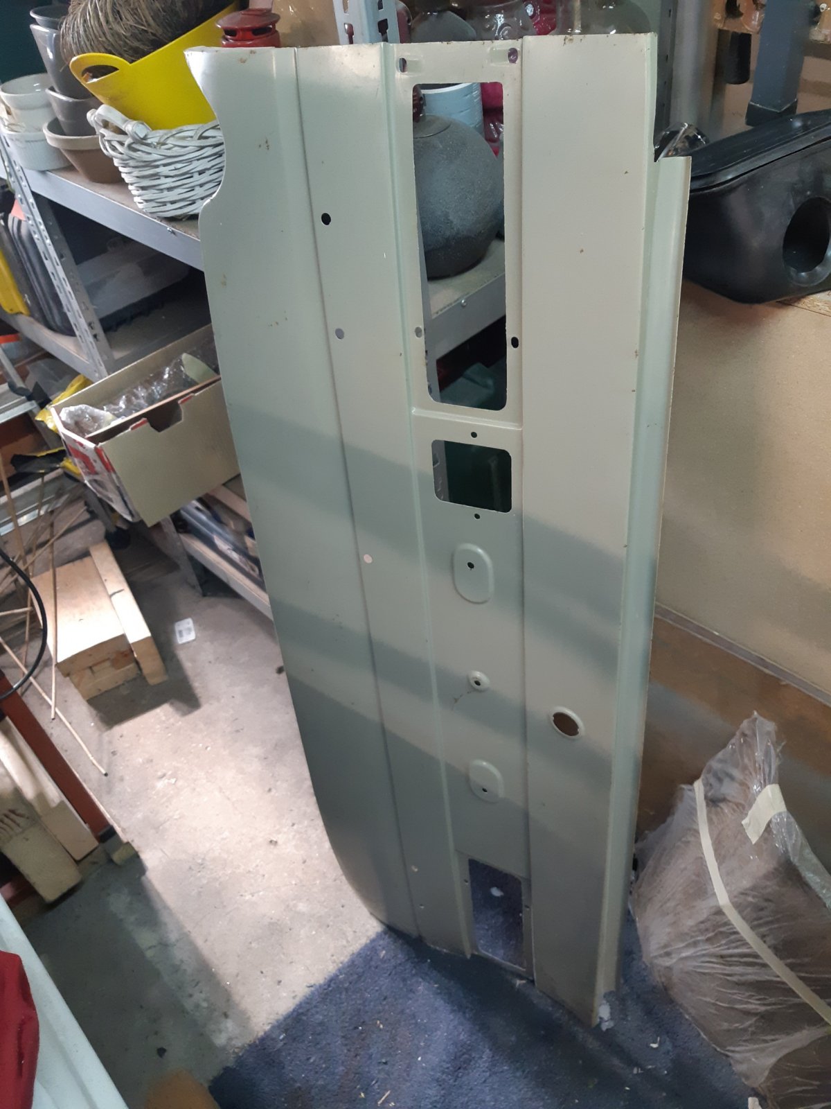

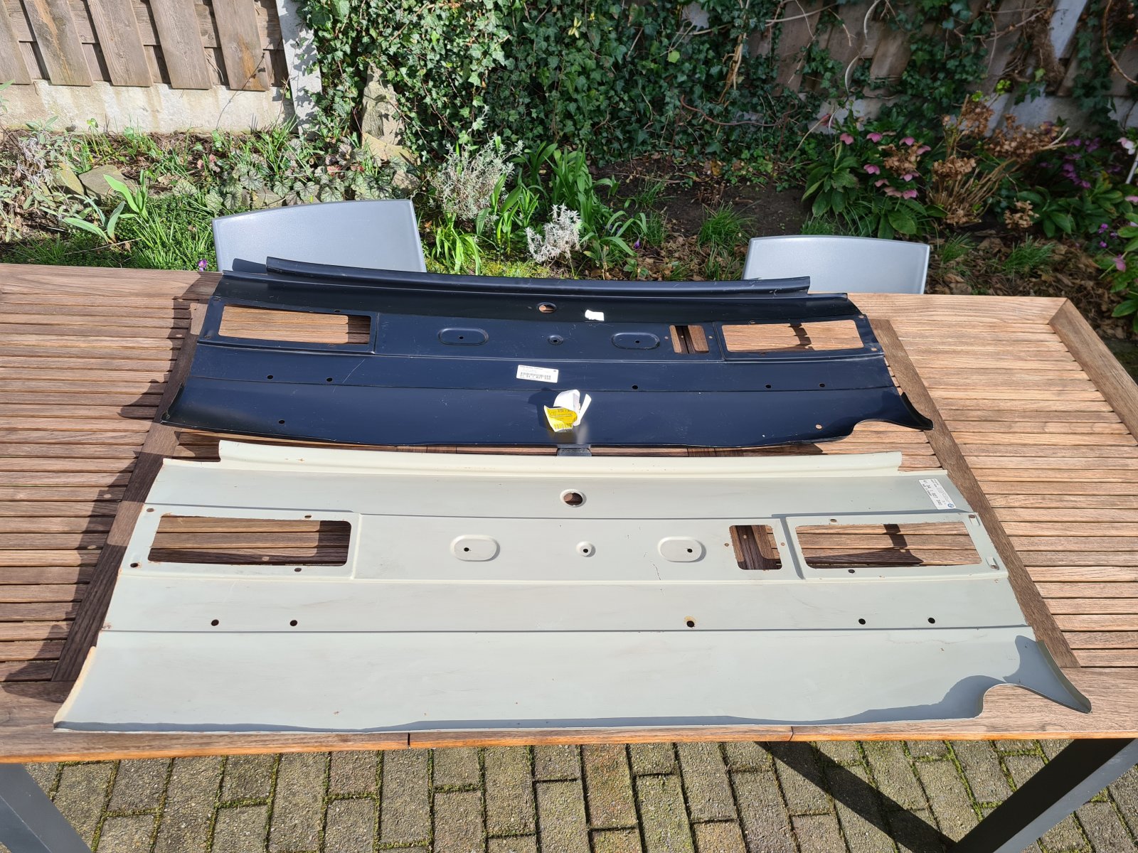

The rear tail panel (valance?) was also made as a thin guage (still have such a CSL specific one for sale!). I'm guessing here; was that used from the begin of CSL production start?
The yellow comment in your list "were the holes for bumper bracket filled in?" is a negative: the CSL specific thin guage rear panel has no holes for the bumper brackets (If you mean the the vertical chrome pieces with rubber blocks on them under the bumper)
Grey is CSL - black is std e9 part

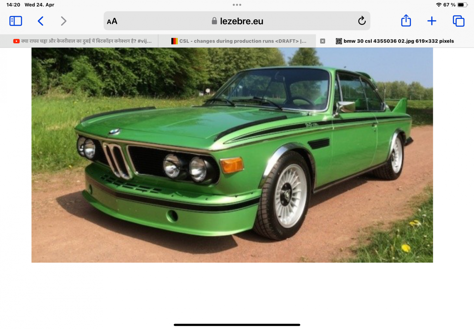

All the CSLs had the trapezoidal mirrors up to and including the last series Bat2 chassis 4355036.
Gerrit
this may be an interesting addition:
Gerrit
In the current sale pics of 4355036, it’s sporting a flag mirror!
yes it does, but did it have one originally ... that is the real question. 036 has been restored. early pics i have seen of 002 had a flag. 016, 022 and 033 have traps. but i didn't see them in 1974 ... and i trust Gerrit - much more experience in this matter than what i see in pics. if i was restoring a Bat 2 right now and i had a choice, install a BMW flag mirror or a new repro trap mirror, i think i would go with the actual BMW part. but i would think the correct thing to do would be to find an original trap mirror and refinish it.
this car raises good questions
- plastic coolant reservoir or metal reservoir? we know the regular 74 CS / CSi had plastic ... i have heard that it should be metal
- flag vs. trap mirrors?
- black screws on the air dam or silver screws?
- has the black fiberglass rear bumper and the black rear valance - very curious if that was correct for a basically city pack car. i know 033 has a black rear valance, but it is primarily a lightweight from birth. i have read that 2275 cars that were city pack cars had body color rear valances - curious if this was a distinction?
- seems odd to have 16" Alpina wheels on a Bat
- a/c ... obviously an option ... very curious if it was factory or installed afterwards
- very curious about the black stripes on the Bat2 ... looks better with Taiga than the 3 color would look like on this car ... just curious if they were born that way
- no stripes on the rear wing ... the 3 color stripes were also on the wing, but this car doesn't ... which is correct?
- should the 'plugs' on the rear wing (where the pieces bolt together) ... should they be black or body color?
(4355042 (unrestored) and PG’s Bats both have brass cans……so I’ll go with that.
Primarily Traps, last few cars with optional electric mirrors and Flags
Silver screws
City pacs without and Bats with, which car is which is upto the beholder and requires a deeper look.
Important to mark that the differences between city pack and lightweight cars fluctuates quite some. (This car has the Bat kit, hood pins, no power steering, fixed rear glass…all lightweight features but therefore a AC to make up for the weight savings
Should be 14”
Looks like a factory extra option
black stripes standard and Motorsport stripes optional for the 4355 L’s
Should have the stripes on the big wing
Correction….Clear plugs on the 4 bolts affixing the side fins to the central flap.
