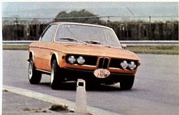

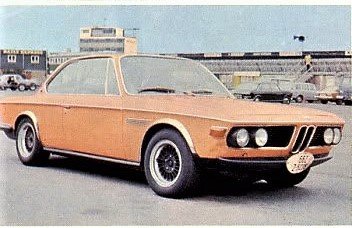

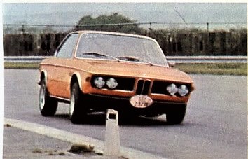

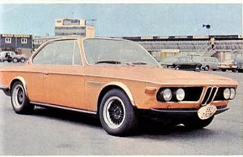

Pics of early (1971) CSL press car(prototype?) Think 'prototype', note Alpina wheels and is that a roll bar diagonal I see? HTH and good luck with your project.

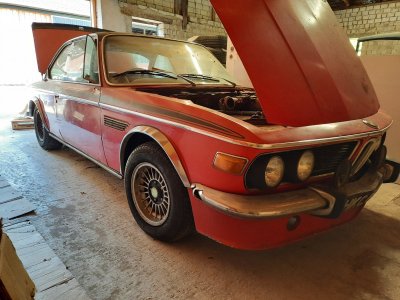

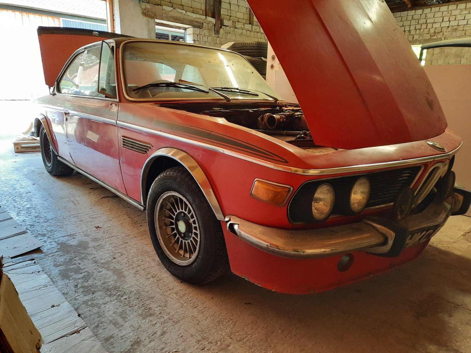

One of the 500 RHDs.
Left the factory in "fjord-blue" but received "verona" with vinyl roof afterwards

That would be 2211347......came to England with the Broadspeed car....

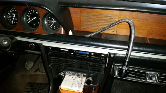

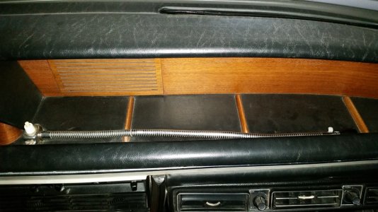

I'm available, can you help me with my totally original CSL carburetor.
My car has never been repainted, except in three parts, I confirm the absence of side stripes and only CS is indicated on the rear bonnet despite it being a CSL. I am doubly sure of this, because some time ago I found and purchased a light alloy rear hood coming from a CSL carburettor destroyed in an accident in 1975, with the CS logo. this too without stripes. The rear windows are fixed, not glass but are plexiglass. No power steering or electric windows. It has pins on the hood. There is no type of internal closure of the bonnet. There is no passage for the cable, nor any internal handle to pull the bowden cable to open the bonnet, it has a Glaverbel brand front windshield, notoriously lighter, because less often, the same concept and brand used by the Porsche 911 2.7 RS, with which shares, in addition to the brand and type of windshield, the synthetic leather and the central fabric of the Scheel seats, has a resin rear bumper, while the front bumper is completely missing, has no stabilizer bars, neither front nor rear, curious note, below the rear backrest, dismantled for detailed cleaning, has a number written on the top right with a color that looks like wax, like the one children use to colour, in my case 070, which is the code for the color golf yellow, the rims are Alpina 14, and have no holes next to the fixing nuts with the central part of the hub painted in matt black, on the dashboard, in front of the passenger there is a flexible map reading lamp, with a button switch at the base white ignition. the steering wheel is a 38 Alpina built by Momo for Alpina, like a Momo Prorotipo. At the moment I can't think of anything else, but if anyone has any questions I'm available. I hope that the translation is faithful to what I write in Italian. I decided to sell my CSL, it has been with me for 15 years, only one owner before me, if anyone is really interested they can contact me, I warn you it is not cheap, but unique in terms of originality, almost entirely first paint, never restored. A unique piece

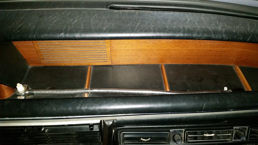

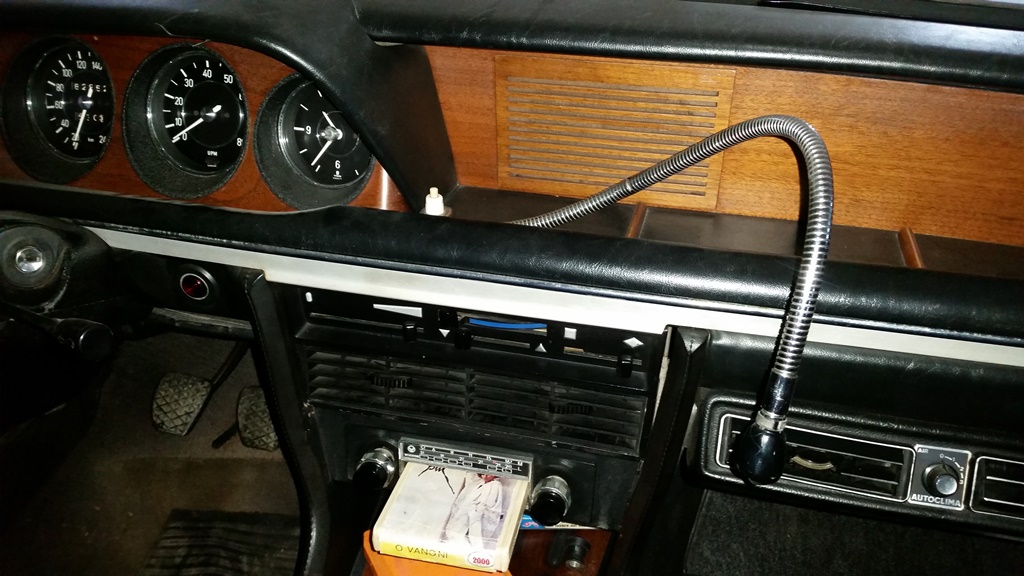

hello Mario, thank you very much for the helpful information and confirmation. can you tell me the VIN so i have context for the flexible light on the dash. out of curiosity, i am curious if there is any indication that the light may have been installed in the glove box originally.
can you send me a couple of pics of the flexible light on the dash and pics of the left side of the glovebox. it would also be helpful to see a pic of the underside of the dash - below the location of the light.
Ciao,
scott
Hi Scott,
I am attaching a photo of the map read lamp, I have heard of the location of the map read lamp in the glove drawer, but never seen it, while I have seen the same location as my lamp on other CSLs. the Vin of mine is 2212442. another piece of information that comes to mind, again to save on weight, the battery of the CSL was 36AH while that of the CS or Csi was 55AH

hi Mario,
thanks for the VIN and the pics. i knew about the smaller battery on the carb CSL and already have that in my notes. i do have a follow up question for you - it appears that you have a different form of air conditioning above your glovebox - i wonder if that installation caused the movement of the light from the glovebox to the dash ... or if it was always mounted on the dash.

Hi Scott
I actually have a different type of air conditioning mounted above the glove compartment, it is an after market model, installed in Italy by the first owner, by the dealer who sold the new car, in Sicily the climate is hot, like in Florida or California. Indeed, that installation could have caused the light to move from the glove compartment to the dashboard, although I have always known the car, I don't know if it has always been like this when mounted on the dashboard, I haven't seen the car before having fitted air conditioning. But I think I've seen several cars with lamps mounted in the same position. so it seems difficult to me. My thesis is further supported by the fact that to mount this type of air conditioning, it was not necessary to dismantle the dashboard, which was necessary to move the lamp.
