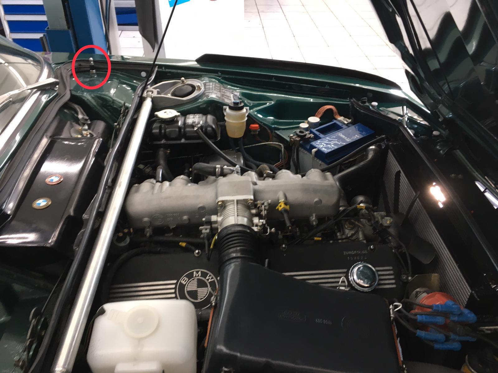

Custom hood prop and hood pins?
Yes, Chris. Odd hood prop and pins, yet it also has an internal release setup with latches. Ain't no way that hood is popping open accidentally.

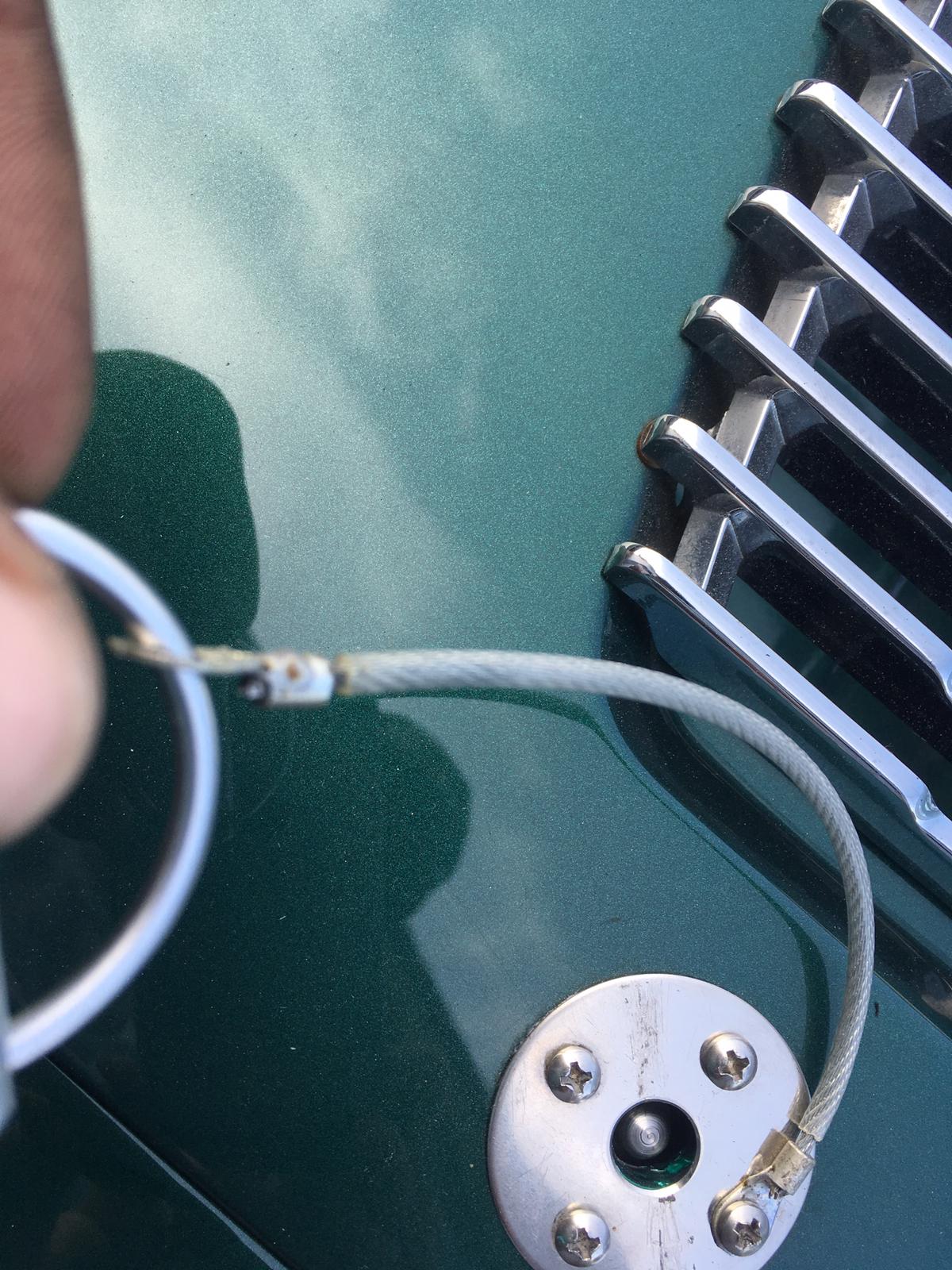

Hood prop is wrong but the hood pins look right to me (looks like it has a Blue cellophane layer under which it is chrome as it should be). For one, they should be sunk in way lower so that the ring sits flat on the metal plate when closed, the safety wire should have a translucent plastic tube covering it and the pin should have a black hard rubber tube below the trunklid so as to not let the lid vibrate too much (when used without the standard hood locking system).
