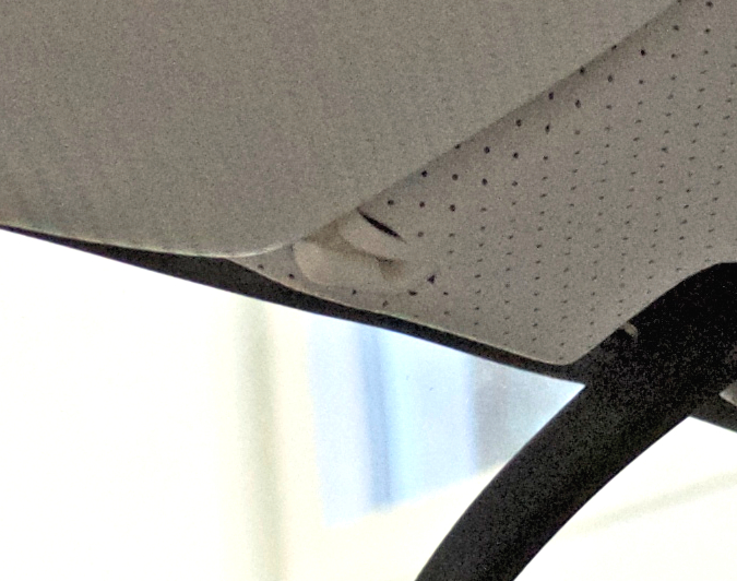

Just after I wrote that, I got to thinking.. Are CSL clips really the same as in the CS/CSi?
Here is a picture of my clip that I got from CN:
And I realized there might be a difference after looking at the Coupeguys site, who actually lists CSL black clips for $21 each or $39 per pair:
