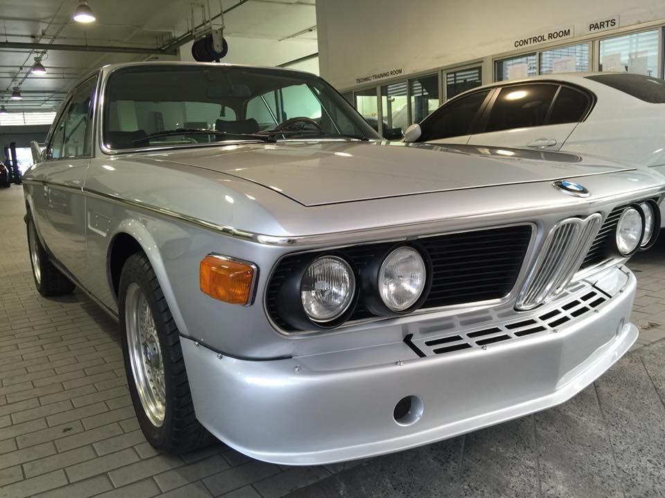

Talking about this one:
Is it bolted on with a nut on the inside of the valance?
What bolts are they using?

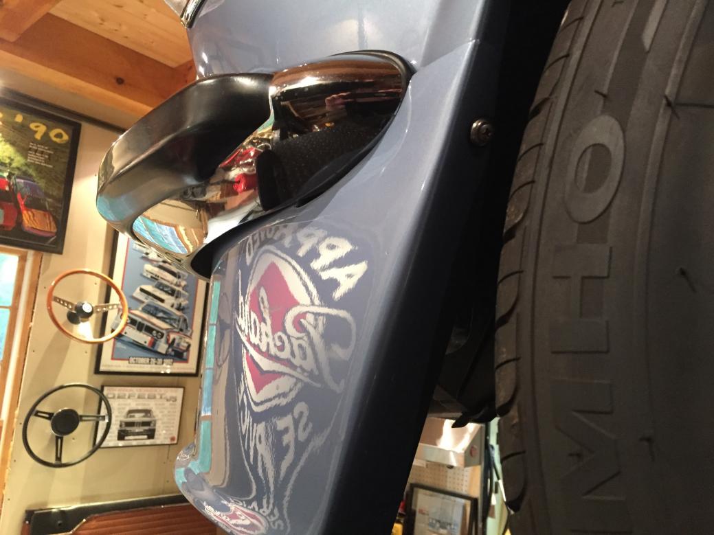

I have the VSR CSL air dam and run the bumper. The bumper has to be scribed and the air dam cut so the ends of the bumper will fit. The center carrier brackets use carriage bolts that are slotted into the sub frame.
