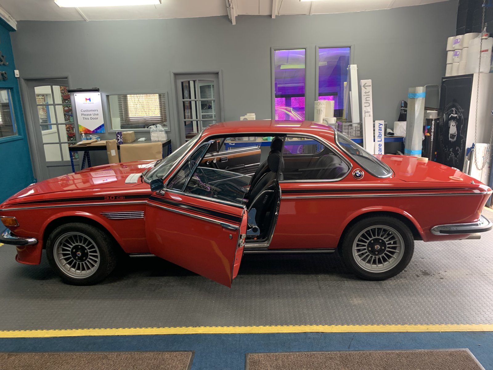

Hi all I’m in the UK. Looking to purchase a CSL style duck tail spoiler ? Anyone ?

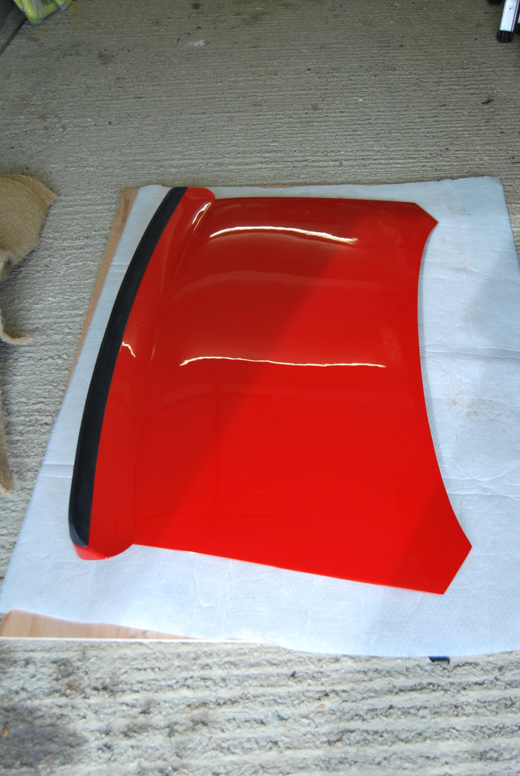

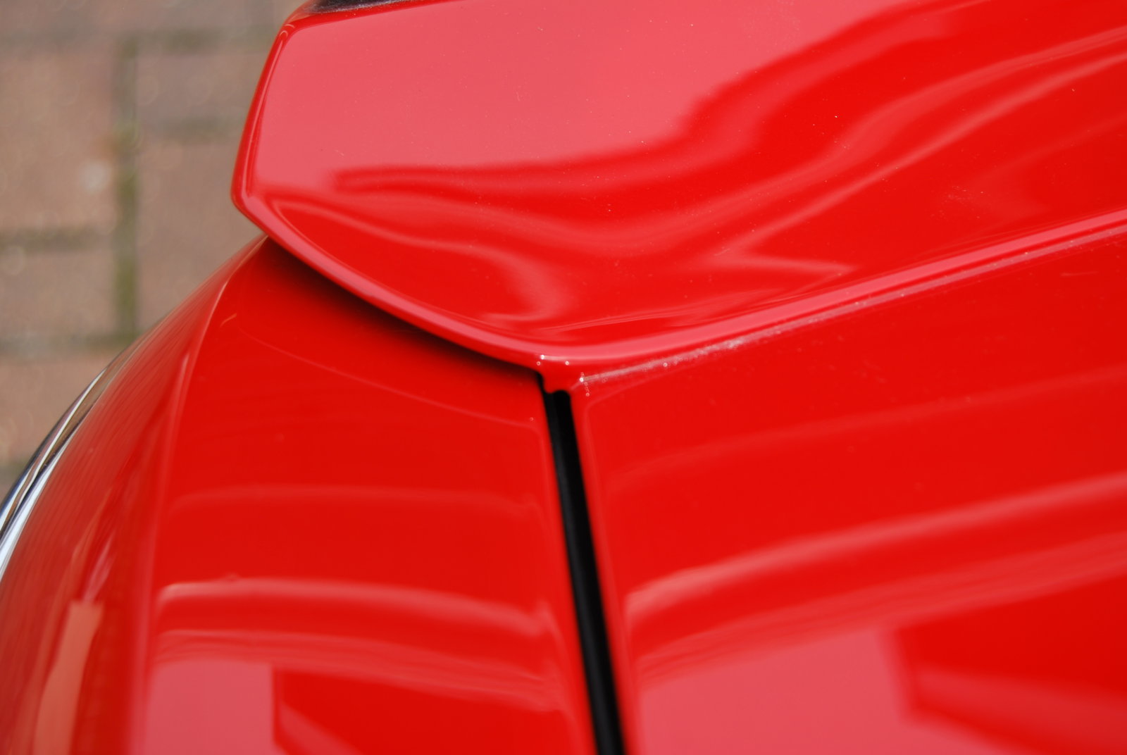

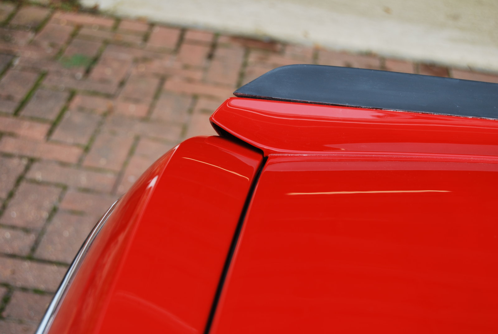

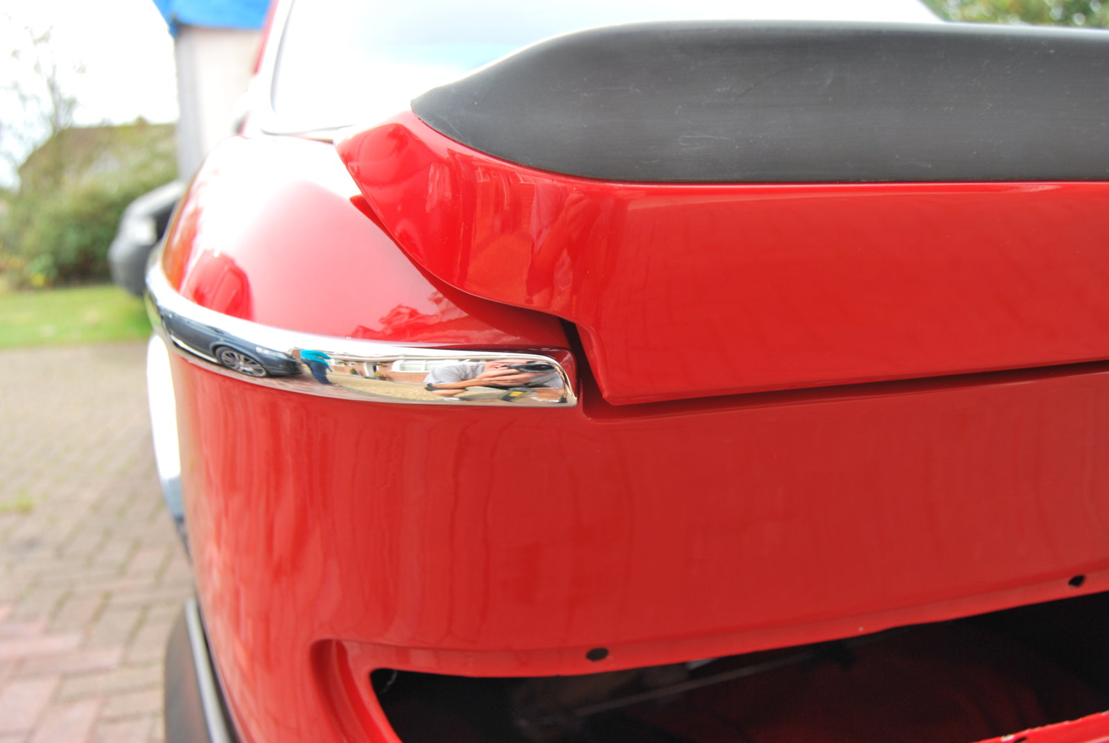

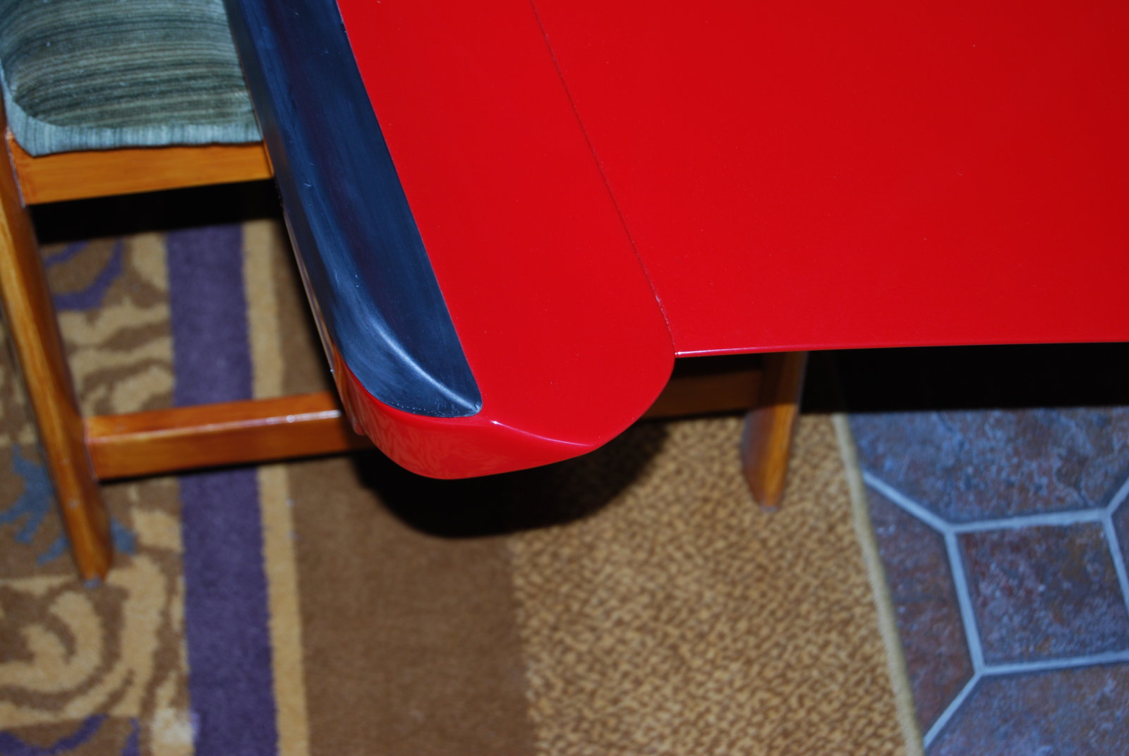

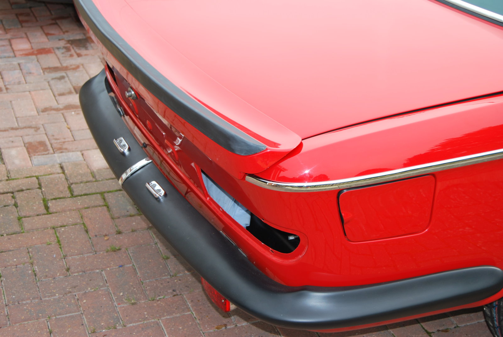

Hi Martin, no problem with the spoiler but the painting has to be done by a paintshop when fitted to the car, they will need to bond it and possibly screw it on once they have lined it all up.. when thats done the boot lid will need to be painted at the same time for a perfect fit and finish. it needs to be trial fitted correctly before you fit the rubber edge then fit finally
you could paint it first and fix it after as they did when new but you will still need to bond and screw it down which i think is not so satisfying. plus you will see fixings
this is my boot lid once fitted and painted and I think this is how it should be
are you ok with this?

Gorgeous outcome Dear Mark
Really look stunning and in red is a mind blowing!!!
Is the rubber needs to be bond it or you have to use screws

Hi Alejandro, flyer with prices attached in £ Sterling. The rubber edge has bolts set in the rubber so it will bolt to the fibreglass part but you can bond too if required. ship a single unit to the USA is around £65.00

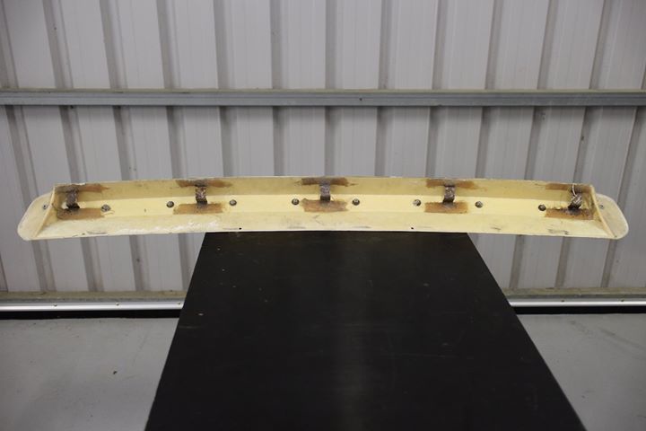

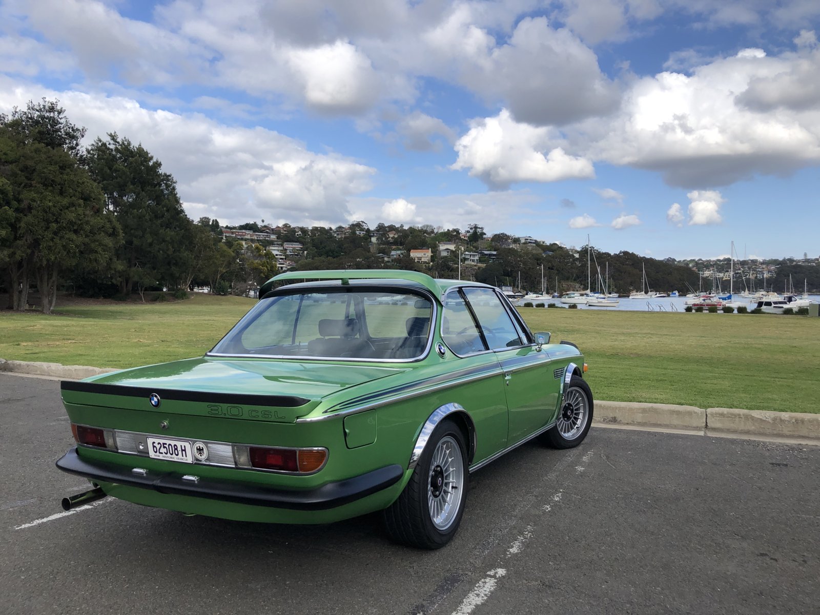

For those suggesting screwing on the spoilers, it's really not necessary. There are extremely good auto adhesives these days (Eg Sikaflex) so unless it is a track car, I think glue and double sided tape is sufficient. Mine is super secure without screws (which I wouldn't want to put through my alloy boot-lid anyway). Mine is an original CSL fibreglass spoiler so is very light... I assume the Daddywad ones are also light enough to just stick on.
Great stuff. Exactly what I thought. Can you remember the exact products you used ?
The spoilers have long front edge so industrial quality 3M double sided tape goes all along that and along the side and bottom edge.
And a dab of Sikaflex auto trim adhesive on each of the 5 metal brackets where they touch the boot-lid
(This is what the underside of my CSL spoiler looked like)
