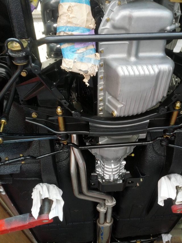

At that time the engine and trans were totally rebuilt, the mileage on the ODO was 35,000.
The underside was scraped and sanded to bare metal, Sikkens Primer was applied, then Wurth undercoat re- applied.
Most of the bolt-on parts that could be powder-coated , were.
Calipers, and assorted suspension pieces were rebuilt.

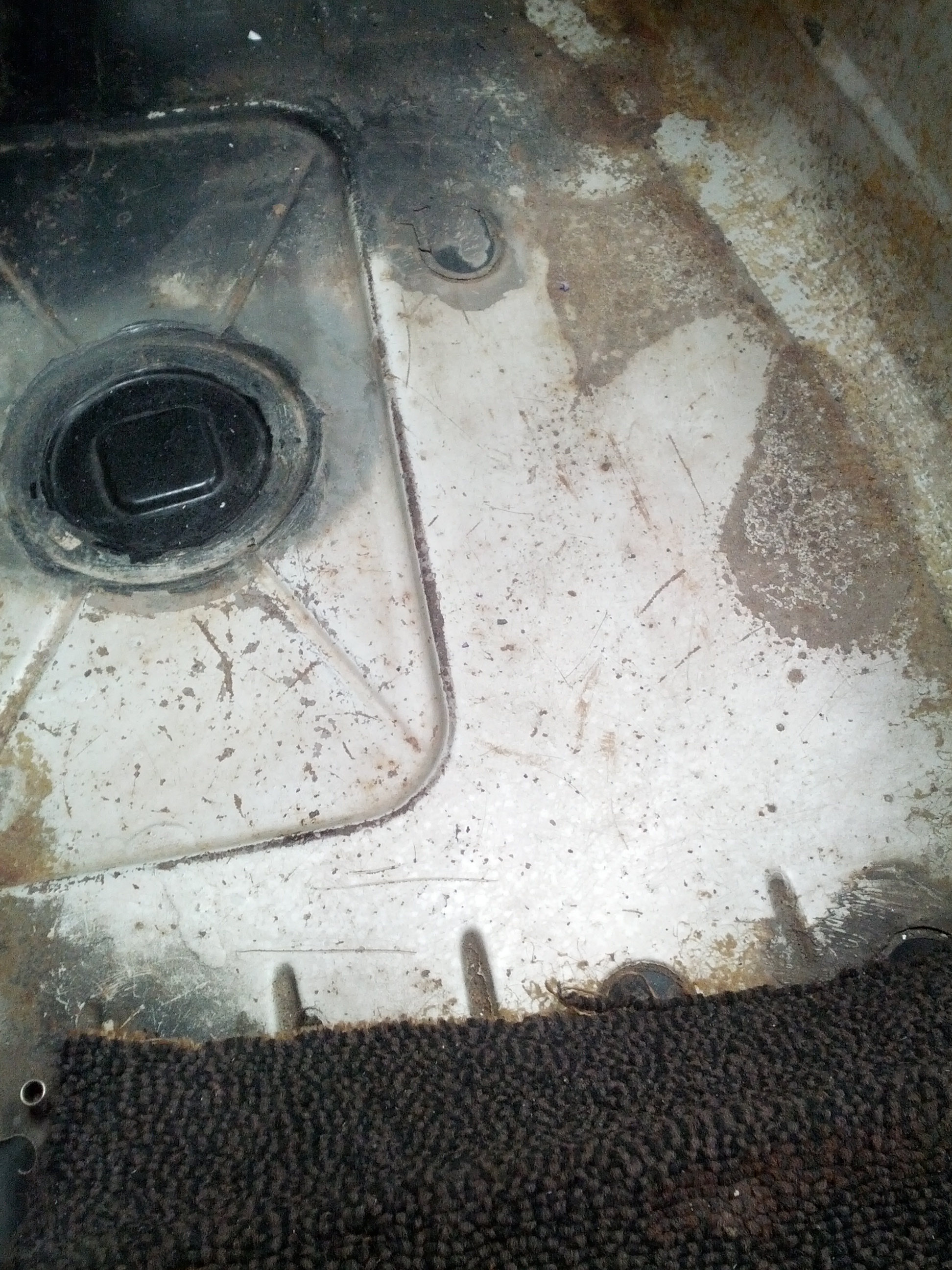

When stored in the container there was a drip, not heavy, but still drops did land on the roof under heavy rain, as a result there were 'HUMIDITY BLISTERS' over parts of the body, the wood had dried out , and had to be restored, but that was about the extent of the poor storage.

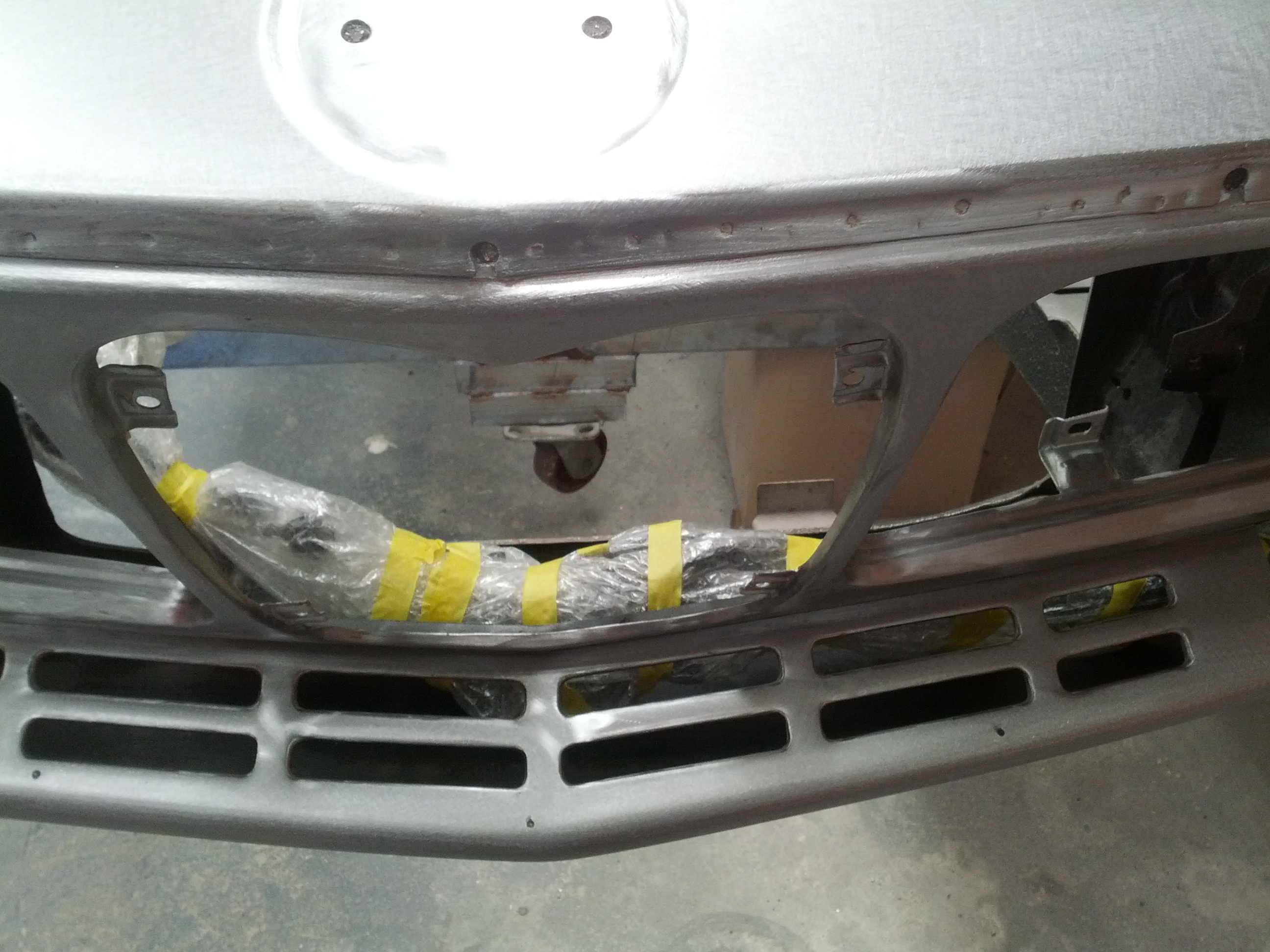

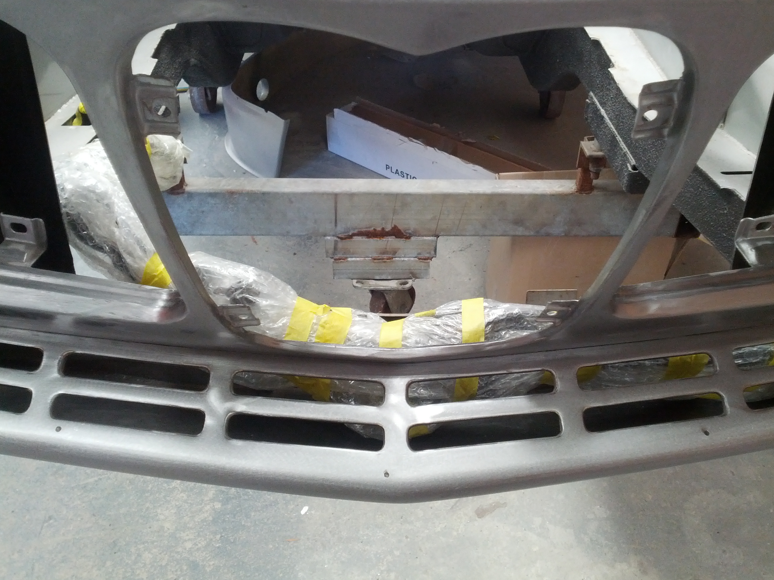

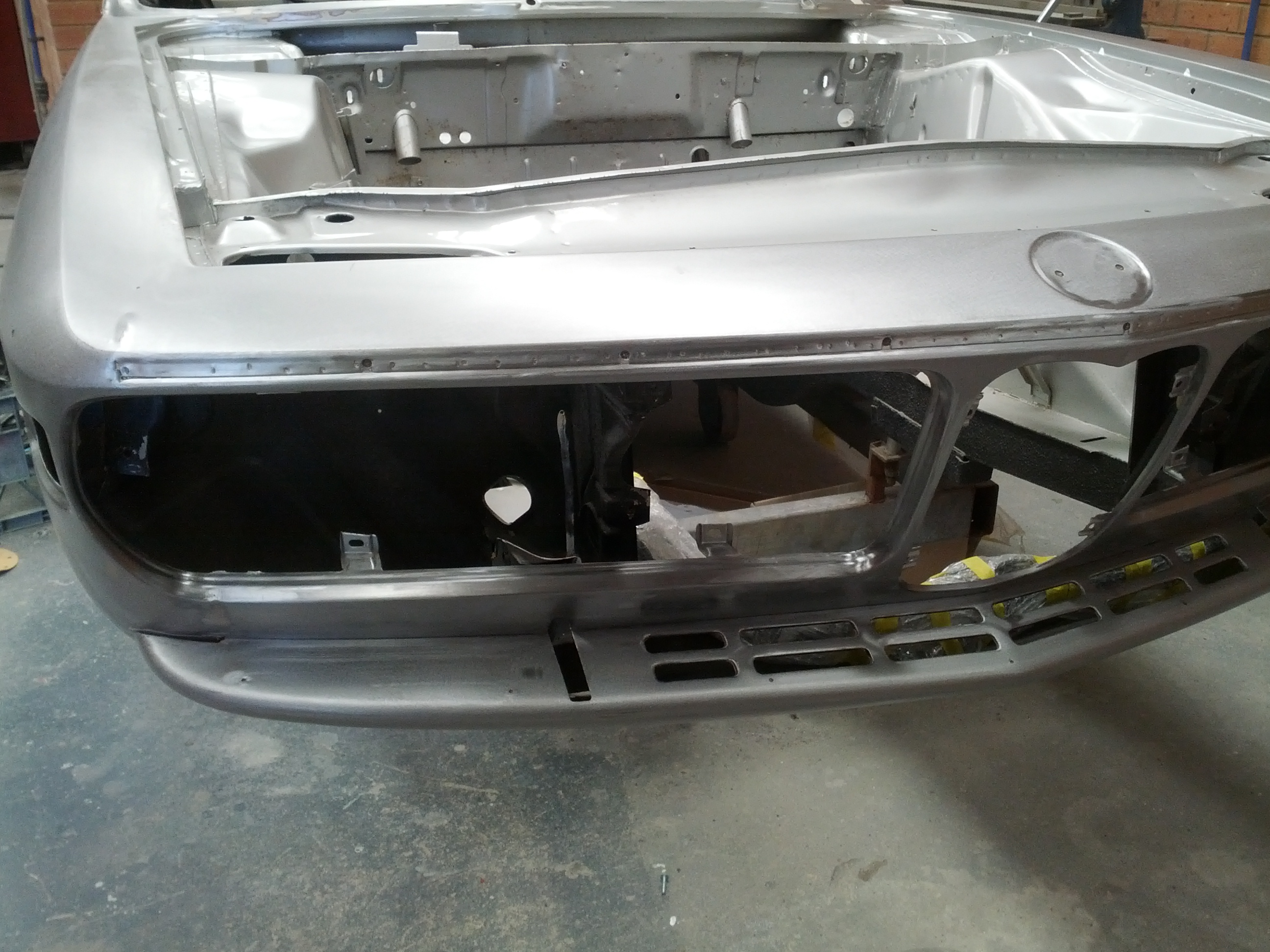

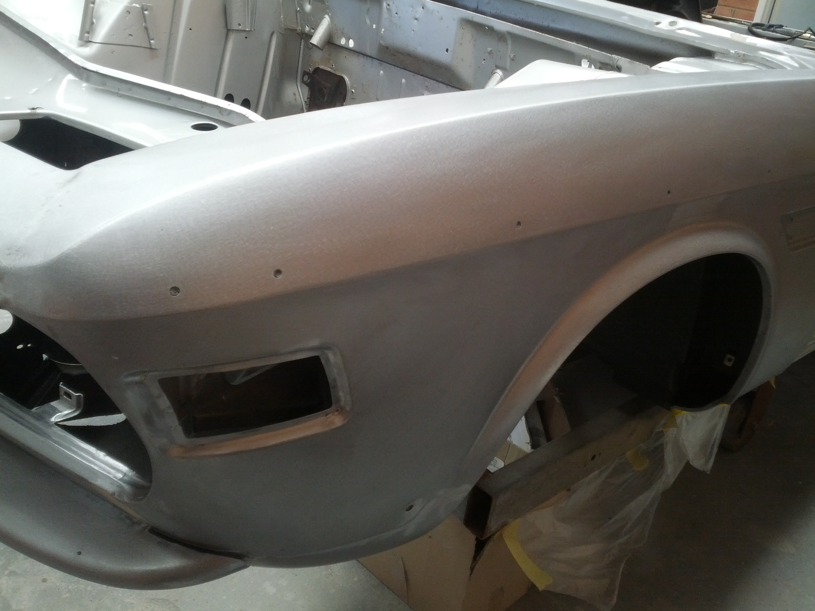

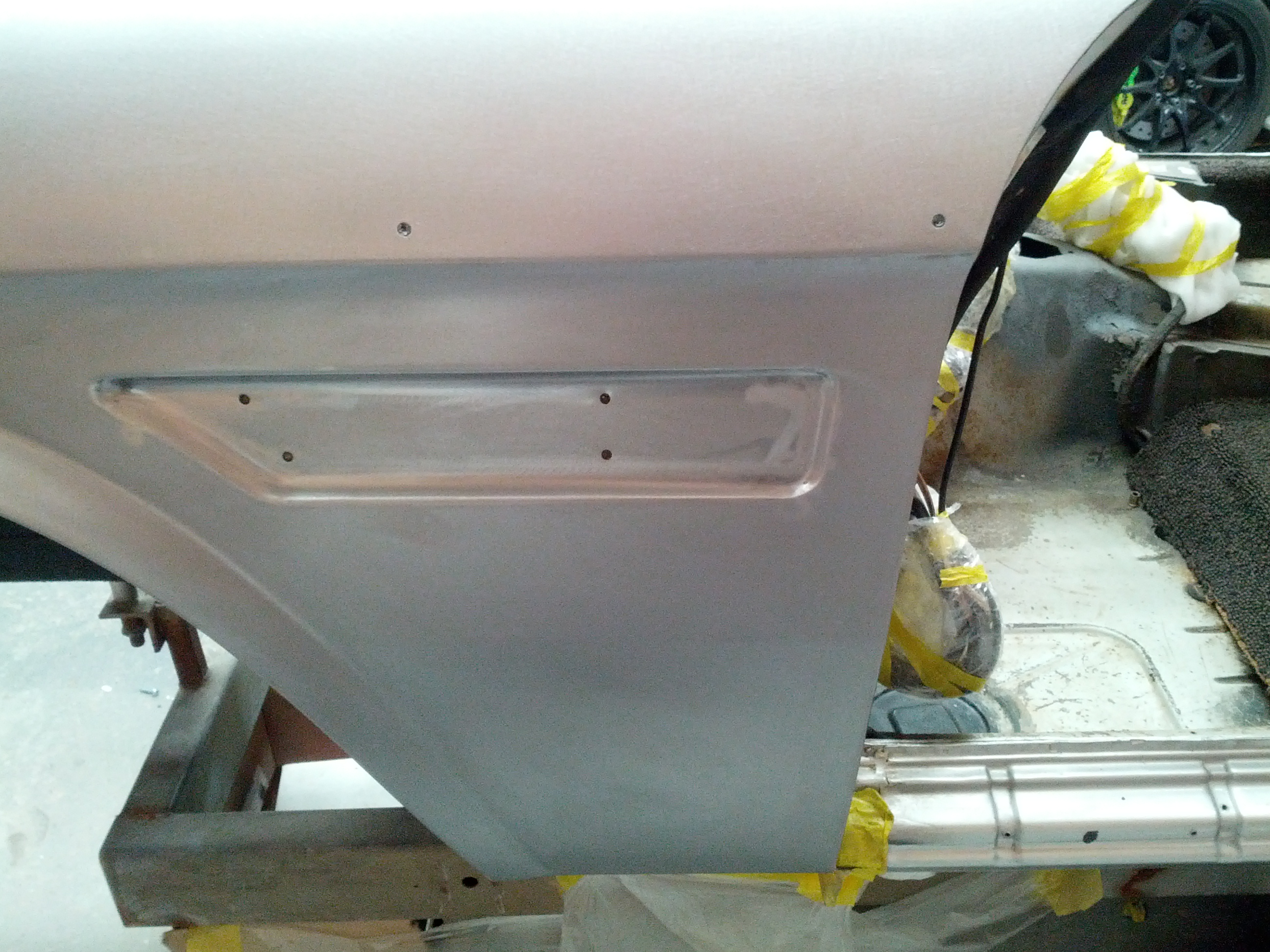

I stripped the body back to bare metal and was very pleased with what was , or was not underneath.

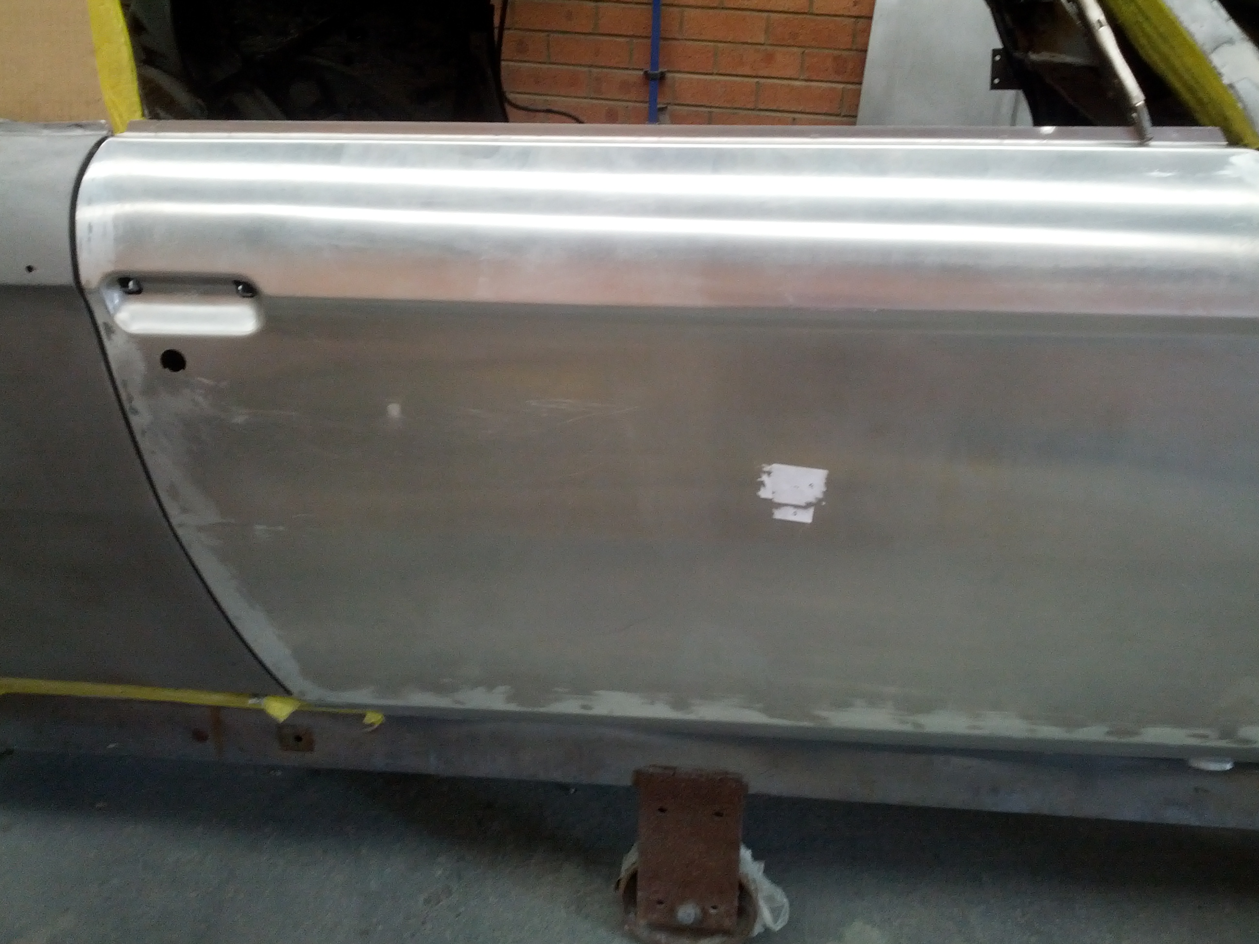

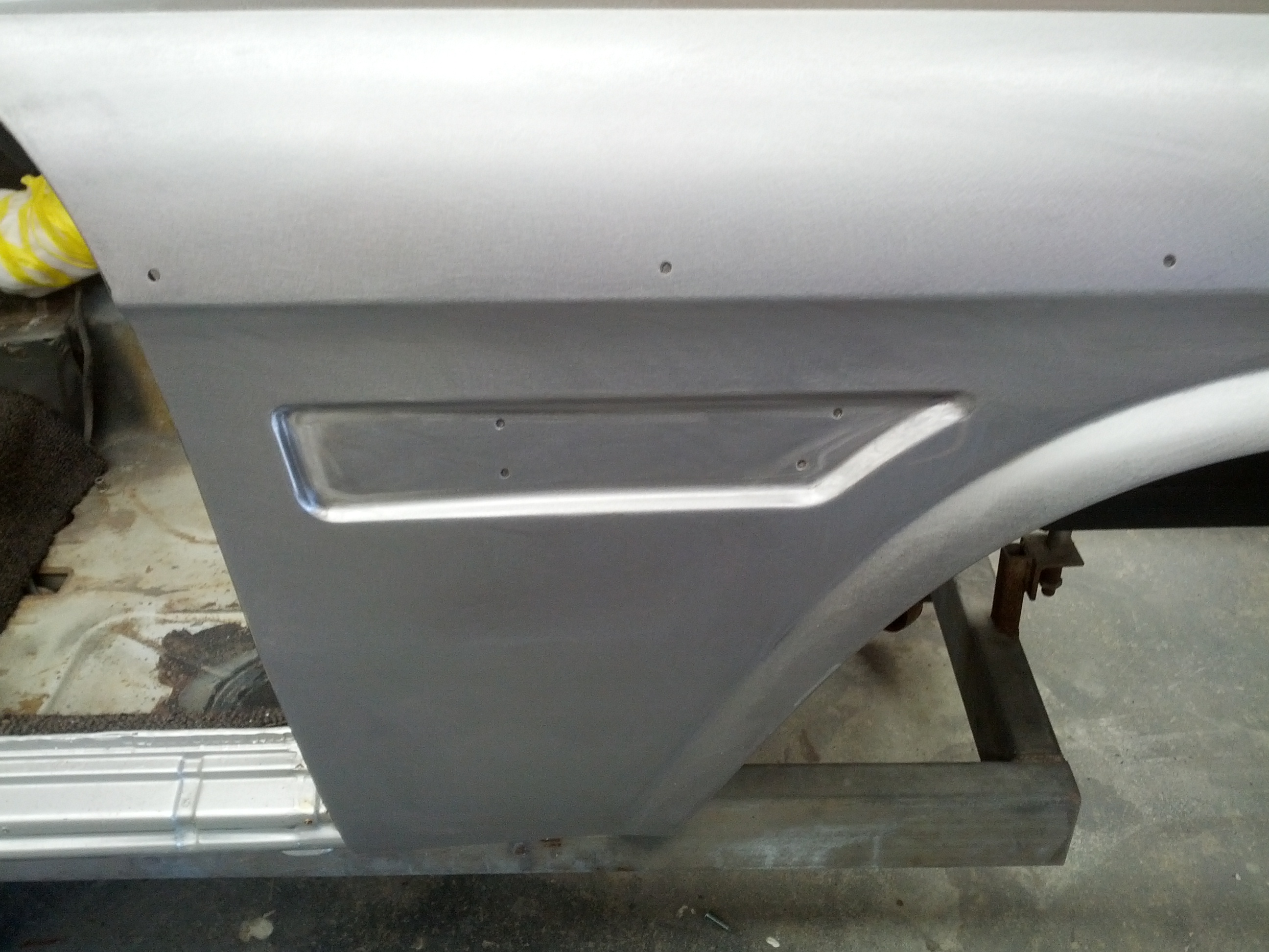

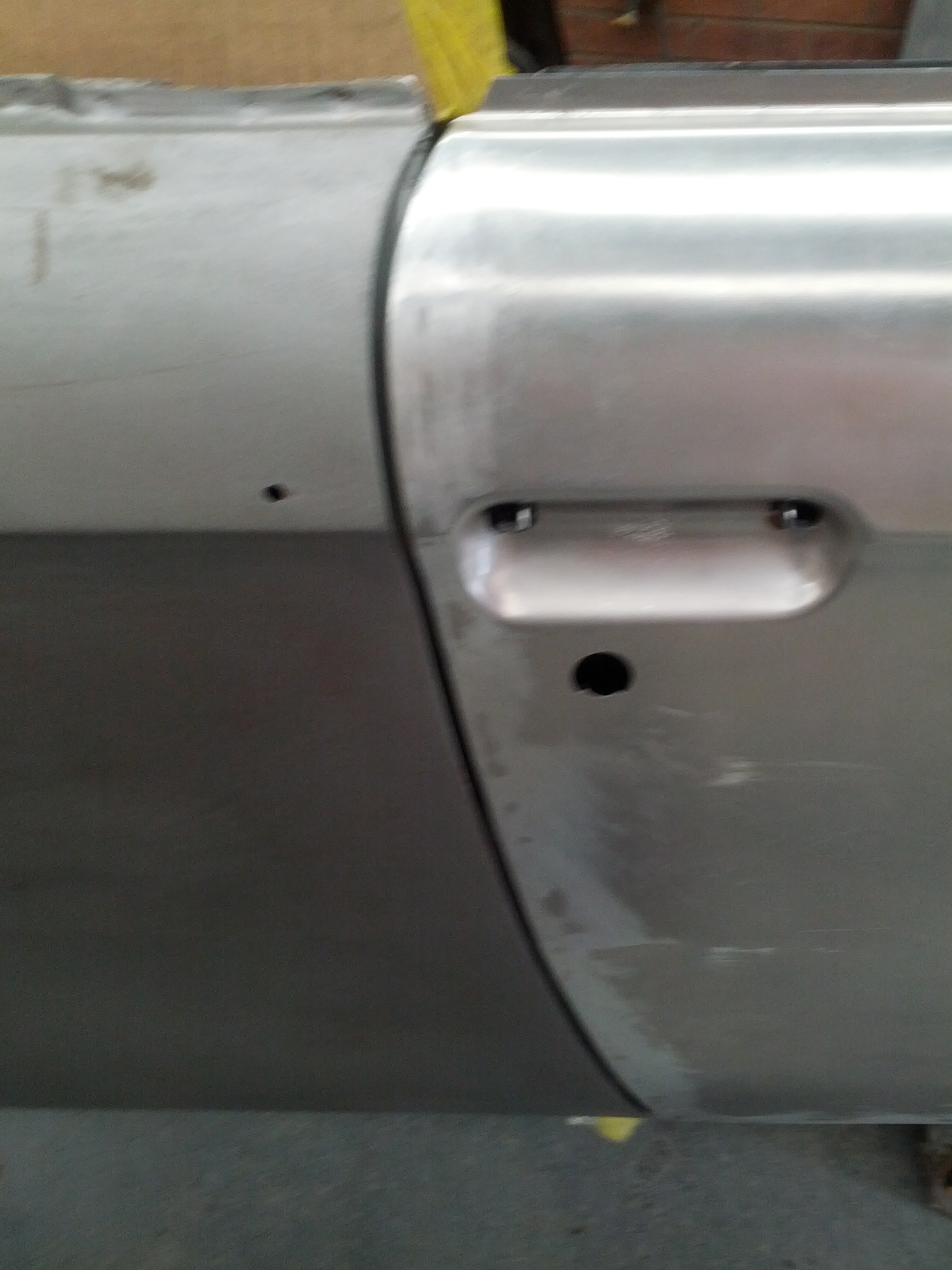

The body shell was beautiful, ZERO , YES ZERO RUST, a couple of bubbles in the left door, so I fitted new W+N alloy door skins L+R , there was a slight scrape on the Left quarter, and a small dent in the Right, otherwise nothing, I have applied epoxy etch primer, and shall begin the paint process.
