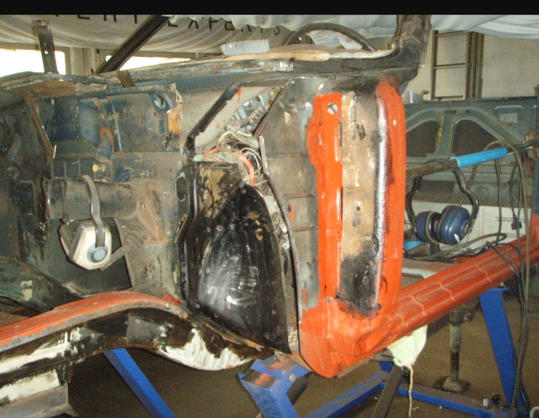

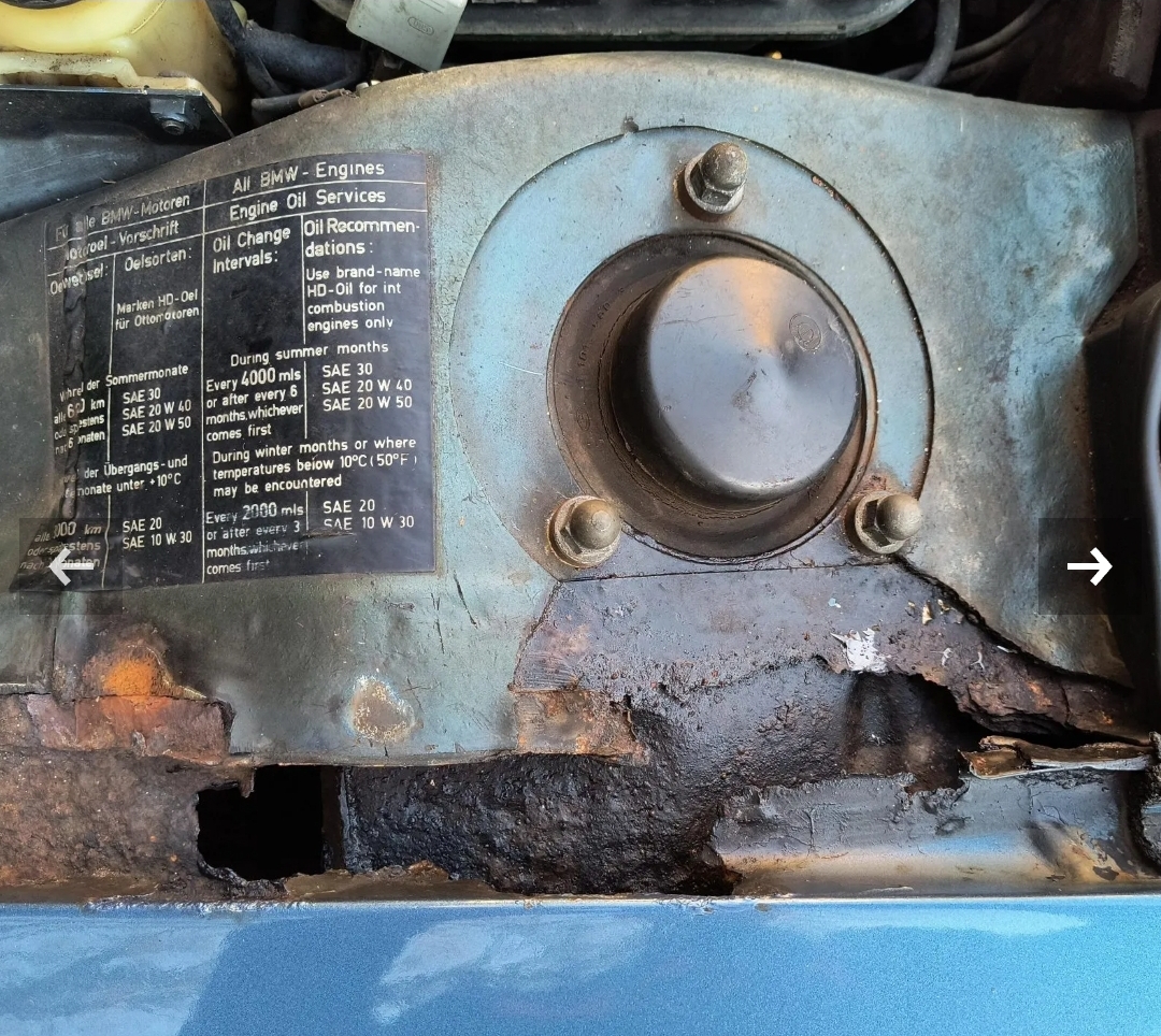

With a body this far gone, it's many hours getting just the metal ok.
Such rust
Can only be solved by doing this:
My guess at least 400 hours by a pro body shop. 1000 hours for someone doing it himself.
2000 hours by me (first resto)
